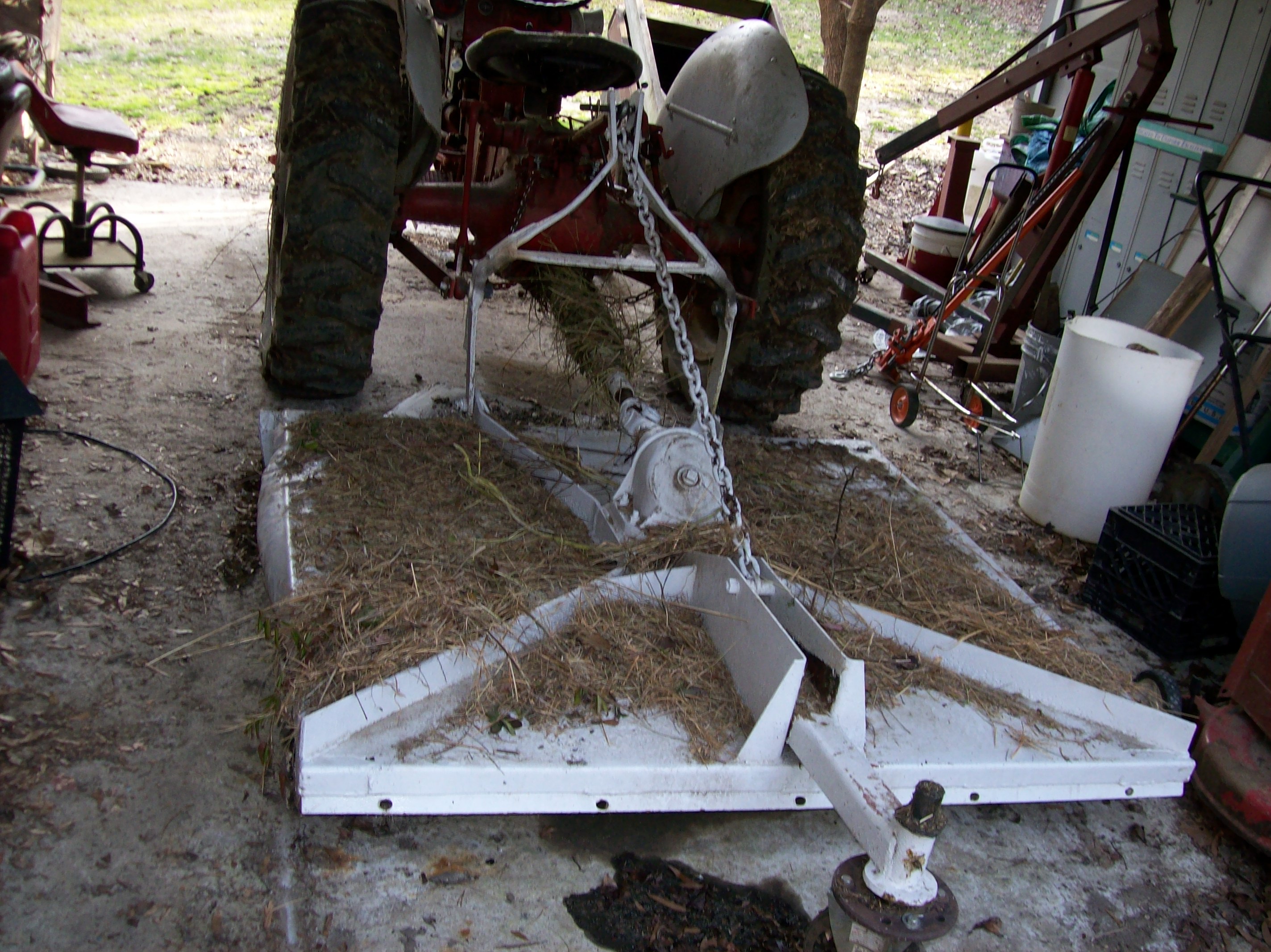

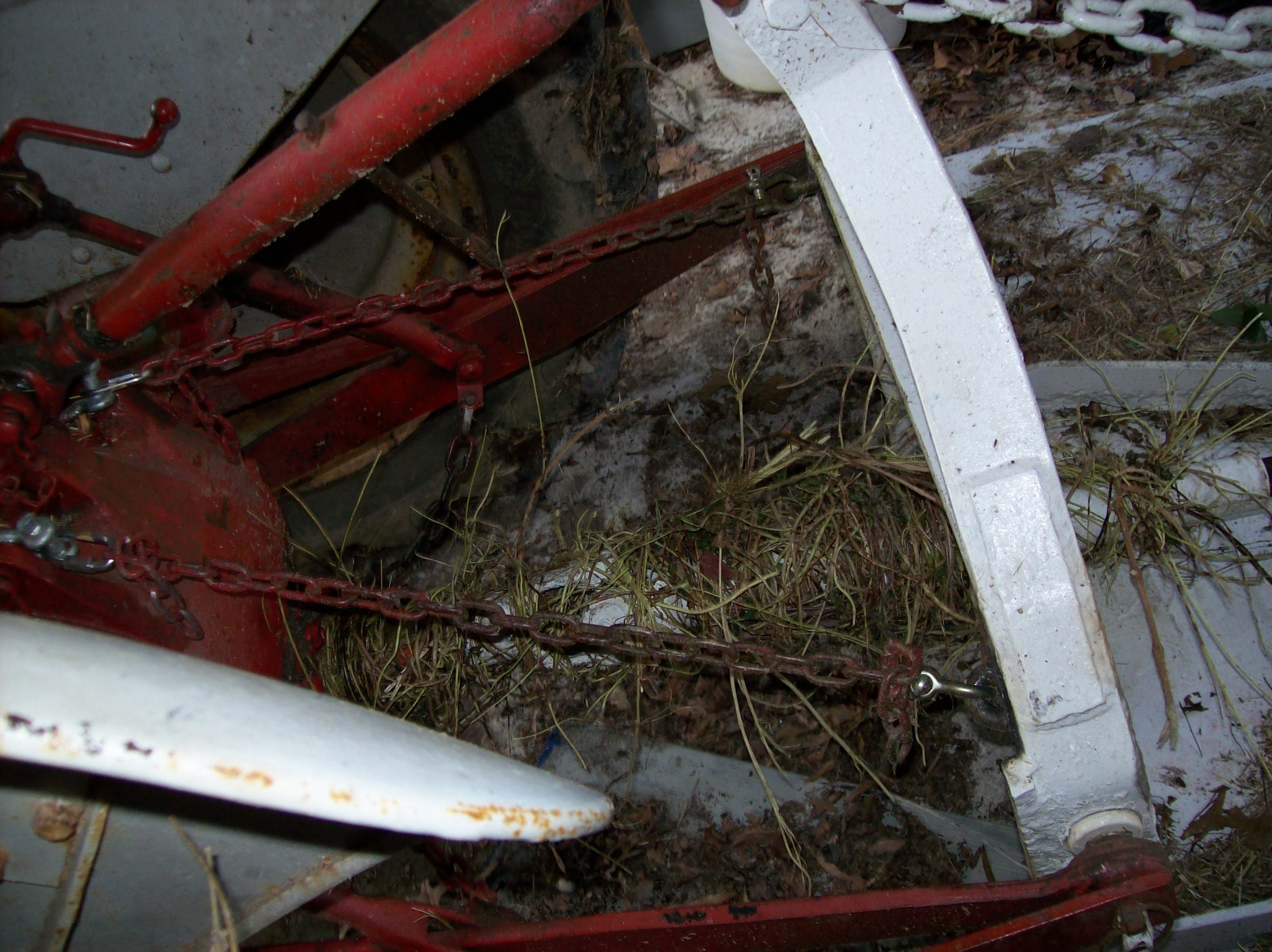

Buddy of mine gave me an old rotary cutter. I have it on my 8n now but want to put chain limiters on it so it doesn稚 sag and plow into the dirt and driveway. What痴 the best way to hook it up? What locations on the tractor and brush hog? I致e seen pics online all different ways. Also is there a kit to install so the 3 Point will work without PTO spinning?

   / 8n Brush Hog #6
3-16-2013_limiter chains.JPG This is the way I had my 49 8N attached to my 5' Bushhog before I sold them. 3-16-2013_Bush Hog project complete.JPG

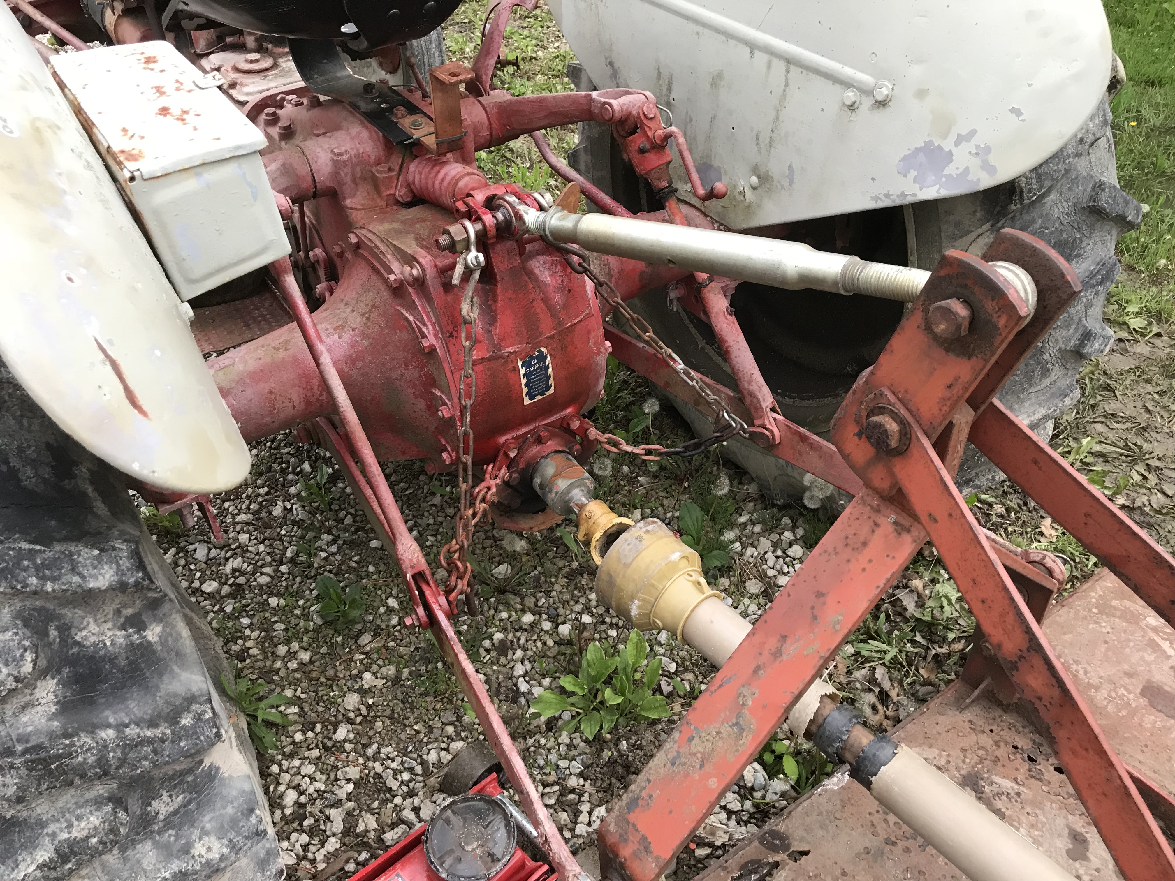

   / 8n Brush Hog
Ok I hooked it up similar to MitchelB and it’s working great. I just need to find a new rear rim for this machine and I’ll be all set.
