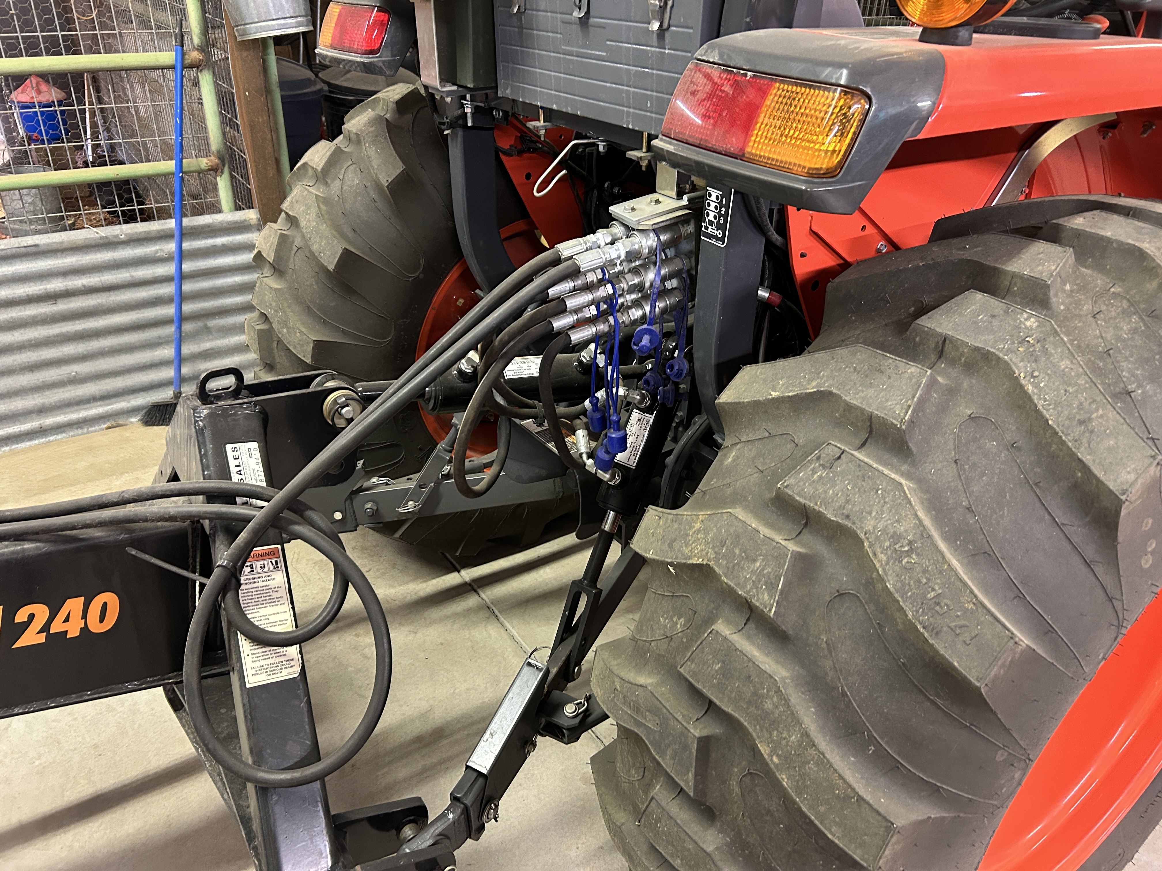

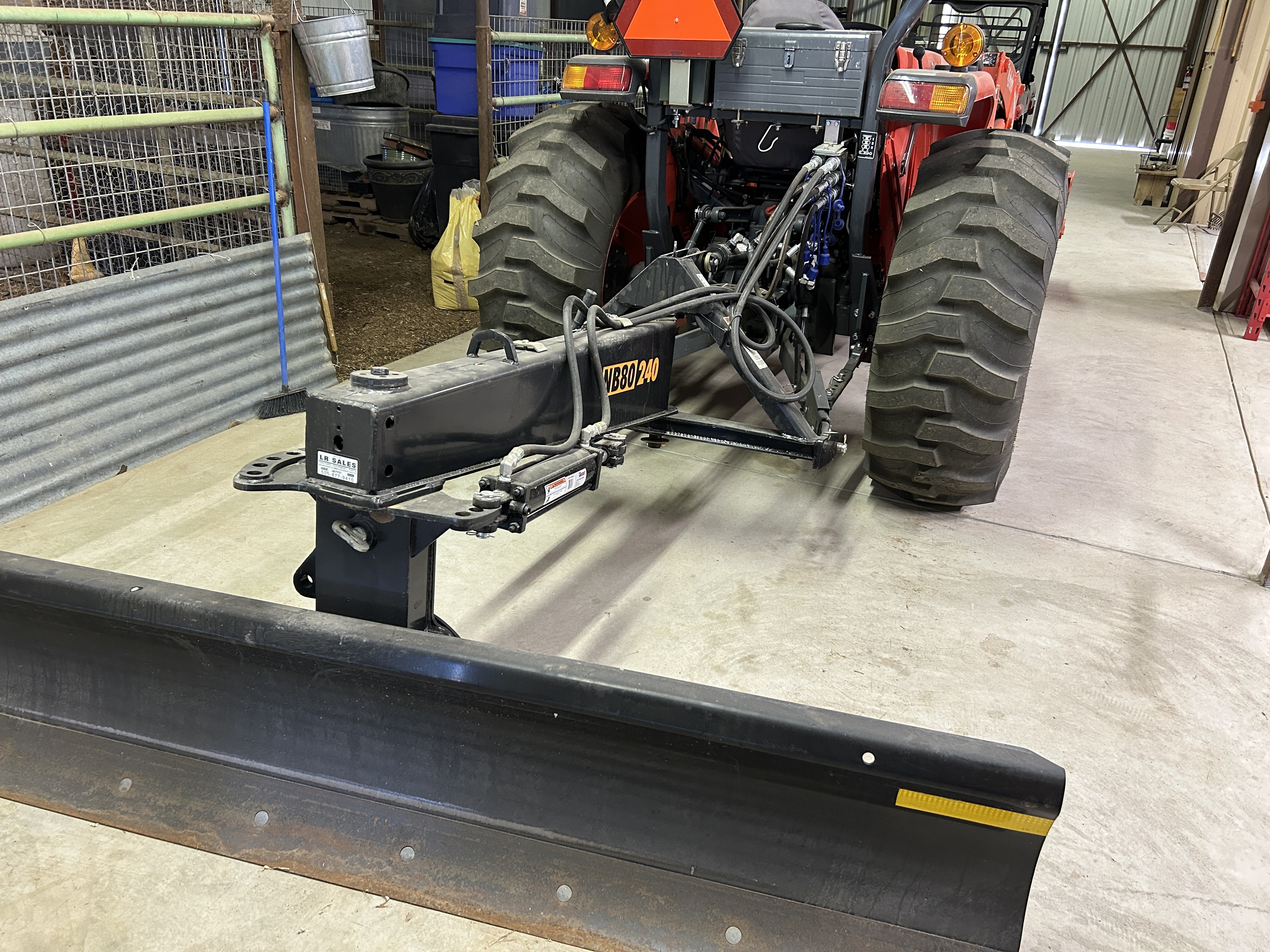

I've just added a hydraulic angle adjust to my blade along with a hydro top link (it already has hydro tilt and offset), but I can't use it until my rear remote expansion kit arrives.
Maybe that much adjustment at my finger tips will speed things along a bit. However, we haven't had any usable rain since April, so I can't touch any of my non-gravel roads without turning them into a sandy mess. Frustrating, but I shouldn't complain as some people are dealing with a lot worse with the fires out here in Western Colorado. Droughts & the accompanying fires are the worst!

I think that you’re going to be real happy with your blade once you get the hydraulics dialed in. I did that to mine last year. I’m surprised that you are not that far from where I live in Santa Fe County, but haven’t had rain since April. We had an extremely wet May/June and below average July/August, but still some pretty nice rain during those months.
This is my blade setup:
