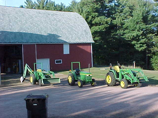

I have two 870's very solid and tuff. I have a 440 loader on one. Use it to skid logs andpulp. I am amazed at what I can pull. I have not had a bit of trouble. Starts right up even at
10 below.
