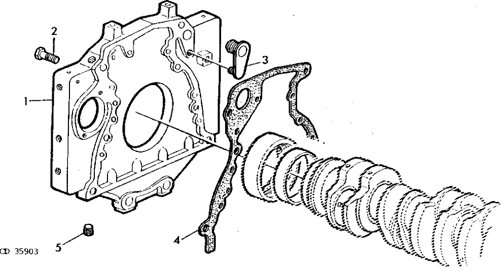

Wow $1700 repair on inj pump is a lot. Plug(parts key 3) covers holes for using engine turning tool and timing pin. Engine should be placed on #1 TDC. Besides checking timing I'd suggest to check compression as top rings are easy to break with ether on JD 300 series engines such as your tractor.

Set my timing to tdc. The timing mark that is visible is B4, but it is in the middle of the snap ring. Also removed the window by the radiator to see the position of the keyway and it is at 8 O'Clock from the front of the tractor looking back. What are the correct position's? Thanks
