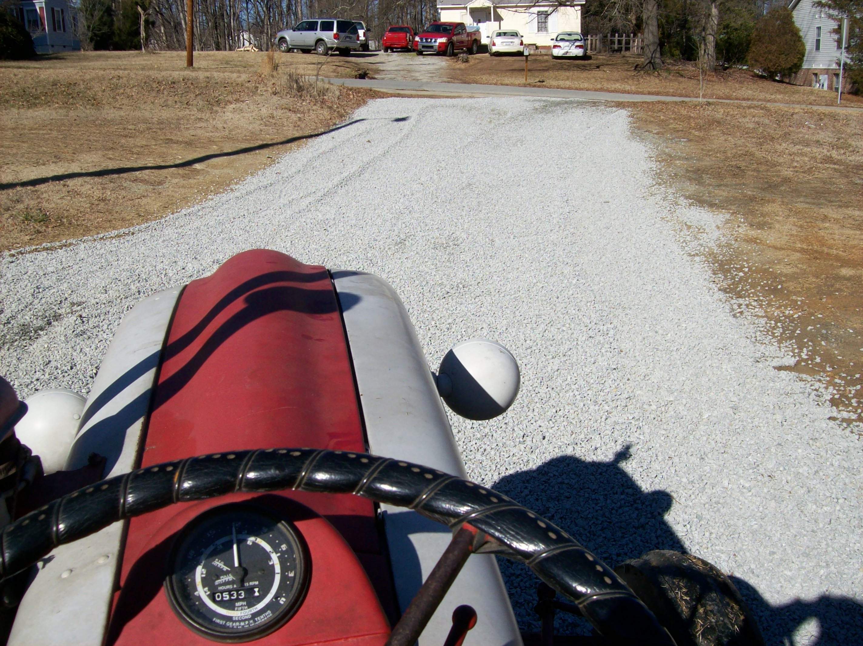

Today we had a load of gravel delivered and spread somewhat at our rental house driveway. I fired up the 58 Ford 861D to smooth out a couple spots in the driveway. Temperature had warmed up to about 38 degrees, and this was only about the 6th or 7th time I have started the tractor since I fixed the sheared teeth on the hydraulic pump and engine cam when I went through the engine in earlier lengthy posts. Good news is, using the heater plugs first for about 45 seconds, she fired right up just fine. The battery may need replacing before much longer (too small) but that is another story.
I noticed the lift was raising up slow. I also noticed it did not drop down as quickly as I remember it did last time I used it or fall as quick as my 8N does. It lowers slow. Odd I thought, but I barely got the engine warmed up, so I thought, maybe was the cold hydraulic fluid?
I also noticed it would hickup or burp (best word I can come up with) every 15-20 seconds when the blade was raise up and I was just sitting idling when I finished using it today. It would hickup so strong that the tractor would shake. I glanced at my hydraulic gauge I had installed on the pump and the pressure would do a quick bump up a to 80 lbs or so and drop back to the 20-30 lbs. it holds normally when implement is stationary before each hickup. Is that air in the system? Can that sudden burst of pressure be the cause of my hydraulic pump gears failure back when I bought this tractor? I have only put 2 hours on the proof meter since I did all the engine work to this, but this is the first I've notice this hickup or the slow lift and drop. Cold temperatures?

Thanks, I think the cold was most of my problem. As you can see in the picture, the RPMs were not low (proof meter needle standing straight up) and it does have new UTC fluid in it from Tractor Supply (Traveller brand). I don't usually have much use for a tractor in winter unless the rare NC Piedmont area snow storm rolls through, so I'll probably hold off until warm weather before I try cutting the fluid with auto-tranny fluid as long as this hiccup will not harm anything for light/occasional use until then.
