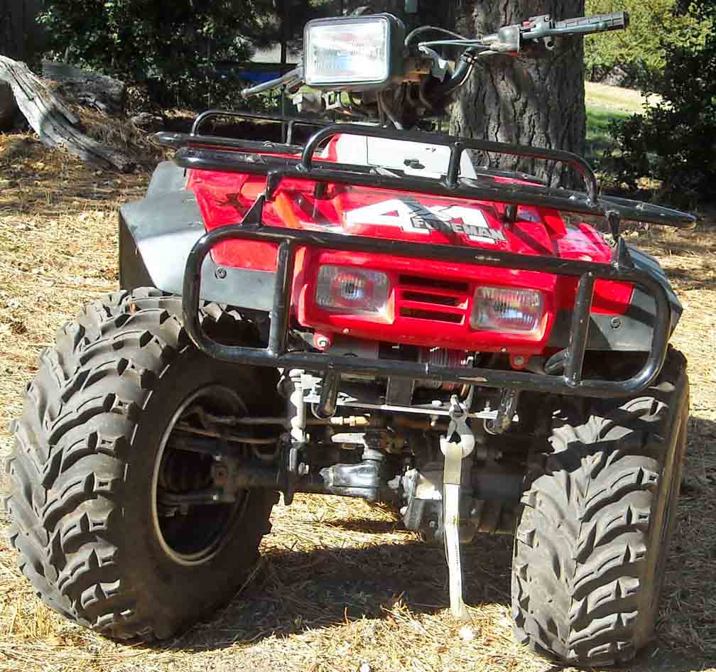

I gather you have the TRX350D Foreman, the first 4x4 quad? That was an an innovative and
unusual ATV with solid front axle. I had one, in primo shape.

Yes it is 4x4, wasn't sure of the D part. Mine in not primo but good. Runs good, shifting is a little stiff compared to newer ones. Just had the wheel bearing issue, also repacked ball joints since they cannot be greased.
It's a giod quad but it had a few issues when I bought it, but I knew that going in.
