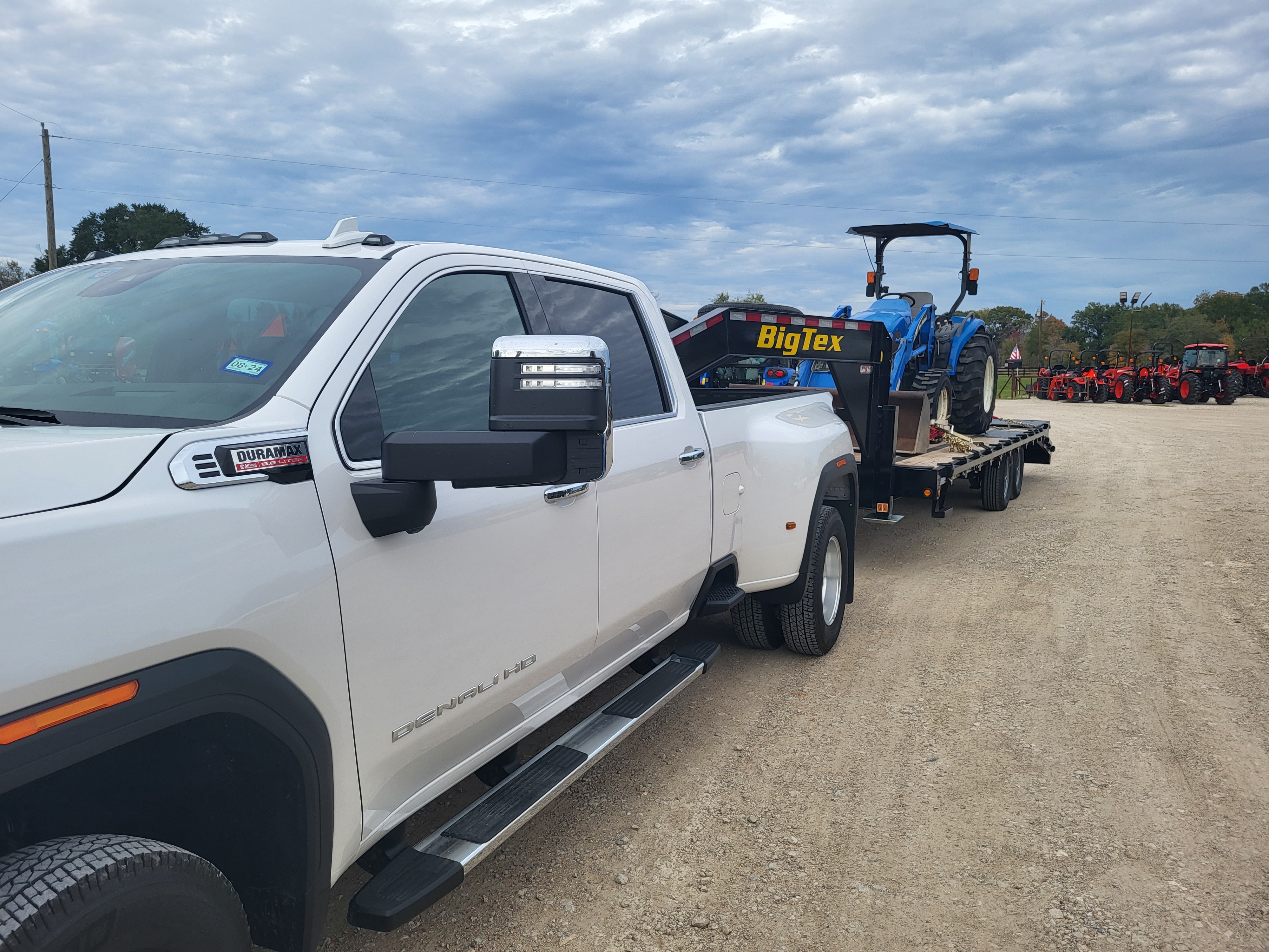

I went ahead and juiced the tires on my T574 TLB, taking it into the realm of 5,000# (before loader and backhoe). I own (prior to the tractor) a 7K (dual 3500# axle) equipment/utility trailer that I was thinking of trading up to a 10K (dual 5000# axle).
The key question for me will (obviously) be how much I need to haul the tractor, because what I have will be maxxed out and, when I need to haul it, I will have to drop the backhoe (+1,500#) and loader (+1,200#). Even then, it seems precarious to me.
My two-part question is, for you guys who are doing your own service and minor repairs and aren’t hauling your tractors regularly… do you:
(1) Keep a trailer maintained,
(2) Rent when needed,
(3) Rely on a dealer pickup
If you do maintain a trailer, would you recommend that I trade up from a 7K to a 10K, or even 14K if I only anticipate using it 2-3 times a year? I know there’s something to be said for being ready!

I upgraded from a 7K tilt bed to a 14K full tilt bed PJ 10 years ago. My reason was similar with trailer being maxed out at times. Mainly I haul tractors, cars, and trucks. I do my own service and repairs. Trailer is used about 20 or more times per year. For me, I don't want to pay dealer pickup/delivery costs and no local place near me to rent a 14K. I have the trailer ready to use at a moments notice when I need it.

I would upgrade even if using a few times a year. If something goes wrong while towing down a road, bad things can happen quickly. I have a 14K trailer now and glad I made that jump.

used 14k are much easier around here to find than a 10k. I paid $2200 for my 14k Loader toter brand bumper pull 18 ft. I see them regularly from 2500-3200 on marketplace. Just have to be ready with cash when one pops up.
Personally Id want at least a 10k trailer to haul tractors on unless your just hauling a light 8n, 230 massey etc.

True here also. I think I can get by with an 18’ 10K, but the trailer dealer mentioned most are simply going to 14K. But also, my Tundra’s max towing is effectively 8,800#, so 🤷‍♂️

Also check your local state trailer registration rules. Where I'm at if you're over 8k registered weight you have to register BOTH the trailer AND the tow vehicle by weight, OR get a per-trip registration, OR be registered as a farm vehicle (with distance limitations on how far you can tow at above the 8k range). The Register by weight was going to add another $500/yr on my truck registration fees.. and trip permits added up... I'm planning to eventually shift to farm plates which will change the math a bit and at that point I'll probably either trade or perhaps add a heavier trailer...
I'm also a big believer in not pushing too hard on your vehicles tow capacity as well. It's not what you can get started it's what you can get stopped when everything goes pear shaped. Having had a few "just missed the big jackpot" moments when younger with heavy stock trailers and such I've gotten more .. conservative.. Plus you'll loose some load capacity with the heavier trailer because well... it's heavier... so cross check curb weight, total capacity (giving you allowed cargo weight) vs truck capability, etc..
One other caveat on a lot of the 7K trailers is that they have light beams and minimal/insufficient cross bracing for tractors which tend to center load the trailer harder than cars (depending on wheelbase, etc..). I've seen more than a couple of 7k trailers that had clearly been folded a bit hah. My trailer dealer pointed me at one with 5" box frame instead of 4" and more than double the angle iron cross bracing of the cheaper version (the cheaper was sold as a "car hauler" and this was an "equipment hauler" and is built somewhat closer to a 10k trailer but still has lighter axles). I've certainly pushed the weight limit of it fairly hard and bias towards more on the tongue so it's putting more on my (heavier truck than you have...).
All things being equal I'd have preferred a 10k or 14k trailer but all things weren't entirely equal....
I also have had a bunch of other uses for the trailer, if it was only the tractors.. I'd probably lease or something instead of maintaining a trailer. It'll be interesting to see how much that usage persists long term as well, I might change my mind and get rid of the trailer entirely hah.

I have and maintain a 12k 20' trailer.
I would recommend a 12k or 14k trailer. A 10k trailer is going to be maxed out with 7700lbs of potential cargo. Trailering near, or at capacity is stressful and hard on equipment.
Issues arise with heavier trailers and tow vehicles that you may not have considered, like the GCWR (Gross combined weight rating) which can place your rig into commercial license territory.
There are plenty of threads here on that topic, and it can get confusing!
