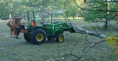

Best advise would be to ask your dealer for what he recommends for your
soil conditions.. Here in my part of Michigan we have sandy soil, you may
have heavy clay soil which may require more power or smaller tiller...
Also check the engine size on the 790 your buying, I have a 91 cu in diesel
but I've seen some 790's lately with a 81 cu in engine...
The tiller I have is a 60 inch King Kutter I picked up at TSC. I tilled about a
acre of lawn last year for reseeding to a depth of about 4 to 5 inches. There
was no noticeable strain to the tractor but again I stress we have sandy soil..
Doing PTO work the 790 will hold it's own against any tractor in it's HP class
but If you intend to do a lot of work that requires traction then a heaver tractor
would be recommended...
Attached is a picture of the 790 carrying a 65 foot tree, that's a Woods chipper
on the 3 pt...

Thanks. nice looking picture. I pulled up John Deere last night. Info I was asking dealer for was right there. Five foot was recommended, so that is good.
