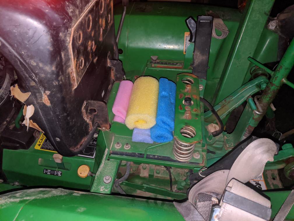

Not wanting to admit that I am a fat a@@, but, my 250 pounds overwhelm the springs and at times they bottom out hard. Has anyone replaced the springs with heavier ones or added helper springs? If so, what did you use?

I read where some people use tennis balls as a bump stop. They might not work on all seats though. :confused3:
   / 790 seat springs #3

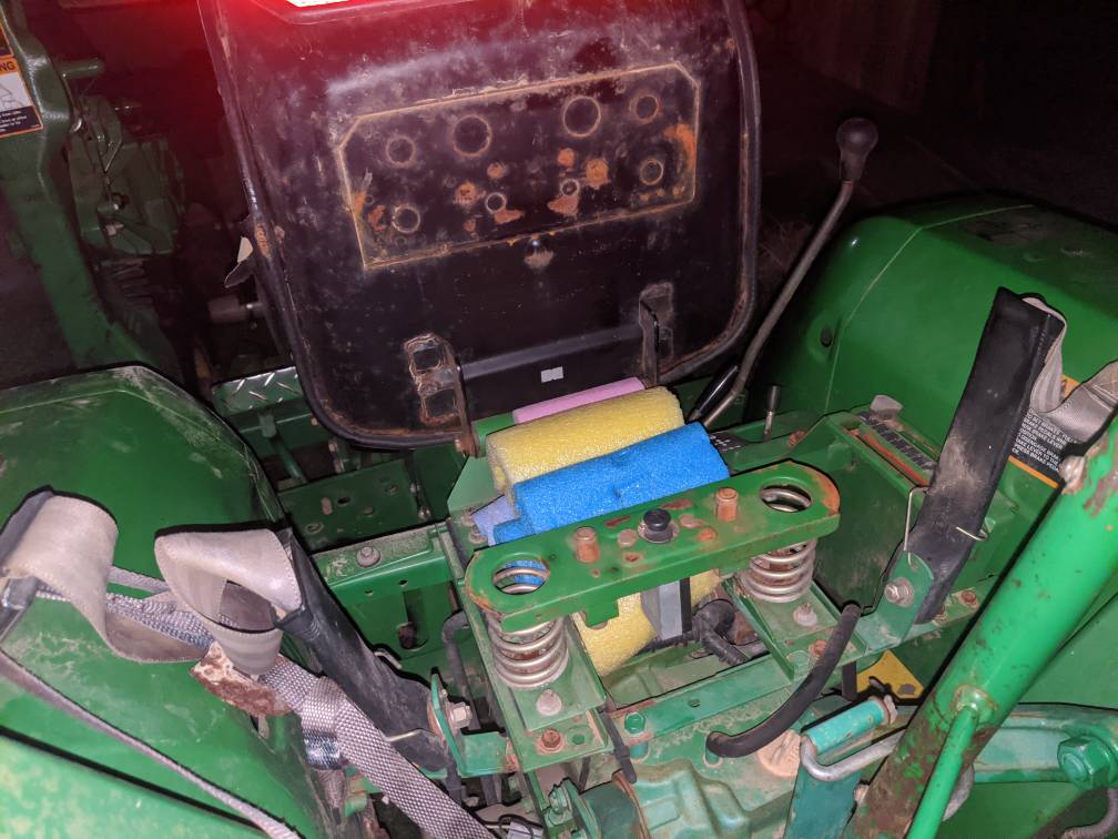

I found an older thread, where people used a cut up pool noodle under the seat. I tried it today and was trying to find the original post to thank them.
I'm a touch heavier than you and several small sections of a $2 noodle dramatically improved my ride today.

Where did you place them? Pictures maybe?
Thanks, Robert.
   / 790 seat springs #5
Thanks, Robert.
I cut them about 10 inches. Put them sideways under the seat. I'm closer to 300 than I care to admit and it made a huge difference. I still have the original 30 year old springs. From the picture it looks like one slipped too low and isn't doing anything... IMG_20200812_205255.jpgIMG_20200812_205309.jpg
   / 790 seat springs #6
You could also tightly roll some of that foam and push through the holes so the foam is in the springs.
   / 790 seat springs #7
I'm gonna do that tomorrow. Good idea!
