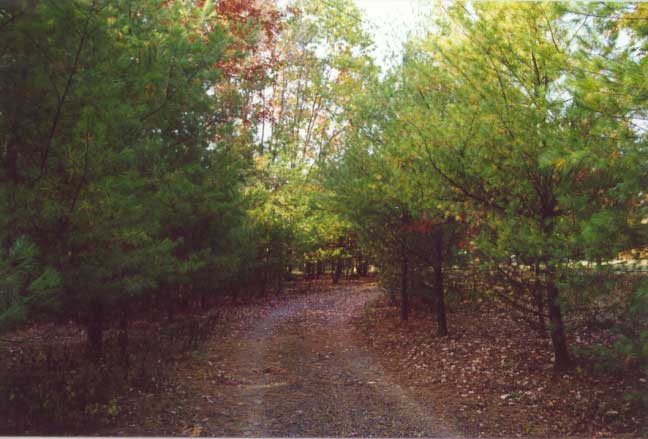

Gentlemen and elightened Tractor Ladies,
I've had my 790 for several years now and really love it. Currently, I use it mostly for mowing and relatively light loader work without any issues.
However, I've got a big driveway project coming up this summer and I'd really like to be able to do some snow plowing work next winter.
While I know that I ought to purchase a box blade for the driveway work and a reversable back-blade for the snow-plowing, I need some adivse on how to improve the performance of the loader and the basic abilities to handle heavier work.......
I need some advise on "umph" upgrades. Here's my initial thoughts & questions:
<ul type="square"> [*]Replace my turf tires with R4's - What are the basic considerations for doing this?
[*]Add a tooth-bar to my loader for the driveway work - Are they easy to install for a do-it-your-selfer?
[*]Adding shims to the hydraulic system scares me - If I do this, am I risking a major failure?
[/list]
Here's a picture of my driveway.
It's about 300 feet long, with a gentle up hill slope. It's gotten badly rutted and needs to be resurfaced (with gravel) and some sloping done to handle the drainage issues.

My driveway has a fairly steep hill with a sharp curve about a third of the way up. My tractor, a 4300, weighs about 800 lbs more than your 790. I have a seven foot Meyer snow plow that I modified to mount on my loader in place of the bucket. With two wheel weights per rear tire, a 600 lb ballast box, and a set of standard ladder chains on the rear, traction is rarely an issue. Like you, I have turf tires.
How much ballast (loaded tires, wheel weights, ballast box) do you currently run? You'll need sufficient ballast no matter what type of tire you run.
Aside from the obvious safety factors involved, ballast behind the tractor in the form of a ballast box or heavy implement is especially important when using a loader to carry a heavy load. Without it, you'll place an undue amount of strain on the steering axle which can result in premature seal and bearing failure.
If you're planning to purchase a box blade, you might want to consider using it as ballast while you are using the loader.
</font><font color="blue" class="small">( * Add a tooth-bar to my loader for the driveway work - Are they easy to install for a do-it-your-selfer? )</font>
A tooth bar will certainly increase your ability to excavate with your loader. Search the forums for "tooth bar". You'll find lots of information.
</font><font color="blue" class="small">( * Adding shims to the hydraulic system scares me - If I do this, am I risking a major failure? )</font>
If the pressure relief valve is set substantially below spec (check it with a pressure gauge), then adding shims to bring it up to spec is certainly acceptable. Adding shims to the relief valve for the purpose of raising the pressure above spec will likely be costly in the long run. The relief valve is there to protect both the hydraulic and mechanical components of the tractor and attachments. Better to make two trips then bend or break something trying to carry a lazy man's load.

Henry, you really need to look up the internet site that explains how to repair gravel roads. It will help you to figure out what you need and when you need to do it. Working the road when it is dry is not advisable, likewise, a road that is rainsoaked will create problems. Your basically going to need to rip the pot holes which in your case, may be the whole road. For that, you would need a boxscraper, but don't skimp on a light duty or even medium duty if you want some umph. I wish I could remember the site for gravel road repair, perhaps someone will refresh us.

All of you guys provide great advice..... Thanks a bunch. I guess I'll need to do a little more reading about the shims and talk to my local dealer.
