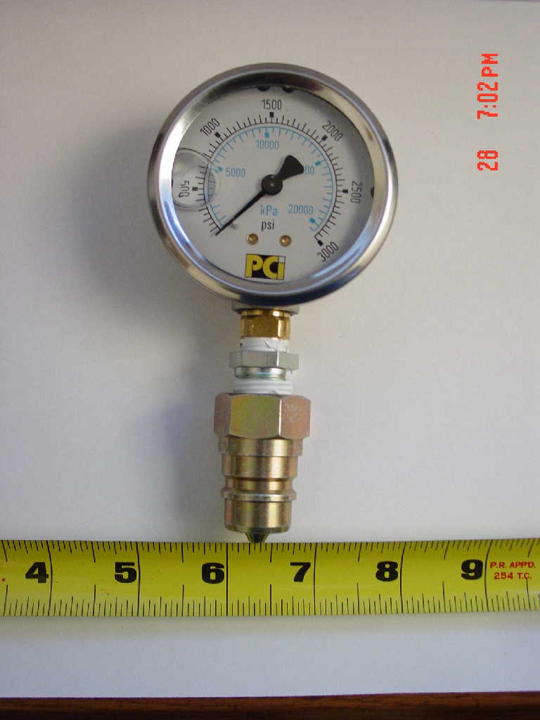

/ 790 loader #5

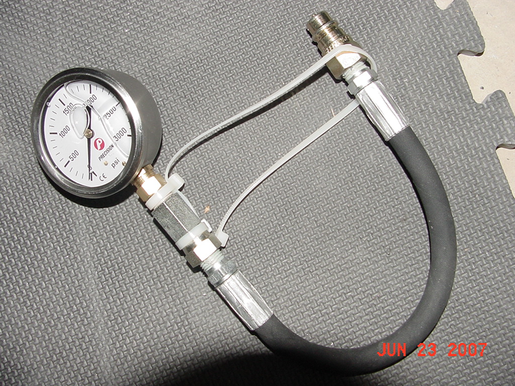

Just to add to what Roy wrote, You MUST have a gauge to check the before/after pressures so you don't damage anything. One can be made up for about $30 or so.
Here is a picture of mine:

/ 790 loader #7
Here's a picture of the gauge I bought from a local hydraulic shop. It was $19, plus a few dollars for the fitting on it. Get one with a range of 0-3000psi if you can find it, that will give you the best resolution & accuracy.

/ 790 loader #9
Kebo, did u get the fitting @ the jd place? Tractor supply did not have any to fit. Also, have u done the shimes to your 790?
Nope, got the fitting at the same hydraulic shop that sold me the gauge. Can't help you much with that, I don't know the brand or part number of that fitting.
I have added the shims to my tractor, which is why I bought the gauge. I think I put in one complete shim kit and just one very thin shim of a second kit to bring the pressure up to exactly 2500psi. Works great now, it's a very cheap improvement that gives you a sizable increase in capability.
/ 790 loader
Well that's ok! I had to oder the male end today from the jd place when I picked up the shimes. Will make the gauge and then add the shimes. I live in Anderson myself. Really been getting rain lately. Things really greening up right now. Hope it does'nt go to dry this summer.
