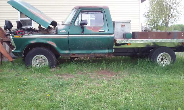

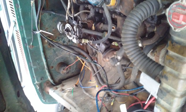

79 Ford F 150 won't start first of all I know this ain't a tractor but technically it's going to be getting used on farm in a farm truck but as replace a coil I have not been able to get the truck running yet I have replace the coil with a brand new one that got use a little bit this winter the truck with only one for climate now I've got no power going from the coil to the spark plugs everything is brand new on this truck but the motor and carburetor needs help fast please

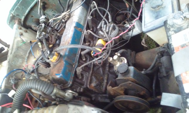

If you have power in and out of the coil, does it go to an ignition module?? And from the ignition module, to the distributor. Should go through the pickup coil, then through the reluctor, up to the rotor button.
How old is the distributor cap..?? Have you checked the lugs under the cap for ionization buildup..?? If the cap is old, I'd probably check that first. If it's new, probably the ignition module, assuming it is wired correctly..

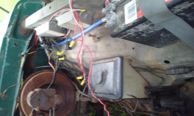

dura spark module on that beast ? ... pull a plug wire and hook it into the coil tower, put a spark plug on the other end , rest the plug on bare metal ... the with the ignition ON and the wires disconnected from the dura spark unit , connect a wire to the green wire from the coil and strike it on the bare metal ... you should get sparks from the HT coil to ground thru the spark plug good spark = coil is good
next reconnect all the low voltage wiring to the standard hook up and connect the red and white wire together ( push a pin thru them to connect 'em) try again for spark by cranking... got spark now ? .. then put the HT wires back to standard and try starting
red and white are power to the unit ... sometimes one wire goes bad .... ( white is start and red is run )
power goes to the coil and out on the green wire to the module to be shorted to ground as the reluctor signals ...
purple / black and orange all go to the reluctor / dist ... pulse is on orange and purple ... the BLACK IS GROUND FOR THE WHOLE SYSTEM ... so make sure it's good and clean to bare metal ( or the module won't fire the coil )

The pick up coil and reluctor are what replace the points in the dura spark and other newer electronic ignitions although unlike the points- the signal needs to be amplified before it can directly trigger the ignition coil by opening the circuit.
I would Make absolutely sure the black ground mentioned earlier is clean and securely grounded- had this same problem at times with some of my old AMC/jeeps- uses their version of the early dura spark and the ground is critical.
It sounds like it could be the pick up coil , seen a few go bad in Amcs and (GMs) to and they are great for driving a long and stranding a vehicle- then the engine cools down and will start right back up like there is no problem - till the next time you get a few miles from home...
Pick up coils produce a weak signal , have always used an oscilloscope to check for output.
