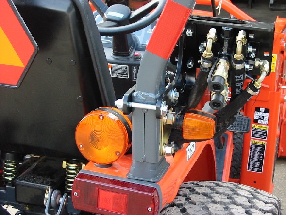

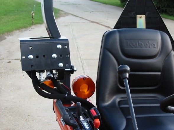

When I bought the 7610 last month I neg. in rear hydraulics....listened to everyone and didn't want to pay for it as an add on and the dump wagon which was going to be a manual lift with my 755 I traded will now be a hydraulic lift. Well it finally came in the dealer picked up the tractor yesterday and was back this morning.
Thought I'd show the set up as it's supposed to be a Kubota kit for the 7610. Not sure if I like the mount of the valve yet but here are a couple of pics.....
Kevin
Front.......

Back .......

/ 7610 Rear Hydraulics...... #3
Nothing wrong that that.........except watch out for trees /forums/images/graemlins/grin.gif
/ 7610 Rear Hydraulics...... #4
khd
Nice looking setup.
The front picture makes the bracket look like it is sticking out way to far. /forums/images/graemlins/blush.gif
But the rear picture shows that the bracket is within the FEL mounting. /forums/images/graemlins/smile.gif
What dealer did you get the valve from?
The dealer is Carlton Farm Supply in Monroe County. Very good dealer, easy going, take care of the customer kind of people.
It is within the FEL mounts but like I507 said I am worried about trees. We'll see how it goes.
Kevin

That is the setup that is offered directly by Kubota for the B-series.
It is, however, overpriced in my opinion. You can get the Kubota pricing from Tractorsmart.com. I put a 3-spool Prince on my B2710 for about what you paid for the single spool and it mounts on the fender making it much easier to use.

Kubota and most other manufacturers use open center hydraulics. The Kubota add-on stackable spools (you can have up to 3) are really expensive. My 3-spool Prince SV ran only about $225 without fittings and hoses. Additional spools for the Kubota kit will cost you about $250 each.
You can see my setup here .
