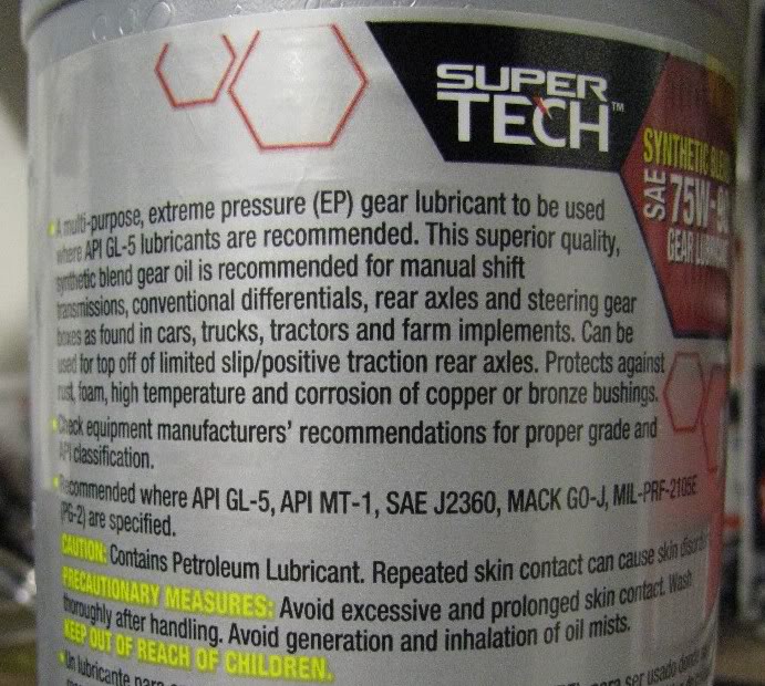

I have a 76 troybuilt horse tiller and have 2 questions. Where is the drain for the gear oil located i know where the vent is and where the fill is but where is the drain. Also what type of gear oil is ok everything I can find is gl5. If it says it is yellow metal safe. I was thinking royal purple synthetic.

This might be cheaper than Royal Purple. Reportedly for bronze bearings, AKA, "Yellow Metal".
   / 76 troybuilt horse gear oil #3
140 weight oil is what you need, the drain plug is on the side of the transmission case below one of the axles I think
