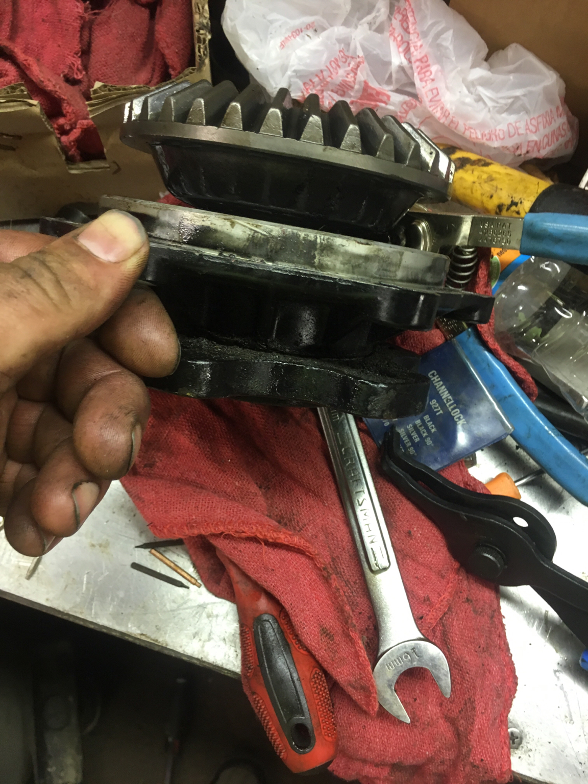

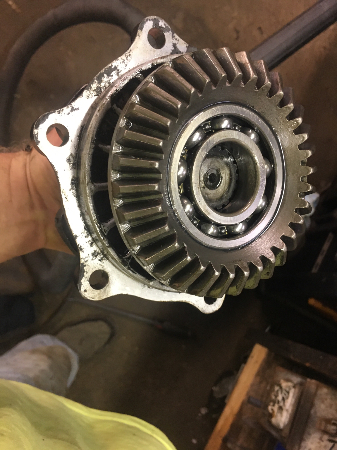

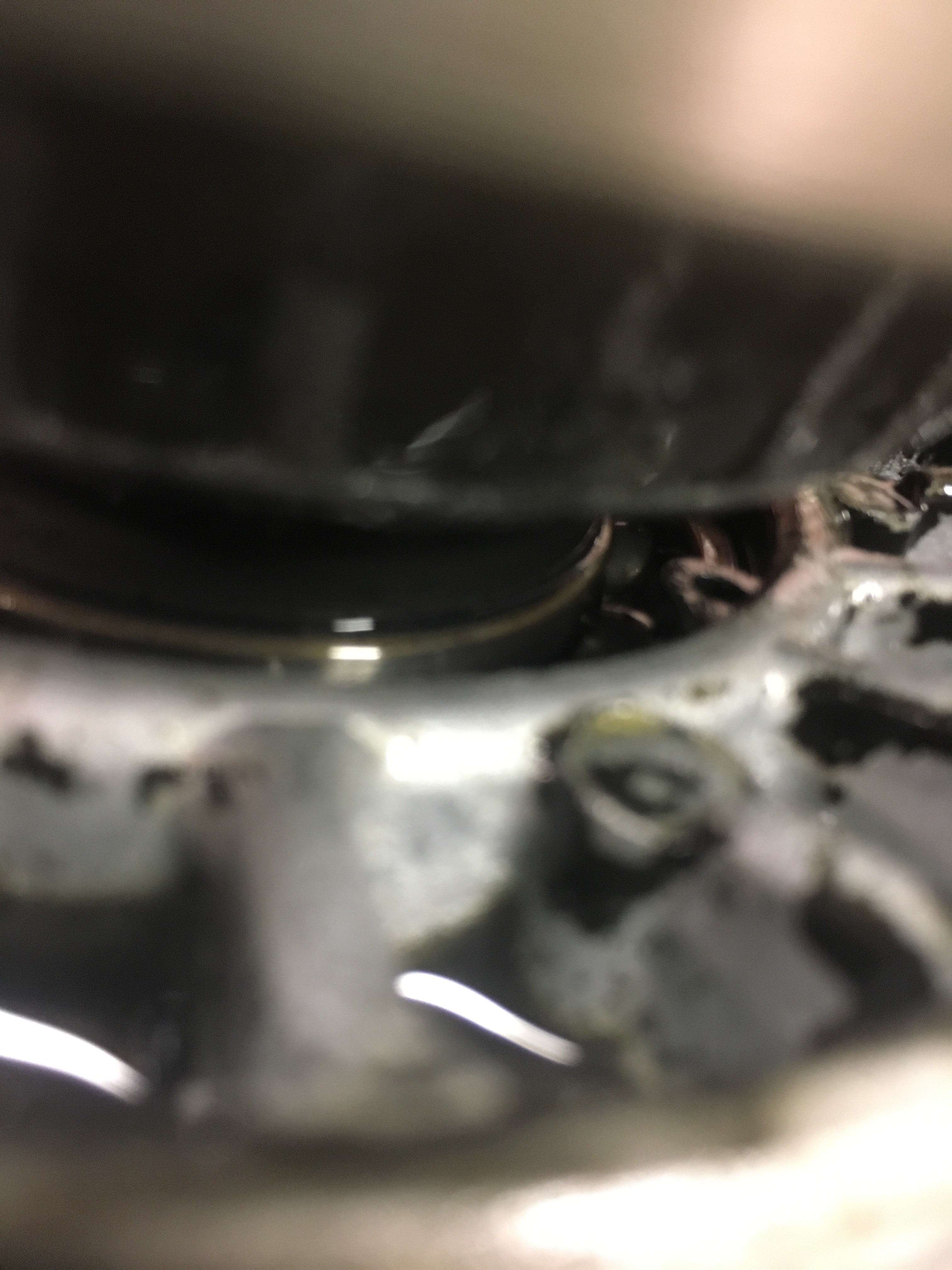

Has anyone pulled one of these apart, I was curious what steps are needed, Does the snap ring come out first ? It's almost impossible to get to with the pliers I have. IMG_4820.JPGIMG_4821.JPGIMG_4822.JPG

That bearing should be out first, I believe (ref right pic)

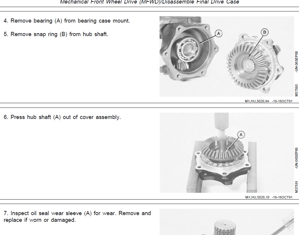

Screen shot shown in service manual

Awesome thank you very much

Bearing has to come out of hear first. Then snap ring on axle shaft. I think that snap ring in first pic is bearing retainer in housing.
