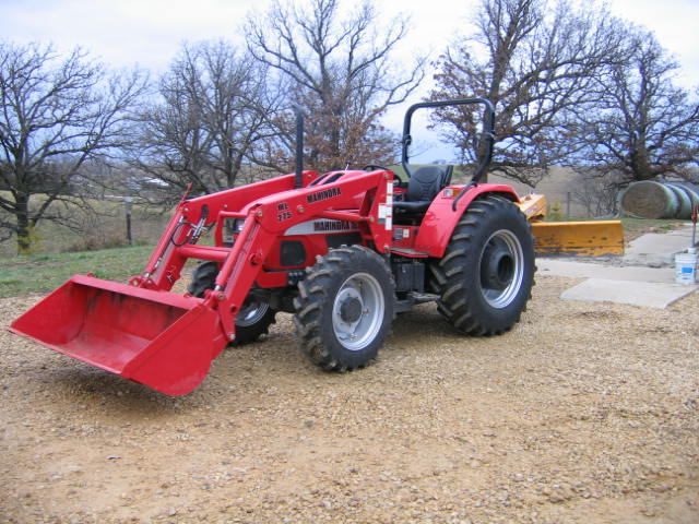

congrats 7520,
I also have a 7520 and so far I really like it. I had a 6500 that I purchased last March and then when the 7520 came out, I had to have one. I really loved my 6500, but I really disliked the platform as I really felt cramped. The 7520 really seems to be quite the tractor so far, I only have 20 hrs on it so far. I do have to say though that I felt that the 6500 did start a little better when it is really cold and also runs smoother when first started. I have a fel and I believe 4 weights on each rear tire. I didn't want the fluid in them at this time and I haven't had any problems at all. I also use the forks I made for the fel to haul large bales and it works great!! Congrats and good luck! We'll have to keep in touch and let each other know how we're getting along. I have had to have a neutral switch replaced so far on the pto neutral switch. It was just sticking a little bit and was operating intermittently so I had it replaced otherwise all else is well.

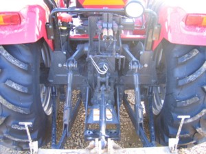

Can either of you post a picture of the back of the unit please. Would also like to see the platform. I have been waiting to see this unit and up grade from my 6000. Talking with my dealer, seems to be concern 3pt hitch is low in the back. Heard Mahindra was going to redesign. Can you confirm? What can a fella expect to pay for this baby?

/ 7520 came today #15
Brian: Looks real nice and thanks so much for taking the time. Now that I look at the rear, it appears that it is the draw bar that looks close to the ground. Have you looked at that or had any trouble with it? I have a 6000 and have not had any problems, but I think it is lower on the 7520. Will measure the ground clearance this week and send another email just to let you know.

I really liked the 6500, but I LOVE the 7520. It is so much easier to get on and off with the open platform. As far as handling, you really wouldn't know any difference between the two. I have very hilly ground and both the 6500 and the 7520 works well. I feel very safe on both. I do wear my seatbelt especially in some of the places I have been. I was pushing the limit, very dumb I know, but they are truly a workhorse.

I'm not sure what the ground clearance is but I feel that the drawbar is actually a little taller, but I may be wrong.
Brian
/ 7520 came today #19
The height of the drawbar is adjustable on the 6500. I moved mine after I got it.
Will
/ 7520 came today #20
After doing some more checking, I have been informed it is the pto that is set lower. I still have not seen the rear of one so can't compare it to my 6000.
