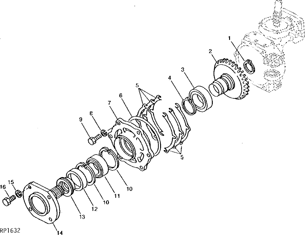

The front left wheel all of a sudden seized up on me. After lifting the front end, I can rotate the wheel from about 10-2, no farther. I tried it in 2 and 4 WD, checked the front end oil, etc. Before taking it apart, does anyone have an idea what the cause may be?

With the front wheels up --- what happens when you try to spin the other wheel by hand?
Do you hear any unusual noises coming from the "pumpkin" --- the front differential housing?
If so, you probably have some main differential gear damage. However, I'd be more inclined to believe that you've got a pinion gear on that wheel that's gone gunnysack.

The other wheel spins freely and I don't hear any noise coming from the pumpkin. I've been meaning to pick up a tech manual, but never really needed it, 'til now.
   / 750 4WD front wheel seized #4
It sounds like you probably have a broken tooth in one of the gears in the final drive drop housing. Check out gear #2 in the attached picture. also look at the gear it meshes with. This comes apart pretty easy. Just remove the six bolts and be sure to keep the shims(#5) in the same position as when you remove them. They keep the gears meshed properly. Also be sure to look at bearings(#3&11). If the bearings are worn, that might cause broken teeth on the gears.

Thanks jd110, I've been looking all over the web for that. I coulnd't get into JD Parts for some reason. Thought it might be there. Is there any tension on the steering linkage, and anything else I need to know about? I see your a seasoned mechanic. I raised the front end with the loader, and have a jackstand under the problem side. Should I raise and support the front end equally? This is a huge help!

I'm from Britton, 10 miles west of Cabela's. Thanks for the JD site info. I've been there before, but made a wrong turn sonewhere. I just won a tech manual on eBay, so that will help out a bunch. The inner hub with 6 bolts that is star shaped in the diagram, is not star shaped on my tractor, so I cannot get to the bolts behind it, except for a couple. I need to find the best way to get at it without taking apart anything not neccessay.

One recommendaton --- if you're gonna be in there pulling things out and putting things back in --- might consider new bearings... If they're getting up there in hours, like jd110 mentioned, could be the reason you might have a chipped tooth on a gear surface.
