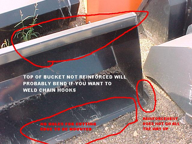

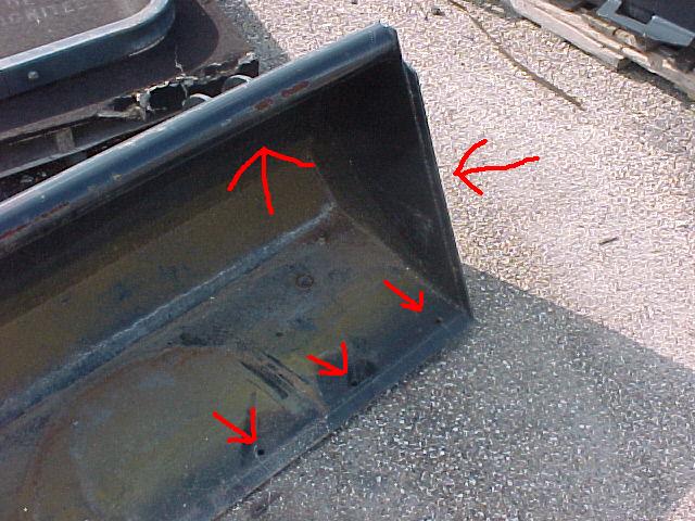

Regarding the 7308 FEL, what is the difference between the standard bucket and the heavy duty bucket? Anyone have pictures of them? Is there a difference in the capacity, or is the HD one just stronger? Thanks.

HD Bucket has a rolled top edge, reinforced side cutting plates, and welded on cutting edge that is predrilled to mount another bolt on cutting edge to. Attached is a picture of a heavy duty bucket. The picture is taken of just one side of it so that you can see more clearly the difference.

Here is a standard duty
