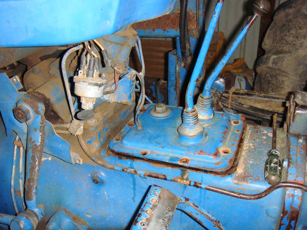

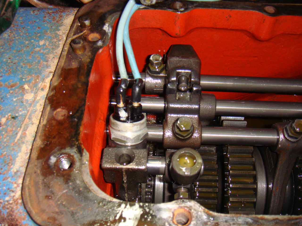

The Ford 3000 has a neutral safety switch under the transmission cover. The hi/low lever (the short one) has to be in neutral before it will start. There are 2 wires that come out of the transmission cover just ahead of the shifters. If you follow these wires, you will have to remove the steering shroud, there should be a plug on these wires. Unplug the wires and put a short jumper across the 2 that go up under the dash.
PLEASE BE CAREFUL! DO NOT STAND ON THE GROUND TO START THE TRACTOR! THIS WILL DISABLE THE NEUTRAL SAFETY SWITCH!
If the neutral safety switch is bad, remove the shifter cover and replace it. This is a very easy job.
Again, Please be careful if you bypass any safety.
Mike

Update:
Still no success....
I completed all the checks you guys suggested except for Mikes Tractos'. I checked the ignition switch and saw power coming to. I then checked the cable from the ignition switch to the solenoid and found with the multi-meter that there is NEGATIVE POWER when the key is turned to the "start" position and then .4 amps when the key is in the "on" position. Ok..... Is that wire my problem? All the wires AT the ignition switch are showing 12 volts-
Tomorrow I will be checking the "Neutral Safety Switch." I didn't even know the tractor had one, nor had I heard of one before, thanks Mike! So I investigated. I took some pictures in case someone reading was curious as well, and hopefully I will NOT have to open the transmission case again to look (or replace the switch).
First picture: Shifters and panel in-tact. You can see the two wires entering the transmission on the left (near the shifters)
Second picture: This is the panel open to the tranny. You can see the wires ending in the neutral safety switch.
