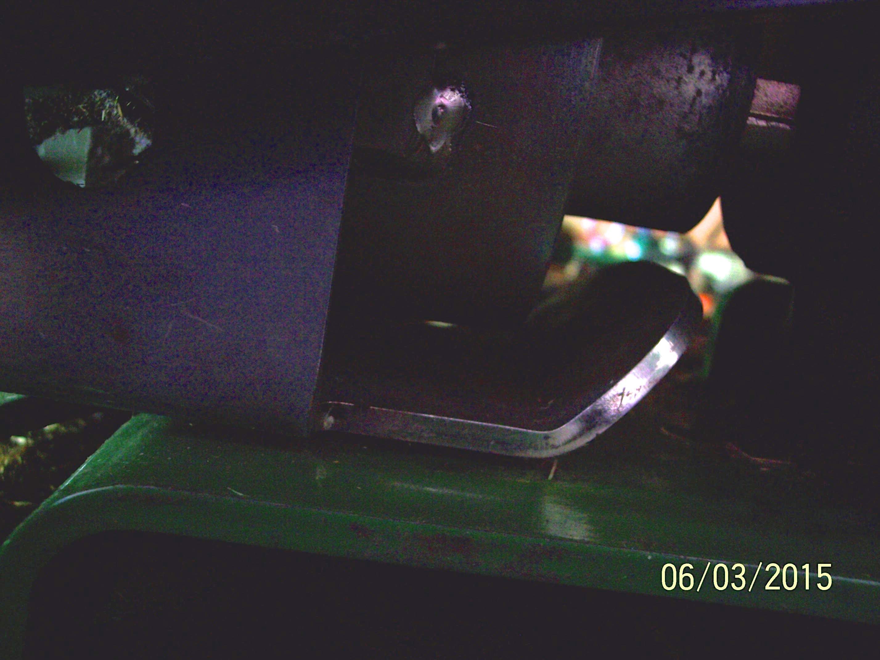

Beenthere, you're good. That was a horrible picture along with no explanation.
I wanted to show the gap between the deck and the assembly that supports the carrier bearing.
When the little carriage bolts get loose that assembly hits the gearbox mounting frame on the deck and makes one heck of a racket as the mid PTO rotates. Here is a much better picture pointing out the bolt location and the resulting wear that occurred from them being loose. Bearing support .JPG
I still haven't checked the temperature of anything but that gearbox DOES get pretty darn hot after 3 hours of mowing.

When my bolts came loose it sounded like it chatters. Actually the metal plates are chattering together. Had my wife sit on the tractor with pto engaged watched the thing bounce like crazy. It will be obvious if it is loose. When tightened it does not move.
