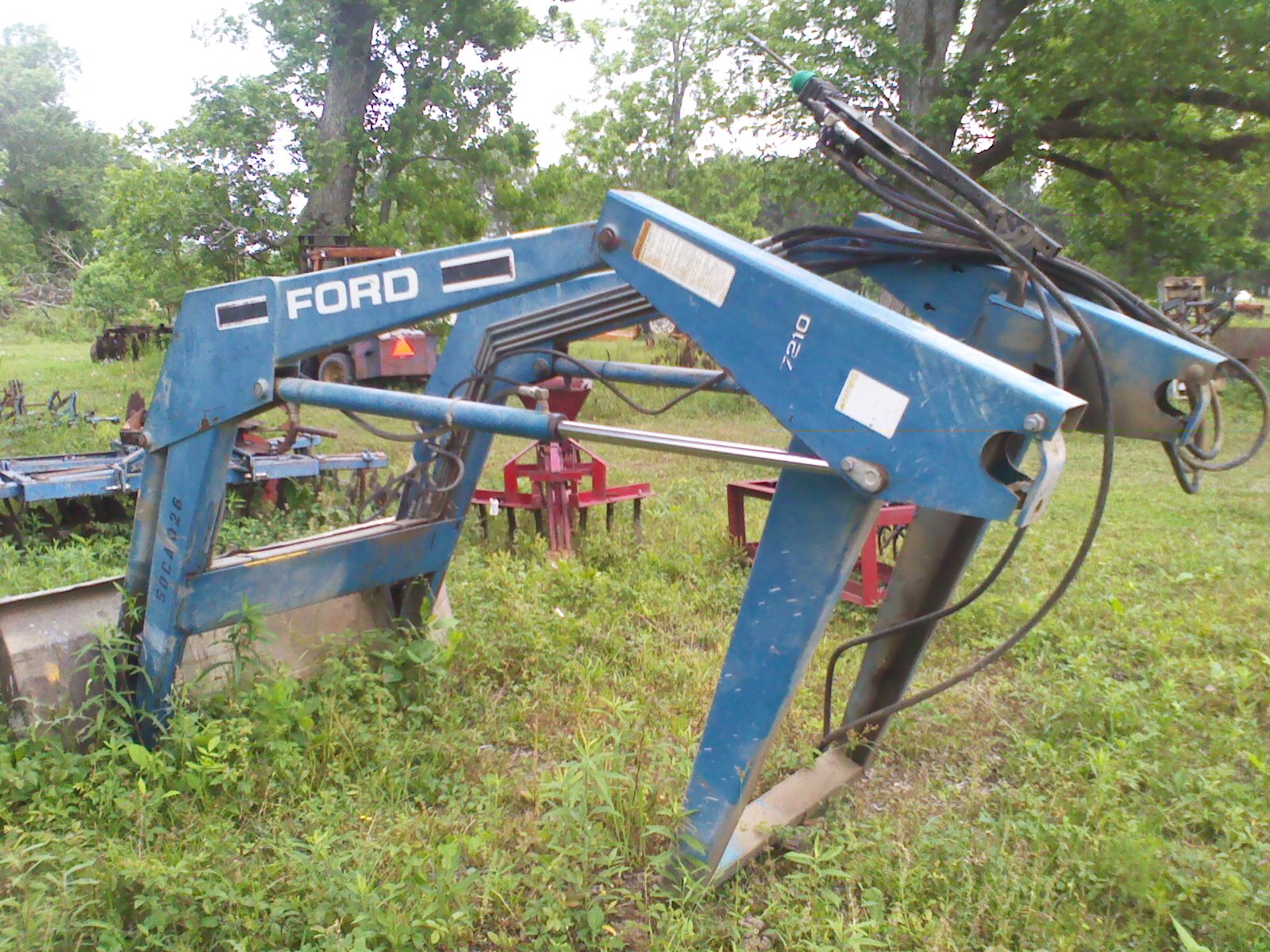

I have been looking for a loader for my 2003 New Holland 5610S 4wd no cab. I found a loader that came off a Ford 2wd 5610 and I was wondering if it would fit on my tractor..guy says he has all the parts but I just don稚 know... I really want to make sure that part on the far right of the pic that goes down will not interfere with the driveshaft.. He said he has all the parts.. I have attached a pic of the loader...thanks in advance for the help....

The part with 7210 decal on it is near horizontal. When mounted on the tractor, it's vertical. The piece going down, wraps around the front of the tractor in front of the grill. I don't know if it'll fit your tractor though.

Graybow77,
I don't believe that loader will fit your tractor. You would need the 7410 for a 4wd. If you decide you don't want to by the 7210 pictured let me know. I have a 2wd that it will fit.
