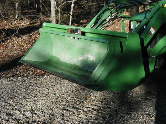

I have the 72" materials bucket for my 4310-300cx, 32 h.p. handles snow and light soil no problem, I use the 61" heavy duty bucket for digging and heavy gravel, if your tractor has more h.p. then the 72" bucket would be ok if your model has less H.P. the 72" would not be good except for light snow. It's called a light material bucket but it is not light duty at all, can't remember the volume but it's alot more than the 61" bucket as it's much taller and deeper, got it for snow removal mainly, can give you any dimensions you need. attached picture of 61" bucket inside the 72" bucket.
The 3720 has 44 hp, however, the frame size is probably only slightly bigger than a 4310 and the 72" bucket seems to be too much. Does your loader have the skid steer carrier attachment? If not then the 72" bucket I am looking at is different. At 485 lbs, I would not call that a standard or light duty bucket. On the JD website the 72" bucket I am looking at is black in color. My kubota bucket on my 3710 weighs about 230-240 lbs and is 66" wide by 22x22 in depth and height. I want a little more capacity and strength but not a bucket approaching 500 lbs.
I did put a JD 66" utility skid steer bucket which weighed 479 lbs and measured 27.6" in height and 35" in depth and that thing seemed massive on my 3720 Jd. Good light materials or snow bucket but no way could it lift a load of dirt. That bucket was much more heavy duty than the usual standard JD CTL bucket. The 72" bucket I am looking at is wider but I suspect the dimensions may be just as big. I don't want the depth of a low profile bucket due to poor rollback/breakout strengh on the loader because the long depth which is often 35-37". My ideal bucket would be 66" wide, and about 24x24 height and depth and weight 325-350 lbs. Any competitor's bucket or aftermarket bucket would be ok.
Thanks for the picture of the 2 buckets.
