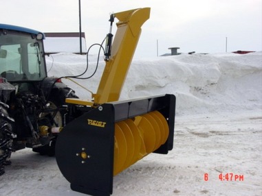

Its a spaghetti question with many threads but:
A couple of things are more important right now. the major factor is the up front loss of power through the hydrostatic transmission of the mule so you will be limited to a snow thrower that will be 60 inches wide to perform properly.
A Reist Single stage snow thrower will be more than adequate for your needs and you will still have plenty of torque to use as you are not spinning a secondary impeller fan.
1. what type of tires are on your mule?
2. does your mule have loaded tires?
3. do you have a front end loader?
4. does your mule have snow and ice chains?
5. if you could would you purchase a snow thrower that is a single stage snow thrower that requires 20 percent less power allowing greater torque delivered to the snow thrower through the gear box to the chain drive to the snow blower rotor?
[url=http://www.youtube.com/watch?v=fgLN03ThGd4
would you purchase a snow thrower that can have its rotor speed changed easily by changing sprocket sizes to increase the discharge speed of the snow blower rotor by replacing the driven sprocket with a smaller driven sprocket?
7. if you could would you purchase a snow thrower which has fewer mechanical parts that are "common" available parts would you consider purchasing it?
A single stage snow thrower has fewer parts and weighs less.
The Reist single stage snow throwers can be used as a front mount or a rear mount unit with a few simple part changes.

I have R1 ag tires with weights on the rear. Front end loader and bucket that will stay on all winter.
I have about 200' of driveway that will need to be done with every snowfall, plus a 30x30 parking area. Not tiny, but not huge. This will probably be 2-5 times each week for 3-4 months, and a little more before/after peak snow season.
I may also want to blow snow from the sides of two barns a few times a season, and possibly even around the perimeter of a fence, which would be a 1000-1400' run, but only 1-2 times per winter and not under time pressure.
The Reist single stage look interesting, but list price on a 72" is $6500 CAN, and there is no likely combination of discounts and exchange that will make that competitive with the Woodmaxx.
Please avoid any comments about "gee, that sounds unpleasant". I like winter, and I don't have an UNlimited budget to spend on the awesomest snow removal stuff.
