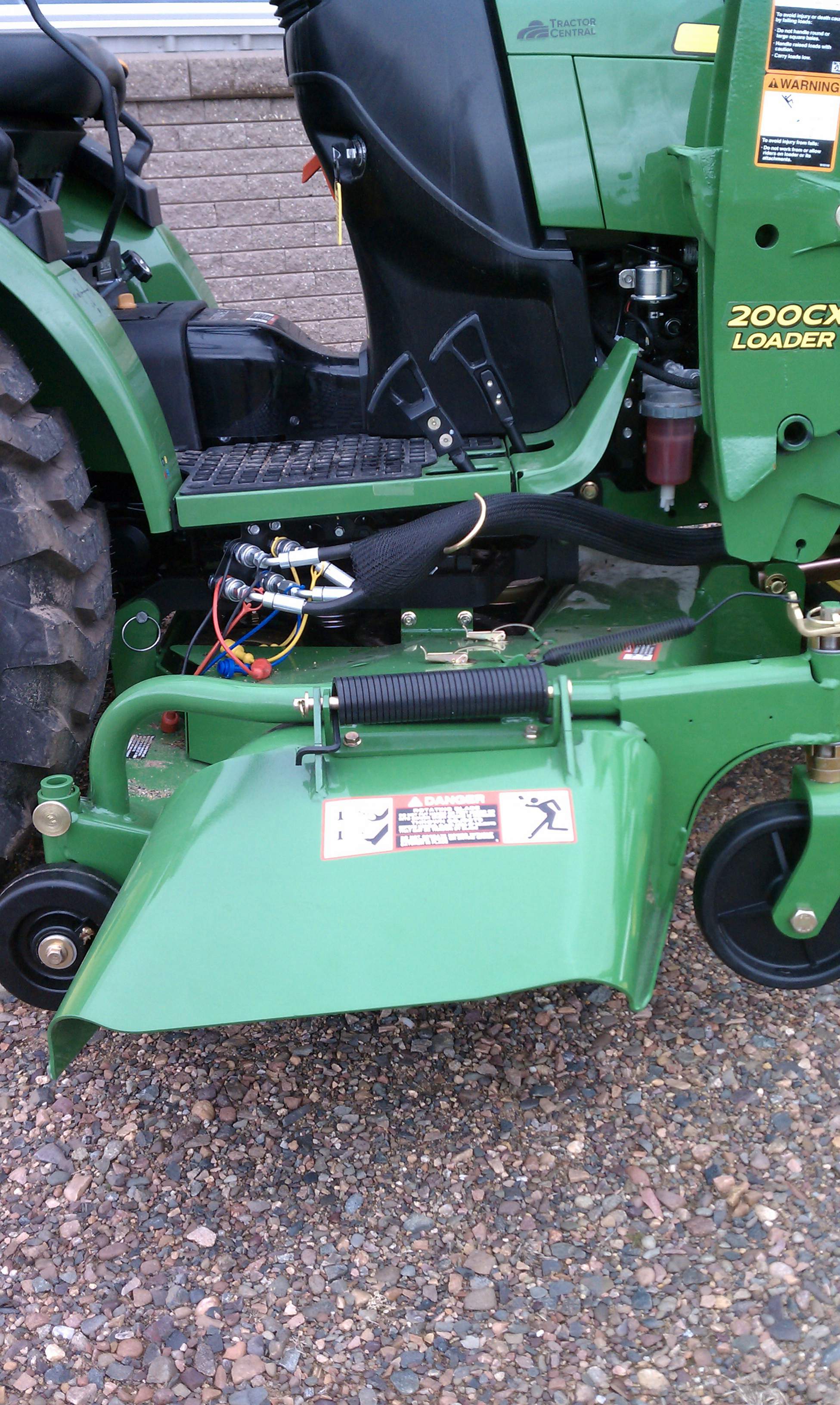

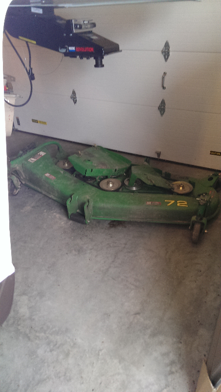

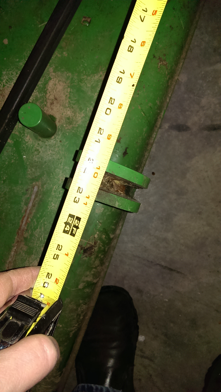

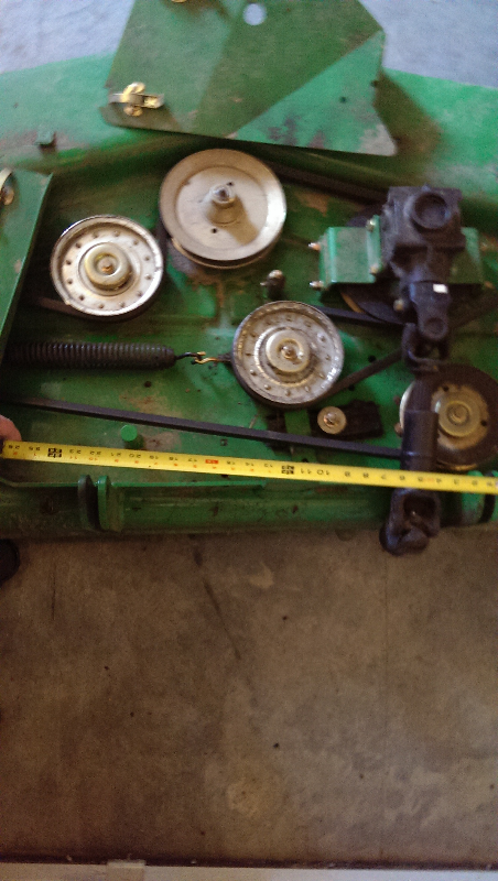

I'd love to see pictures of any guys with a 72 mounted as I admit, I am doing this a bit blind (trusting JD)
   / 72" mmm on 2520? Which one? #7
It sounds like it may be comparable to the 62C I have on my 2305. Can I get you to post a couple of pictures of you 72 so I can see what you are looking at? My 2305 doesn't have a lock up kit as I bought the hydraulic lift before they offered the bypass valve.

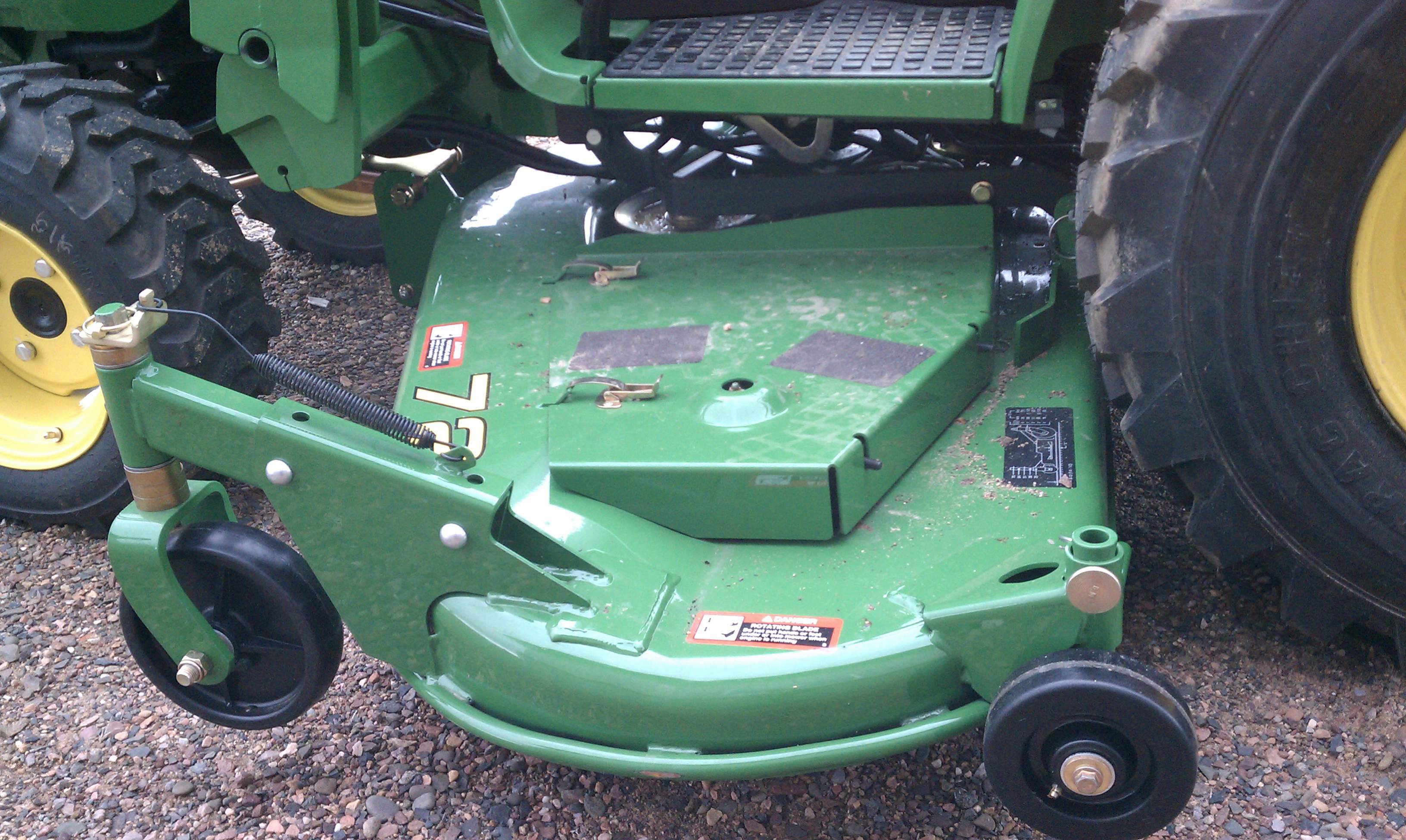

Lock up kit is the same for both decks. Should be different because of the weight difference is hard on that kit. Brackets bend and turnbuckles break. I'll post a picture of the 72". Having had both, the 62" and 72", the 72" is the better mower if you have room for it in your yard.

You bet. At an actual 73" cut and large yard this deck took 45+ minutes off mowing time. The deck is not hard getting on and off plus most users probably never take it off during the season.
