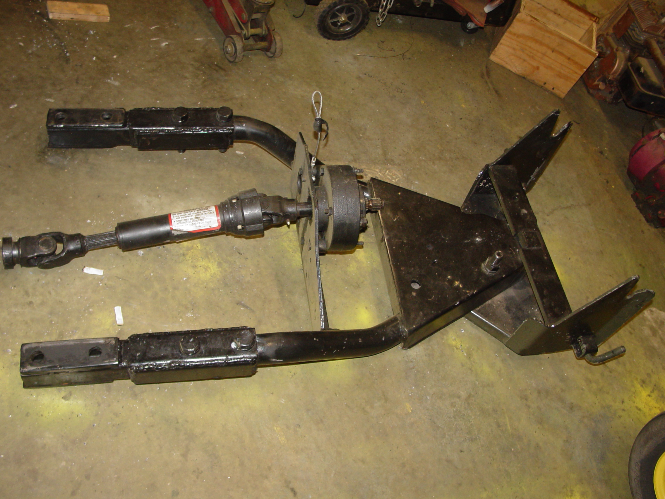

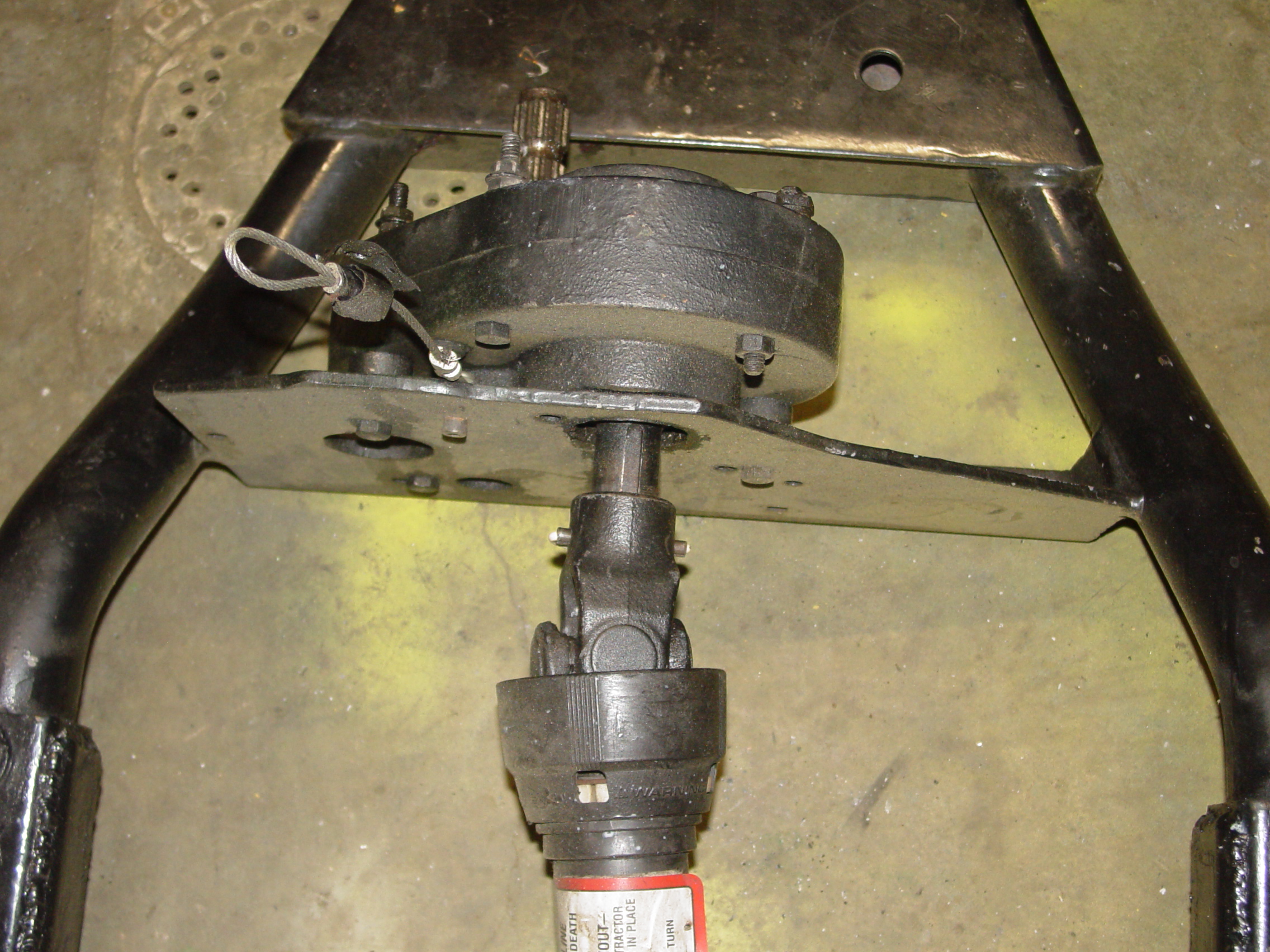

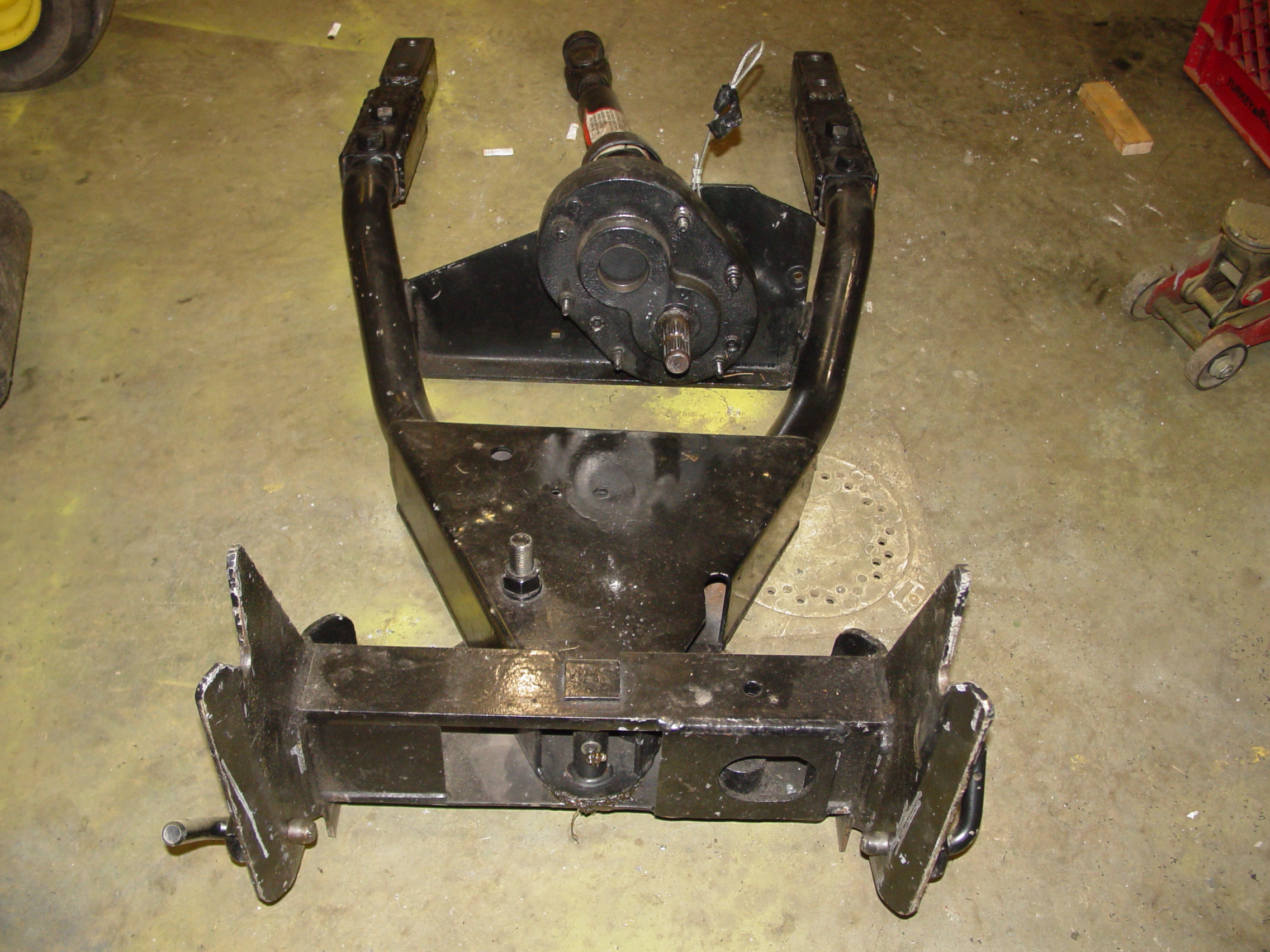

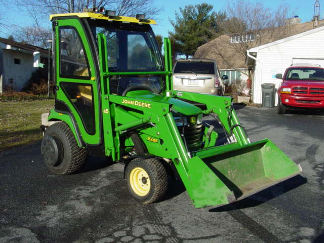

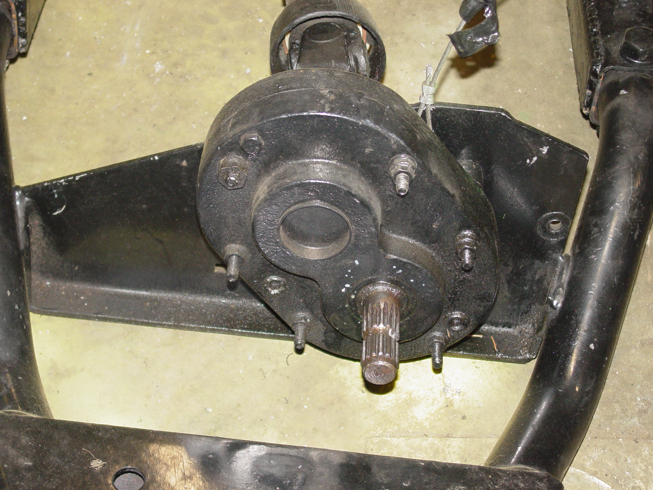

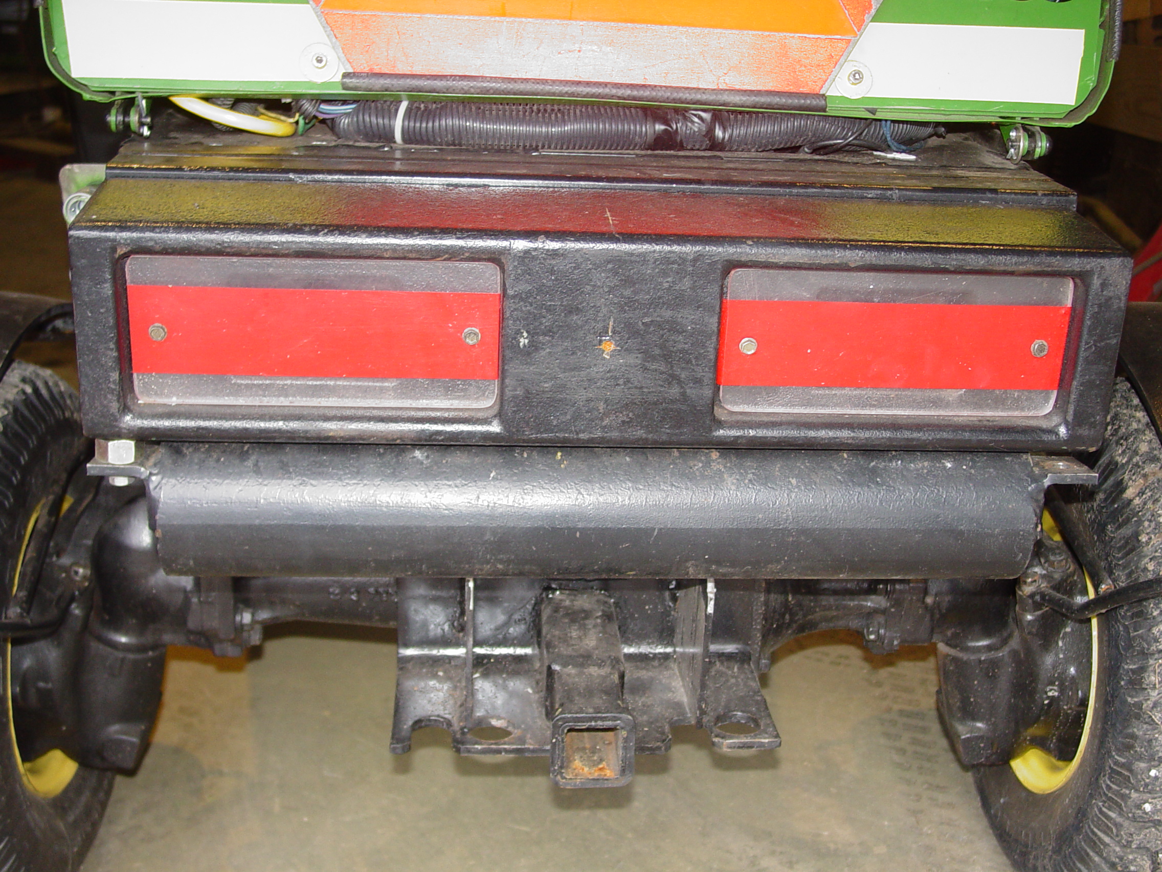

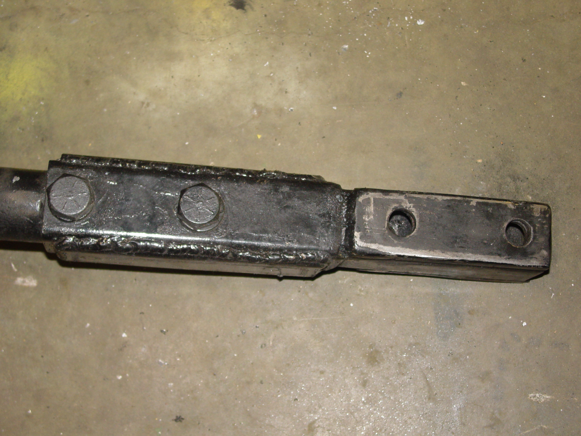

you can install a snow blower frame from a f900s on a f1145. I used the snow blower from my x585. so I can use eather one .you must turn the gear box so shafts line up front an rear must redrill for rear shaft 1 1/2 hole rebolt gear box to mounting plate. I had add 225 lds. to the rear start by filling the tires give you about 60 lbs DSC04466.JPG DSC04459.JPGDSC04460.JPGDSC04461.JPGDSC04462.JPGDSC04463.JPG
   / 72" John Deere front mower deck #6

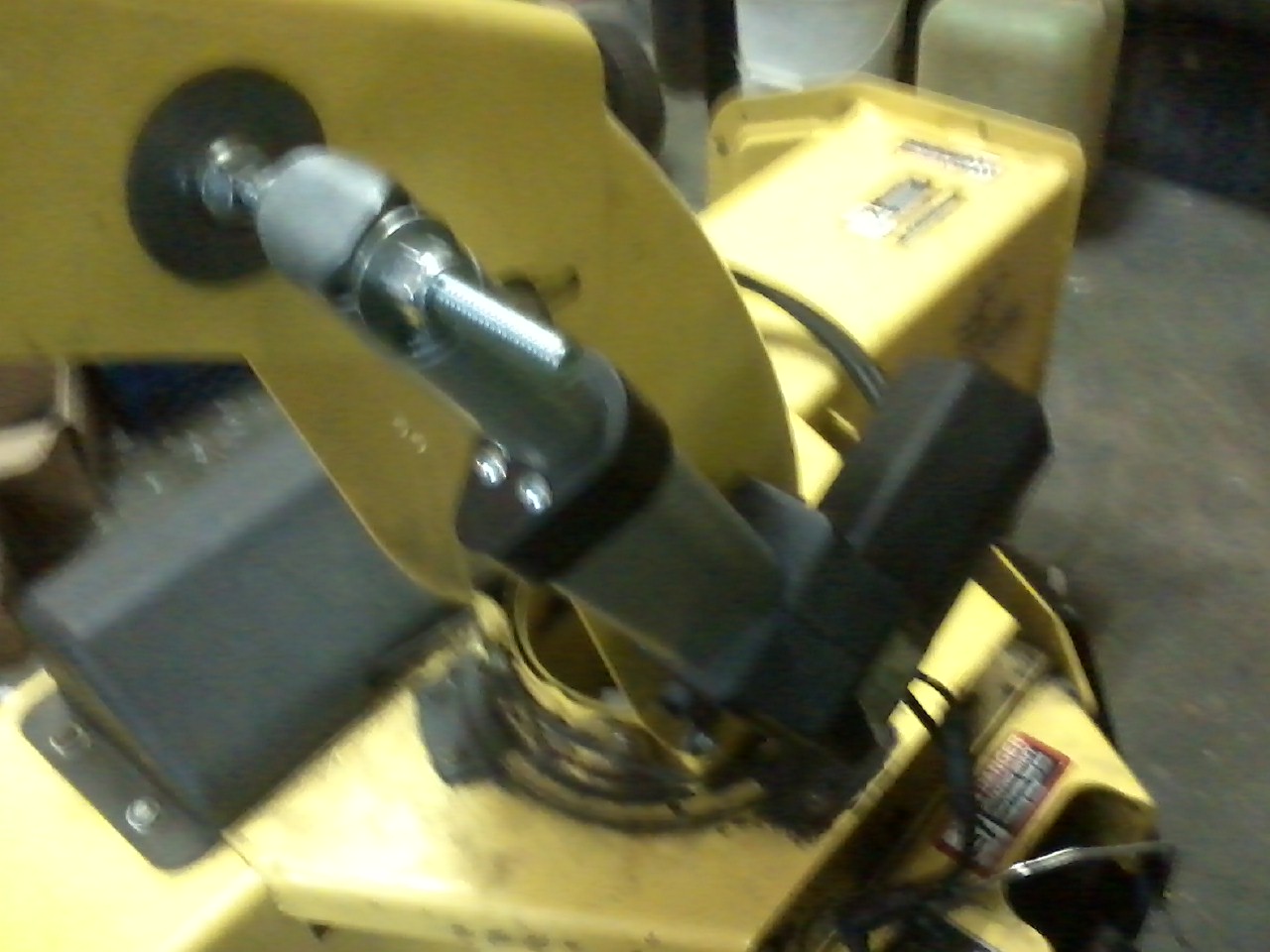

   / 72" John Deere front mower deck #7
it works wiyh a little work
