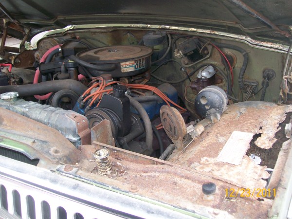

This might be a little off topic, but anyone had a 70's Jeep pickup with the AMC 360/3 speed combo. I have a chance to pick one up for $800.00. 5 new tires, and the front end was rebuilt 5 years ago. Only problem is I have to fix the frame under the cab, it rotted thru where the boxed portion is tucked into the c channel of the main frame. Thought it would make a good woods firewood chase truck, and maybe a good plow truck if I can plate the frame correctly and feel confident.

Well, I bought it. Had Ma chase me down there with the truck and trailer, because I didn't think I'd be able to drive her home. Turns out, the frame is rotted thru, but has been fixed already. Massive C channel repair, will outlast the truck. Brakes were done when the front end was rebuilt. 5 new (can't be more than 1,000 miles on em) 6ply Firestone transforce tires. Floor was replaced, and new rubber floor cover. 2HI to 4HI is easy, but can't get her to go to 4LO. U shaped t case shift pattern, any Ideas where to start with that. Drove her home 140 miles, no issues, other than a persistent u joint rattle when you let off, and get back on. Sounds like it is after the t case. If not the u joint, I would assume it is slop in the chain in the t case. Stout little truck, and I don't think too bad a deal for the money, heck, sell the tires, scrap the truck and come out even. Can take my hands off the wheel at 65, and she goes down the road dead straight.

We'll see how good after I pull the transmission this weekend. The rattle I was hearing has turned into a constant sound like a mis aligned gear, or really sloppy chain going around a worn pully. It is there when the clutch is engaged whether the trans is in neutral, or in gear. I would assume since it is there when the transmission is in neutral, It has to be clutch or on the input shaft of the transmission, cannot be the t-case. U joints were shot, replaced them yesterday.

Here's some info on the T18 trans in your truck The Borg-Warner T18 & T19 Transmissions - Novak Conversions and a link to their rebuild page Parts for the T18 & T19 Transmissions. The company is well known in the four wheeling world for transmission and transfer case conversions. If you don't find something obviously wrong when you get it apart I'd give them a call and see what they say.
