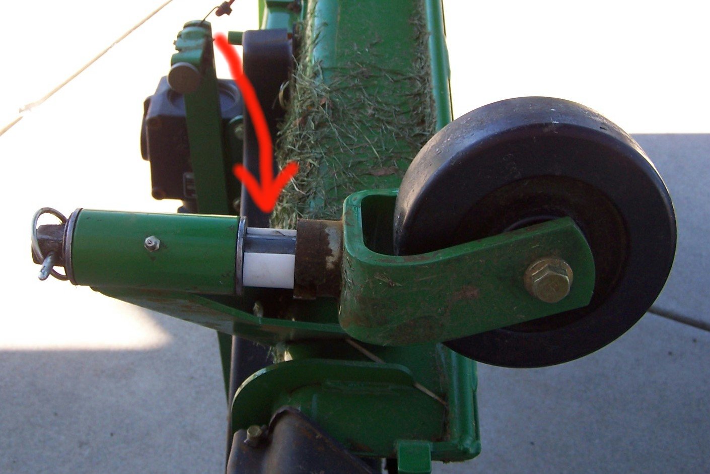

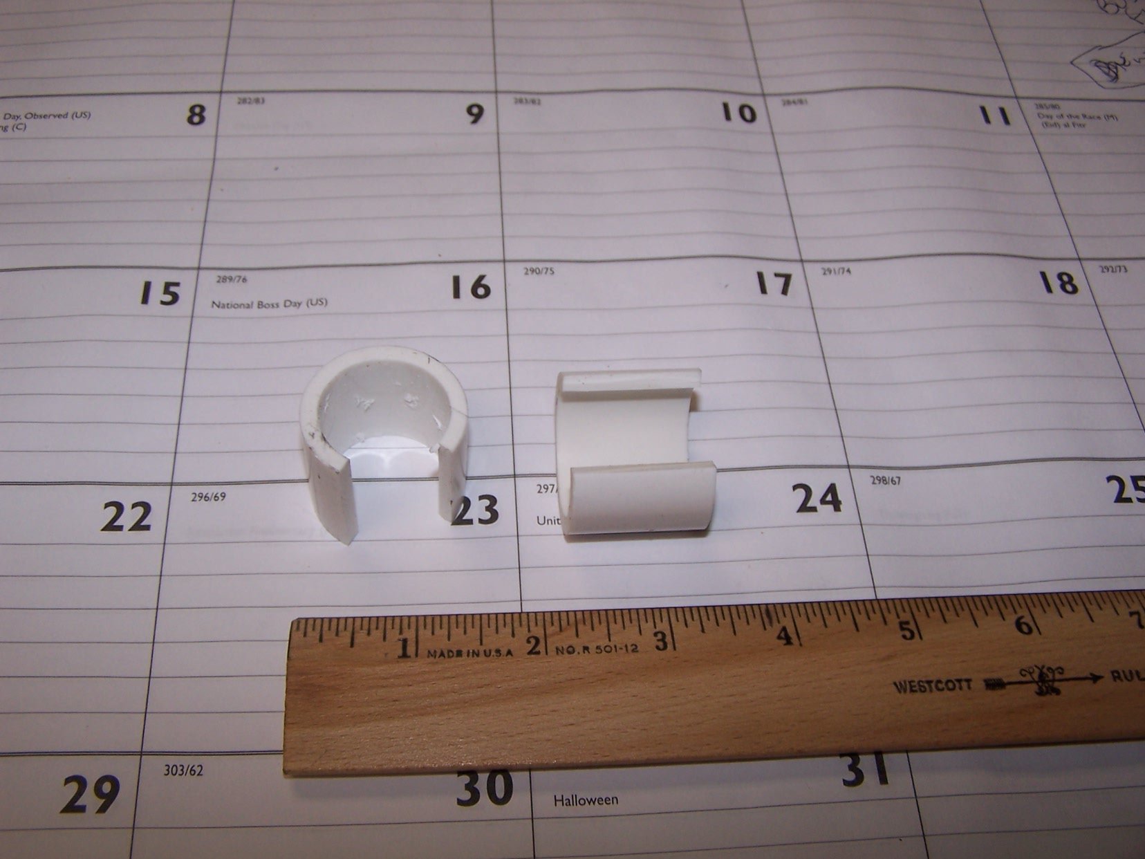

The most cumbersome part of removing this mower deck, in my opinion, is lowering the front anti-scalp wheels. In order to do this, you have to put the two spacers that are above the carrier under it. In order to do that, the wheels have to be removed completely from the carriers. And you can't do that very easily, because the deck does not lift high enough. I did find ways to do it, but it seemed harder than it should be.
My solution was to cut a couple spacers from schedule 40 PVC pipe. This stuff is 1 1/4" OD. I cut it to be about as long as the two spacers stacked together, and cut a notch lengthwise. Now I just remove the two upper spacers, lower the gauge wheels and install these spacers below the carrier. Viola! Much easier.
The attached photos do a better job of describing this than I do.
PS: I use the moweraxle.com storage wheels on this deck, and they work great.

Cool! Looks like a $10.00 "custom" part on Ebay to me:D
