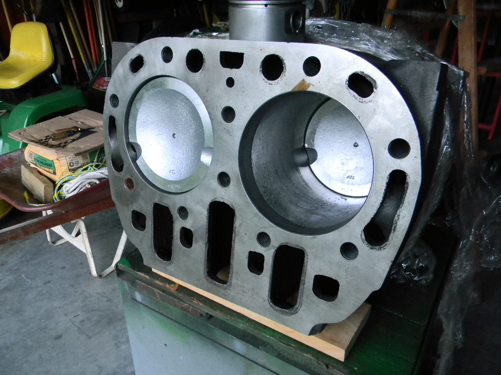

Tractor is stripped down and next days off will pull the cylinder case and pistons.Once I figure out how to post pictures will do just that. 70 JD  Conn.jpg

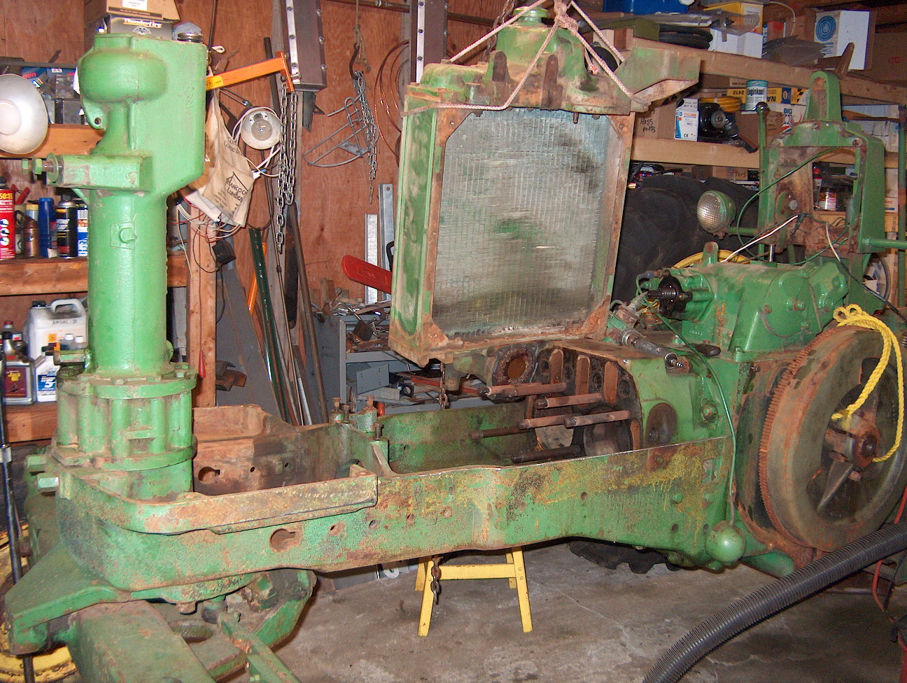

Will have to wait until spring to change crankshaft too cold in shop where tractor sits.In the meantime all the parts off so far are in the reconditioning loop.Have over half of them looking brand new stripped off all the old paint refurbish then fresh paint.Doing the pain in the neck stuff all the steel tubing for power steering and PowerTrol,throttle rods,all the big bolts and nuts.
Brake adjusters on both sides are frozen, and a couple of broken bolts to mess with.Oh how we enjoy the resto projects,the wife says I'd rather be doing this part than driving them.She is half right.
Gotta say also very few of the parts on this tractor can be lifted by hand most need chain jacks.

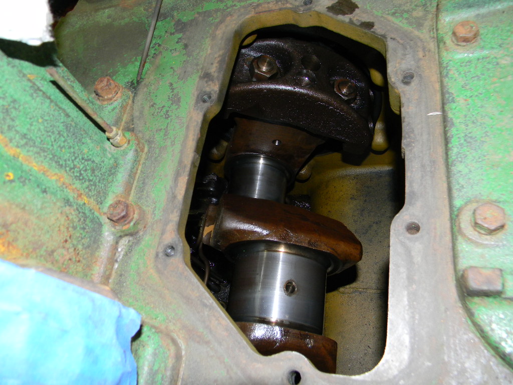

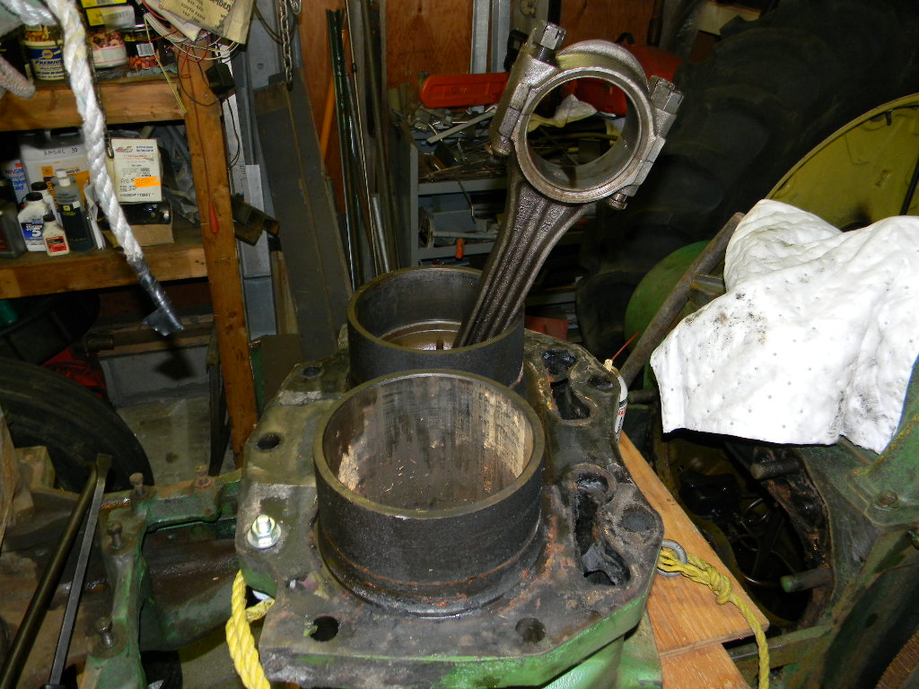

Tried attaching a few pictures
