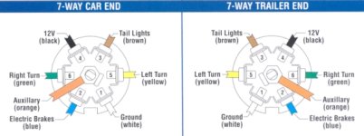

My trailer for towing the tractor is wired with a 7 pin connector. My truck has the corresponding connector.
I want to check the status of the emergency battery.
Also, I bought my dad a 7pin to 4pin adapter so he could tow the trailer (empty of course). We store it in the barn in Maine over the winter, saved me a trip to go get it. When he hooked it up, he had stop & turn lights, but no tail lights.
I found a diagram on the web (see attached), but can't tell if the diagram is from the front or rear of the connector - ie if you unplugged it at looked at the side that mates with the other connector.
If anybody could tell me which way the diagram is drawn from, it would greatly speed up my troubleshooting time.

It is drawn viewing the wiring end of the connectors.

You may or may not have 12v feeding into the trailer plug, check at the truck's receptical for power at the 12v term. Check for voltage at the trailer plug, this will tell you if a wire has been run to the Breakaway battery. Do you have a 12v "Charger" mounted on the trailer? If you do you may not be able to read a voltage at the trailer plug due to the charger's circuitry preventing "backflow". Check for voltage at the battery in any case.
Don't pull the safety pin on the trailer tongue with the trailer plug installed into the vehicle. It ruins most trailer controlers. You might think about using the center term-"AUX", for maybe backup lamps, etc. The other posters responded well on the other terminal pinout question.

I poked around a bit last night
Lights work fine & are wired to correct pins. (must be a problem with Dad's truck or connector)
No 12V at truck connector
No voltage at Trailer connector
Battery voltage measured at crimped connectors 7.75V. I didn't get the cover off the battery - wifey called me in for dinner.
As far as I can tell, I don't have a charger mounted on the trailer.
What voltage is the battery supposed to be? I plan on opening up the case tonight.

Thats not right. You should see 12.5- 14.5v at battery depending on load and charging system. Check for corrosion in connectors and check ground side connections.
