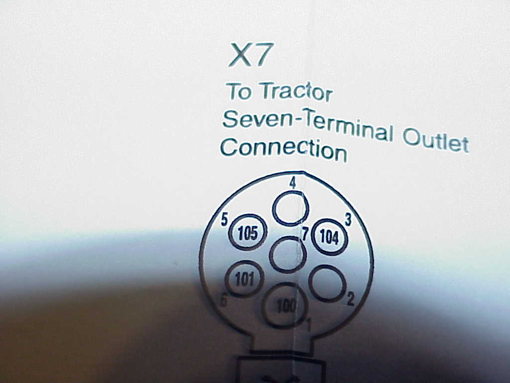

How do you install the 7 pin male plug on the 566 round baler to hook up the Hazzard lights? I found 2 wires in the wire harness that are not hooked up but I expected there would be more. I also don't know if those wires are the right wires anyway and the manual is no help.

I can't find the 7 way on the baler, not even anything that looks like it was tore off. The 2 wires I found according to the schematic appears to be a power and neutral wire. I have not been able to explore any further yet as I've been too busy but hopefully tomorrow I'll have time.

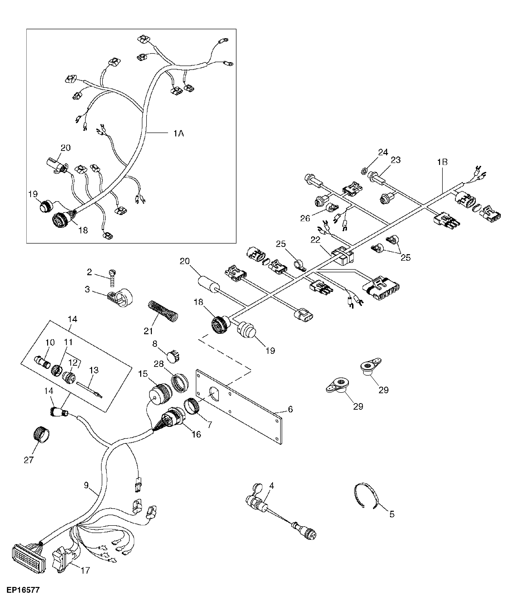

On your baler it sounds as if male elect connector(parts key 20) assembly has disappeared. JD male plug is the same as Petersons 5407P plug.

I can't find where it should have actually connected into the wire harness. All the wires are in flexible conduit so to trace everything is going to require considerable time. Do you know how or where the 7 pin plug was suppose to tie into the harness? I don't know anyone local with a baler like this to look over. I'm going to be at the Deere dealer tomorrow so I hope to know what I will need to get the lights working but at least it isn't anything that will keep me out of the field.

Here's photos of traffic warning lights connection from my 467 OM.
HTH's,Jim
