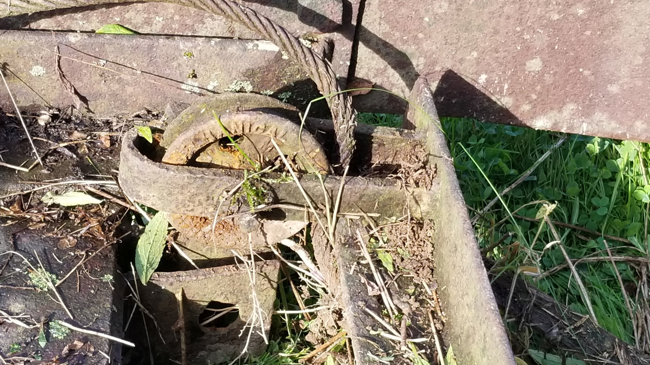

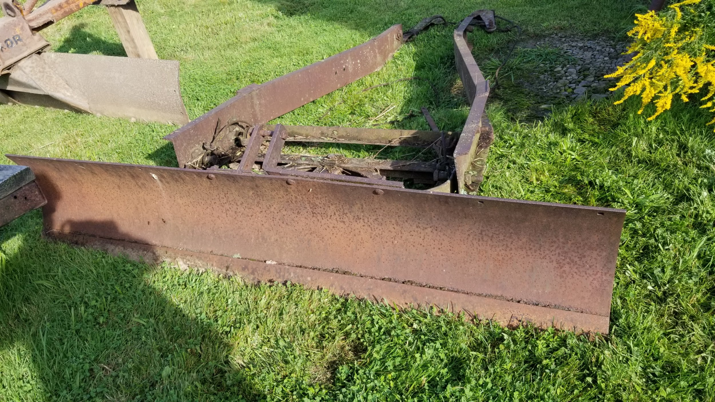

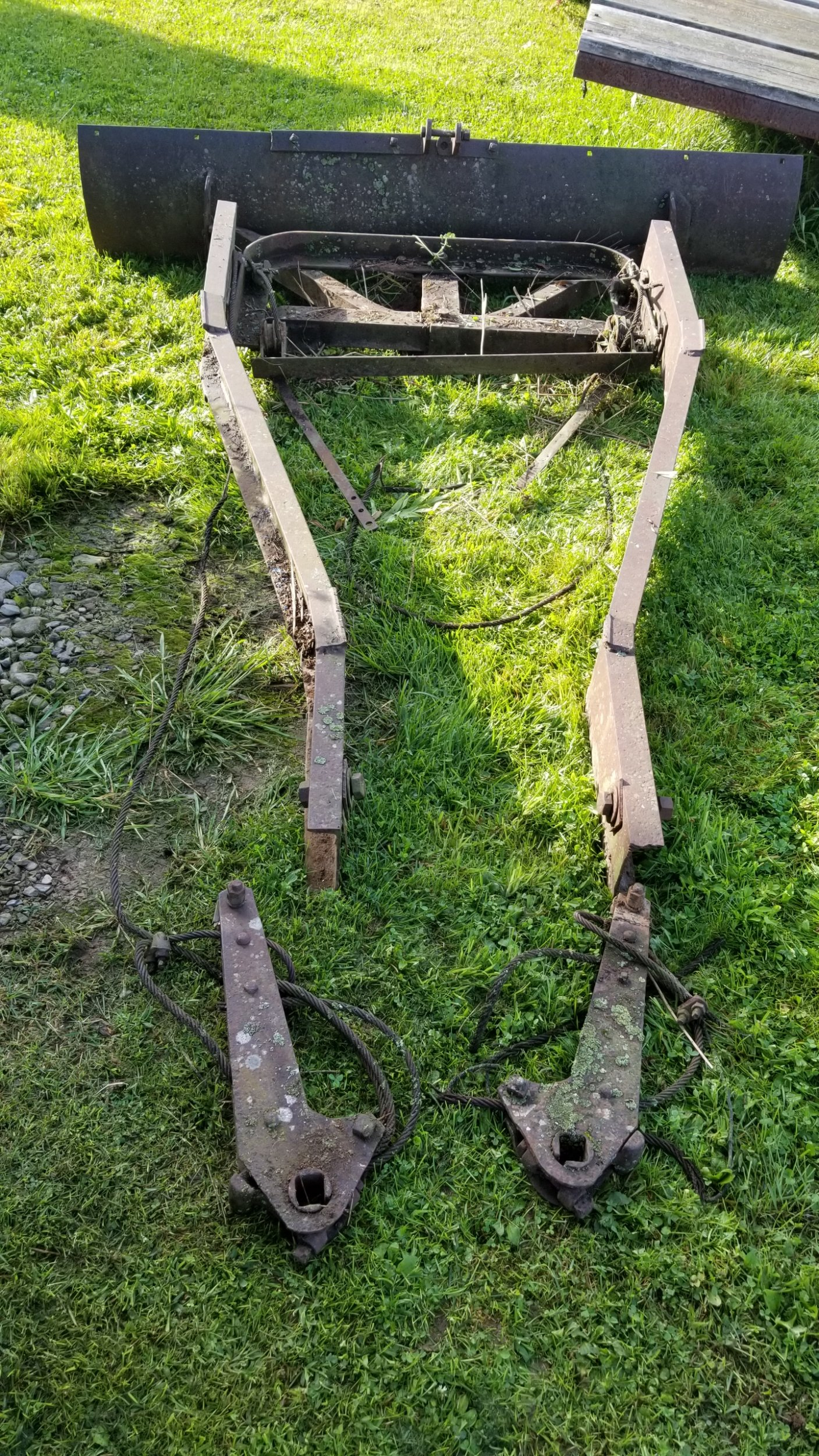

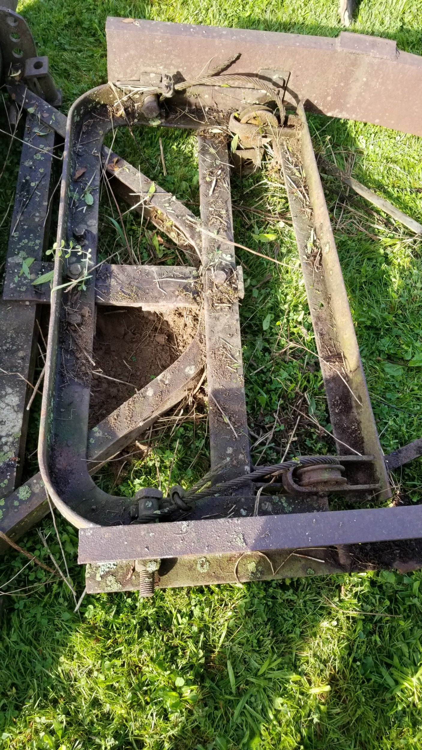

Pulled this blade out of the weeds behind our barn. I can only assume that it's for the front of a tractor and somehow hooks up underneath towards the back but then has cables that maybe go back to the 3 pt hitch to move it up and down?
Can anyone tell me about it? What it's called? What it would have gone on, if it looks complete? On the one pulley you can make out "mechanical" we think.
It's a 7' wide blade, back of frame to top of blade is about 8' long and inside the frame all the way at the back is about 17". I'm looking to post it for sale so if you have any thoughts on pricing, that'd be welcomed too!
thanks!

That looks like a Dearborn 19-2 dozer blade except the frame on them was pipe, not channel. I am sure Ford was not the only one to have made blades like that. As for price that wholly depends on the person wanting one, a collector maybe if you could luck onto one but scrap most likely is its value.
