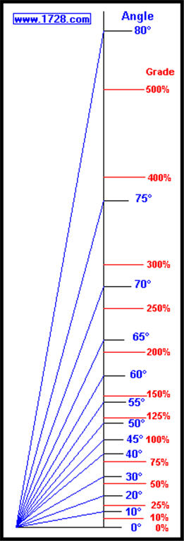

Here are my sideways hill pictures, on a 27 degree slope. The hanging chain and tow rope show 90 degrees.
