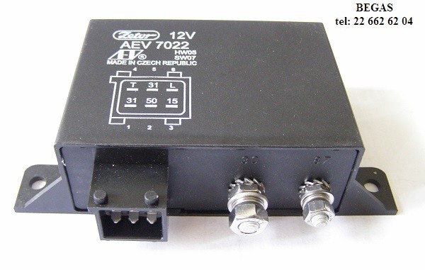

If your glow-relay is a AEV 7022 like in the picture, than the connectors with the nuts (30 and 87) should be + from battery and glow plugs.
You can click on the image to enlarge.
In the 6 prong plug, I think not sure!,
T from temperature gauge
31 ground
L glow light
31 ground
50 from ignition, maybe position 1
15 battery + from ignition switch.
You can try to "probe" the plug at the back while connected to find out what is going on.
