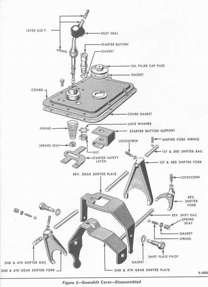

If the 640 uses the same thumb switch on the tranny cover as my 8N and NAA, then yes it is replaceable.. you have to pull the tranny cover though.. watch for a small ball and spring when you pull the cover. The switch can be had from tractor supply.

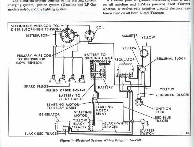

However, the other poster was correct. the thumb switch only provides a connection to ground. The oem 6v 3 terminal starter solenoid is internally hot, assuming you hooked it up correctly, I.e. with the small terminal pointed at the tractor.. not pointed out where you can get to it easier. When you hit the thumb switch you are grounding the small terminal.
That makes it easy to test with a jumper wire from ground to the third terminal.
If you have a newer style relay say a 4postone.. if it is an isolated one.. you can still make it work... 1 post to power ( whatever polarity you are using.. probably - if it is still a 6v+grnd ) the other post to the thumb switch that completes the circuit when you push it. Keep in mind that the thumb switch is neutral safety interlocked, meaning it will only function when the tranny is in neutral.

Well, Kirt, when you logon again I think you will have all the info you need to find your problem. At least, I hope so. Between me and Soundguy, we will ensure you have a case of information overload. /forums/images/graemlins/laugh.gif Anyhow, I've got three attachments to help you out and the first one is a schematic of your electrical system attached to this message.

Transmission cover assy. with starter switch.
