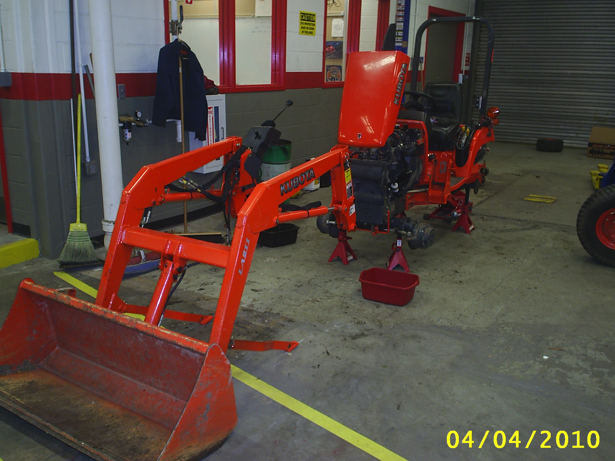

Took my BX2230 to school (I teach Automotive Technology) to get it ready for winter, took off the mower deck, took the loader off to clean and lube all the joints, took off the front housing to repair the broken air cleaner bracket, the students changed the oil, changed the HST fluid and filter, I removed the screen filter and cleaned it, I also put in a 4mm shim in the relief valve, also changed the anti-freeze, we cleaned everything we could, removed lots of dirt and leaves, took off the wheels and cleaned and painted some spots on the frame, added my hood decal also, it was made by students in our engineering class, its a copy of my grandfathers company logo from the 50's, also added a 12v accessory port, should be ready for whatever we get this winter !

Almost looks show room condition..kinda surprise student didn't want get little dirt under finger nails.
