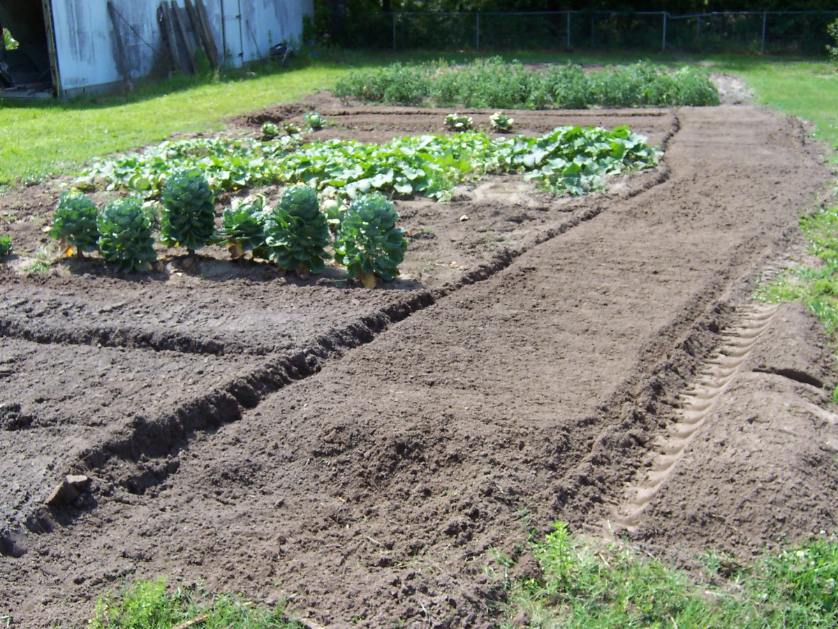

I bought a 4'er last weekend and had no problems getting the hang of it. They are pretty straight forward. I have my skids set all the way up for more penetration. I had some horse squeeze aging and put it in my garden and the tiller really blended it in with the soil. My soil came out almost like saw dust, the tiller does that good of a job.
