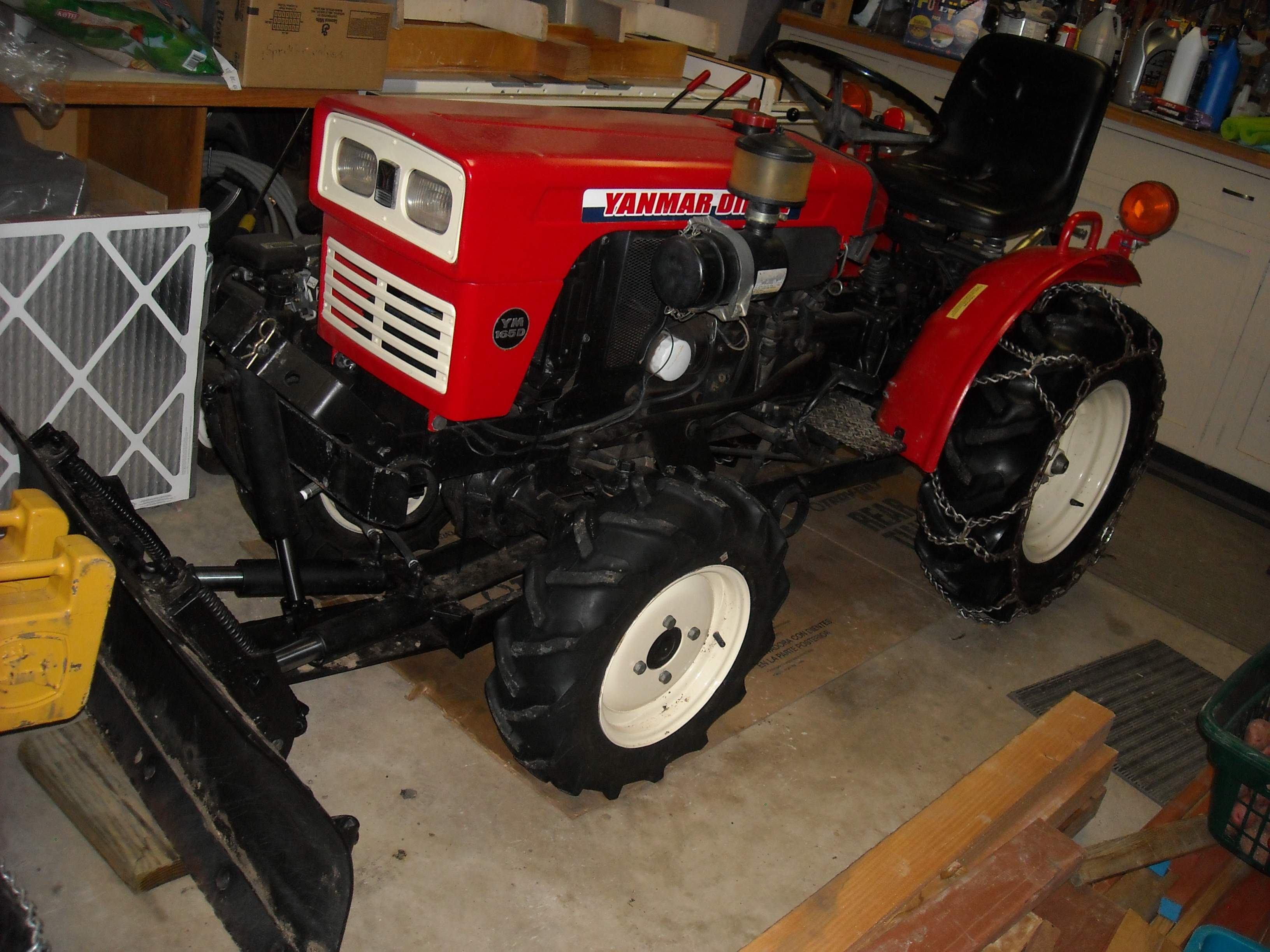

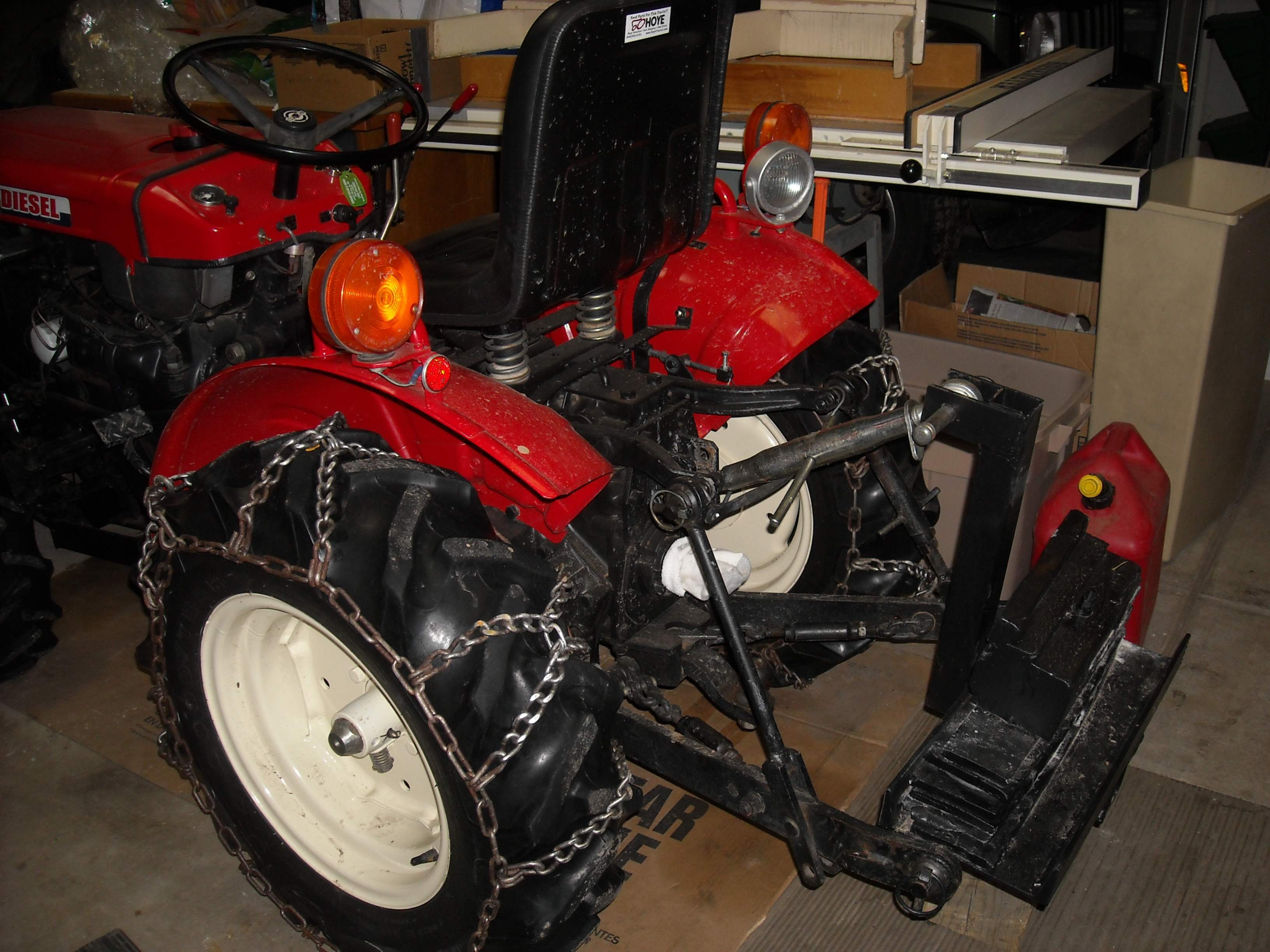

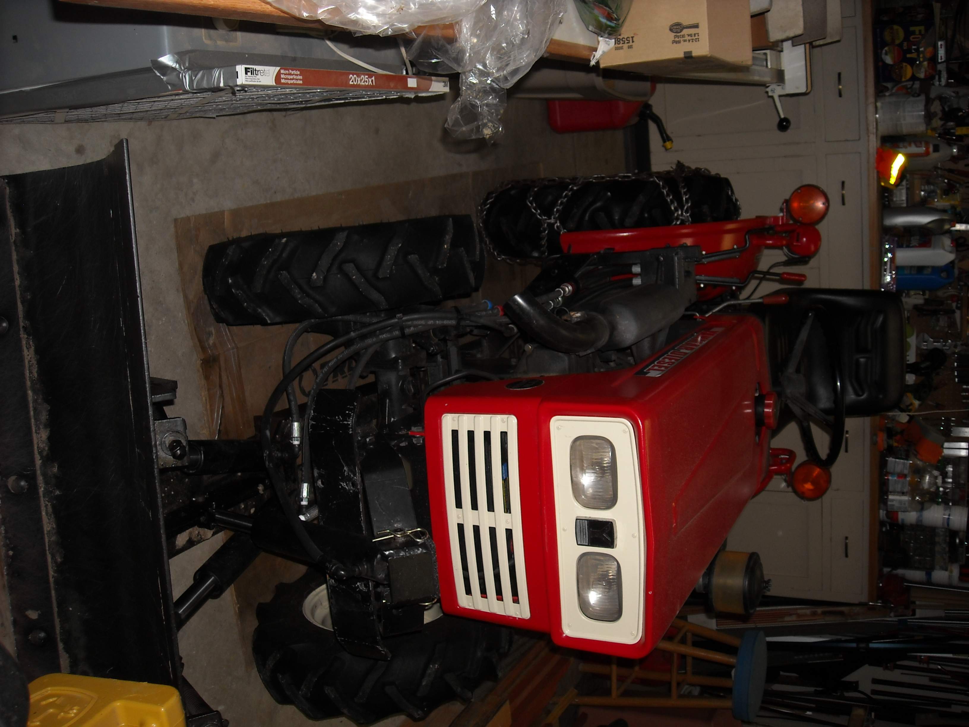

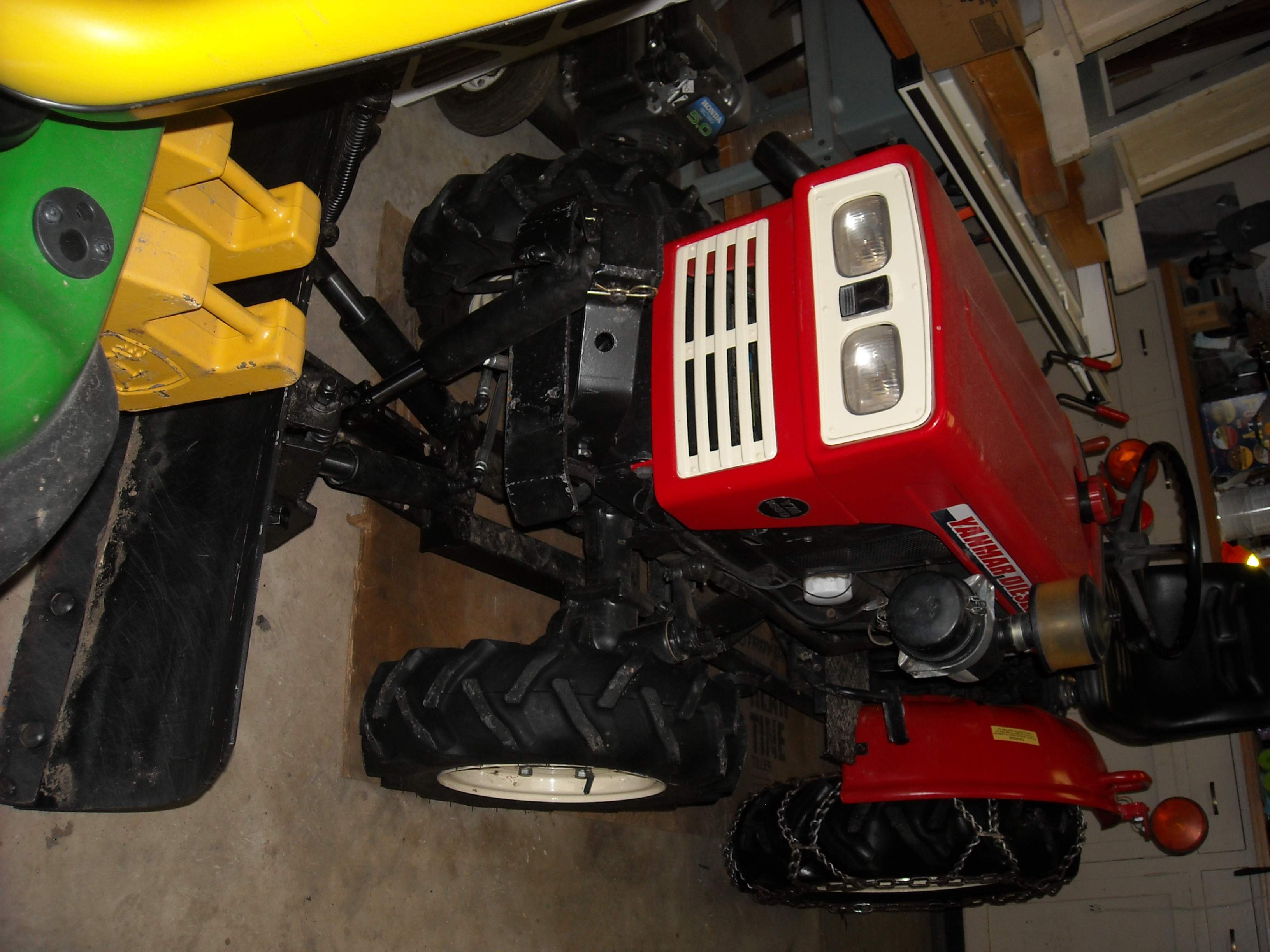

Here are some pics of my yanmar plow

   / 60'' snow blade ? #9
sorry that I did'nt get back right away I was working.The snow plow was manufactured for yanmar .I'm the second owner,my neighbor bought it new in the early 1980's,it's a YFDH-155 dozer on a ym165d.This has hydraulic left & right and up/down.This year I installed quick disconnects on the hyd. so I can drop the plow Pete
