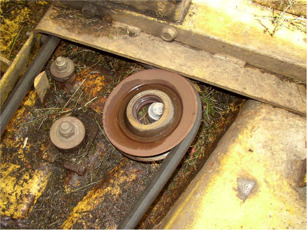

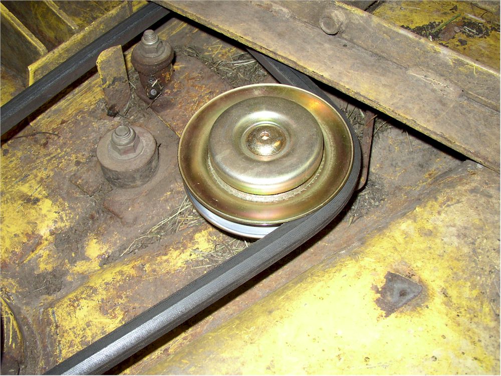

   / 60" mmm rattling noise #5
Mine had a rattle one time. It was a pulley bearing that broke while the deck continued to cut grass. The pulley was an idler and it continued to spin with the belt, but with the bearing gone it spun on the attachment bolt. I never did find the pieces of the bearing. Had to replace both the pulley and the bolt. While attaching the new pulley I could tell one more piece to hold the top of the bearing was needed that was not shown on the JD parts drawing. The dealer agreed and ordered that additional part for me at no charge. It was the same piece as used on the bottom. The new pulley and attaching parts was a new design different from what my deck originally had.
