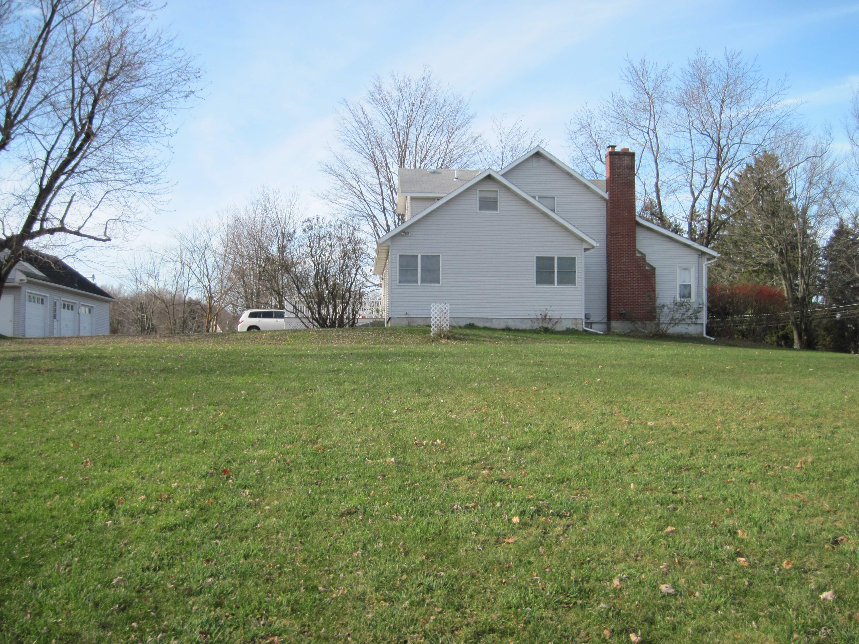

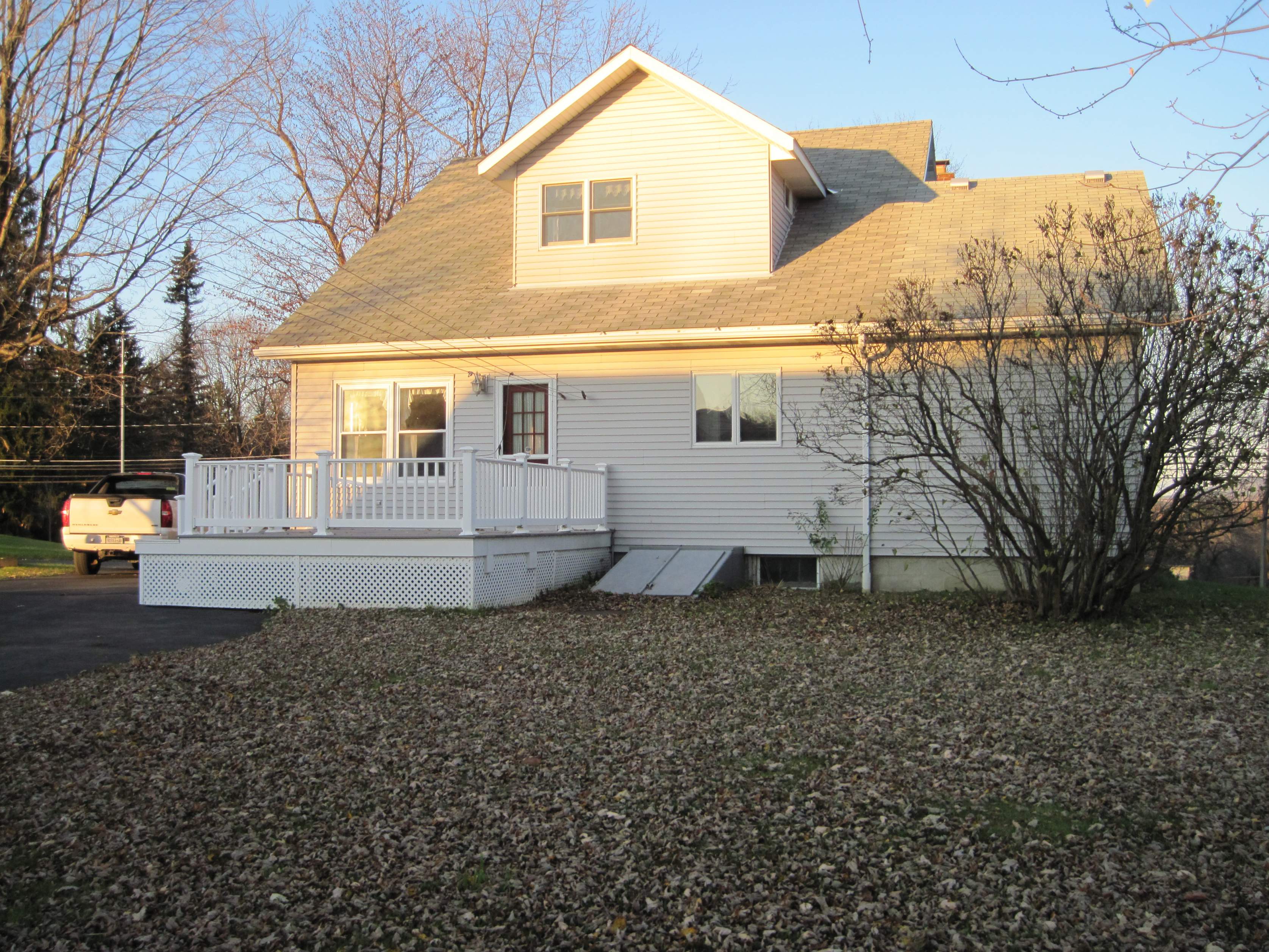

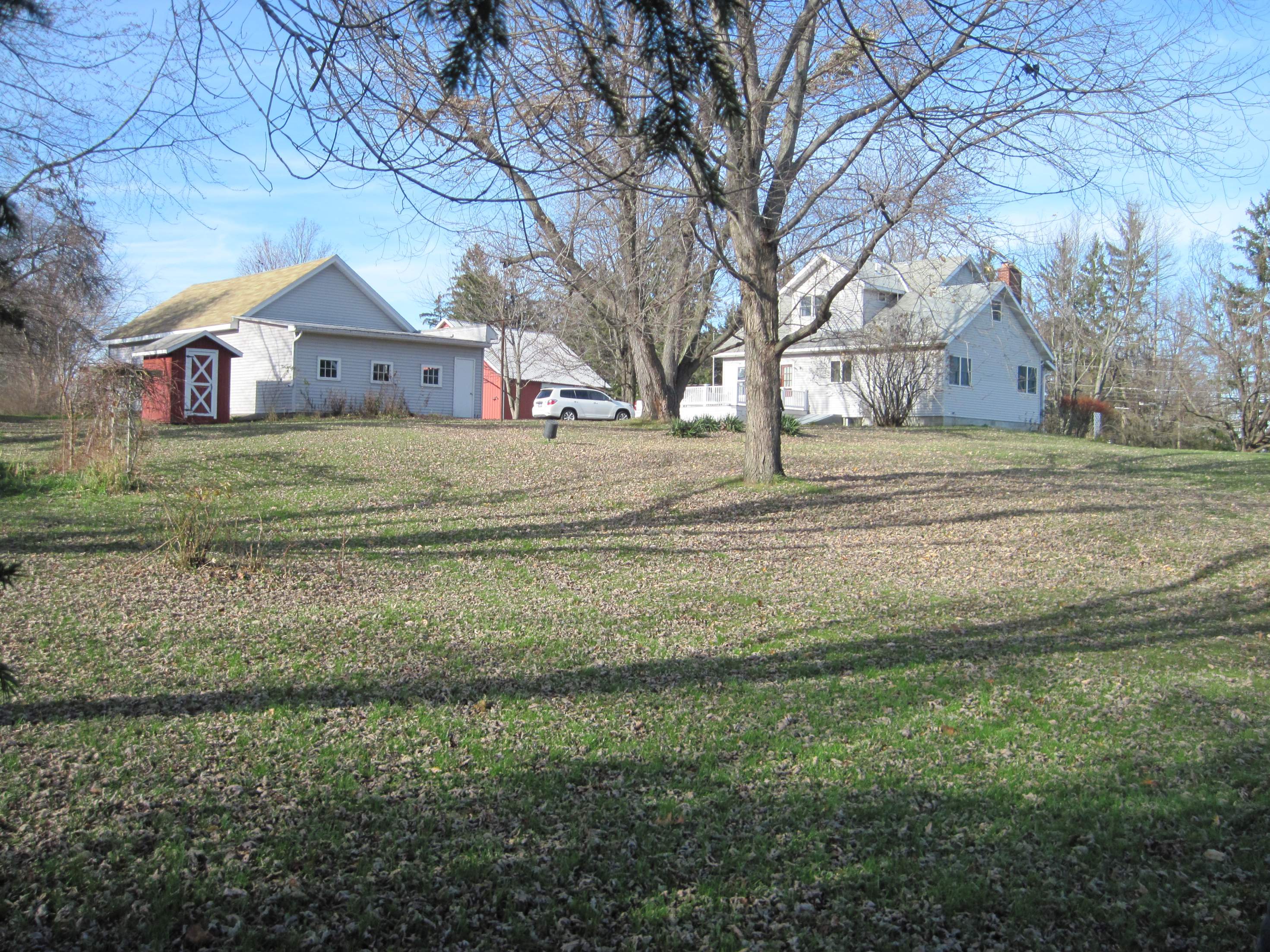

1. Should I be trying to swap the dealer the used 60" for a used 72",
(with extra money, of cour$e), based on the pics you see here, and our intended usage, i.e., to put in a garden, thus decreasing our mowing requirements?

2. b) Much of our land is on a variety of gentle slopes, and some not gentle enough for a CUT, which are POORLY-portrayed by these four pics, below. I wasn't sure if the 72" would cause more "scalping," and/or if we just don't have the room to require the bigger mower, as I suspect?
Also, we have a barn, (the approaches to which I realize are too steep and so we'll either need a powered walk-behind mower, or a small rider), a large garage, two or three out-buildings and more trees than I realized, along the road (sorry, no pics there). We also plan to convert perhaps 1/4 to 1/2 acre (of the 1.8 acres) to veggie gardens, health-permitting (please knock on REAL wood for me, three times--thanks:thumbsup: ).

60" vs. 72" - how level is your yard? I would only get the 72" if it's super flat and smooth. 72" does stick out and you might hit stuff with it. As for the RFM, true she might hit a few things, it's a learning process... If you have many trees, I would go this route. You can back the mower under branches.
If you have a cab, I would be trimming the trees up to make sure you can not hit one.

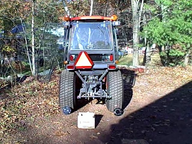

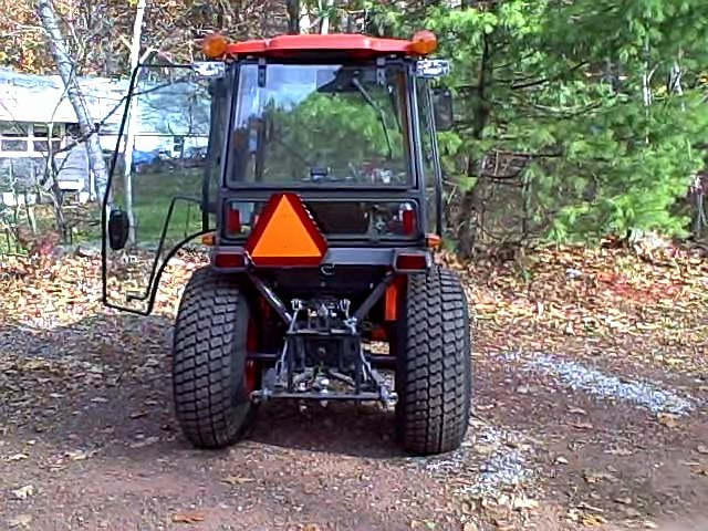

My,
Don't know if this helps, but here's a few pics of what spacers did for my B3030.

Well, I don't own the belly mower for my B3030, but I'll make a couple comments anyway.
If you are putting the 70X or 80X on your tractor (the subframe is the same for both), you will NEED, not want the rear wheel spacers. I'll post a couple pictures from when I installed mine. The two pics are before the spacers were installed, and I had in fact already ground down the mounting pins (bolts actually) to shorten them as much as possible. Though they were not touching the tire when the tractor was sitting still, driving over uneven terrain made the tires rub on the end of the pins..... you will see the wear on the tire in the second pic. The wheel spacers add more than enough space to cure the problem, as well as adding alot of stability. I do not recall anyone on this forum having mower clearance problems with wheel spacers, regardless of what Kubota claims.... but do your own research.
As someone who already has an 80X on my cabbed 3030, I recommend that you go with a 70X. Because the cabbed version of the subframe moves the hoe back six inches, it makes it that much heavier on your tractor. If I head up even the slightest incline, the front of the tractor gets so light that you can't steer. The average Joe won't see the difference in digging ability between the 70 and 80. The 70X is just a better match for the tractor.
With the mowers..... if you are concerned about lifting, put the belly mower on CraigsList and buy a rear mower. With my rear mower, there is no tugging or lifting. Disconnect it and roll it into the corner. Mounting two ATV winches in your garage is creating more problems than it is worth. Teg is right, the tail-swing of a rear mower is something you get used to quickly....... and the ability to back under obstacles is actually great.
Personally, I would go with a 72" mower over a 60" with wheel spacers. This will give you a cut a little wider than the rear of the tractor and gets you closer to obstacles. Your own yard will dictate wheter one will be better than the other though..... depending on how gentle the hills are.

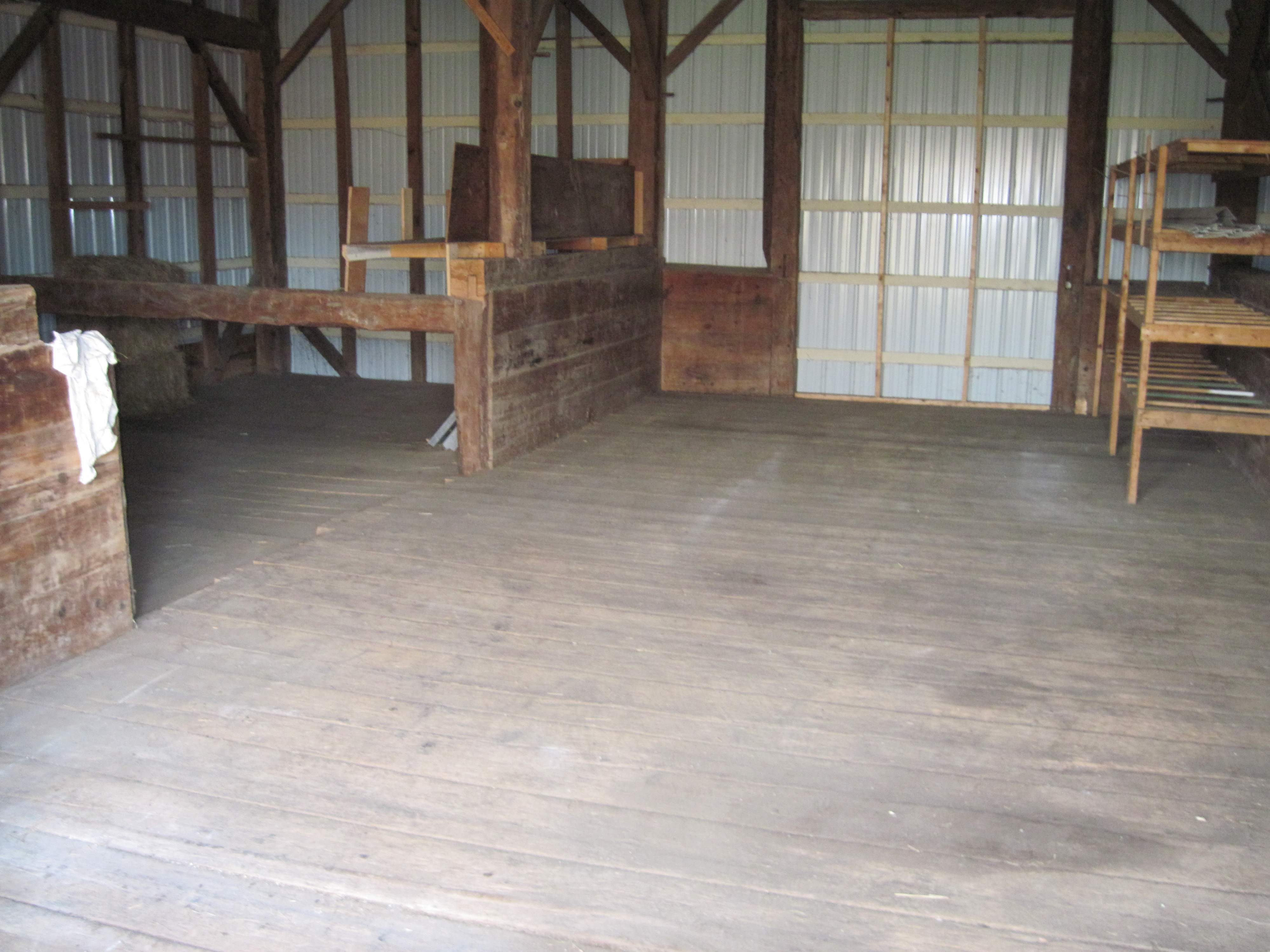

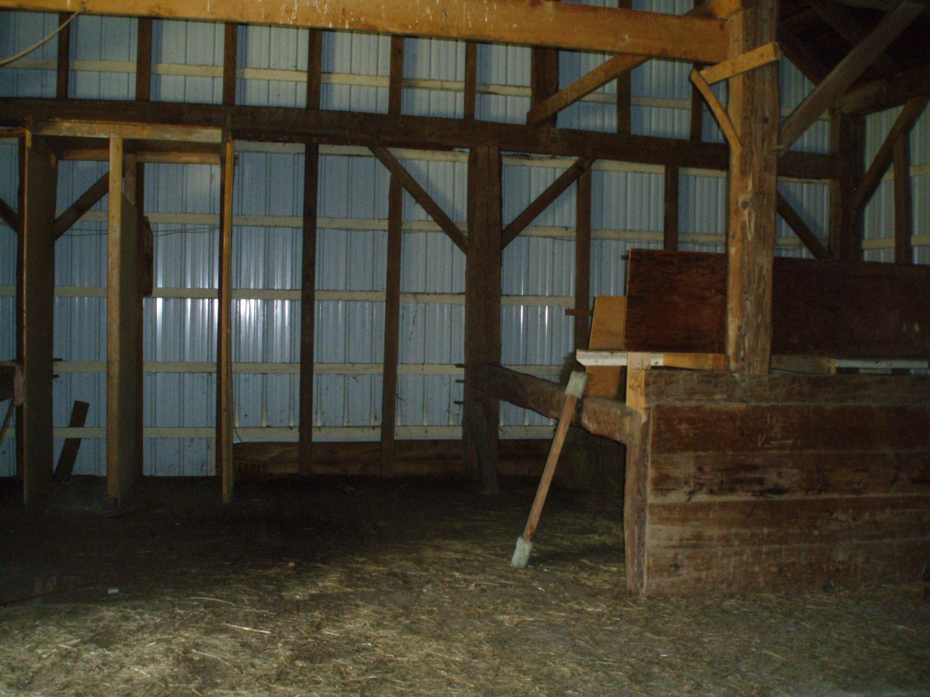

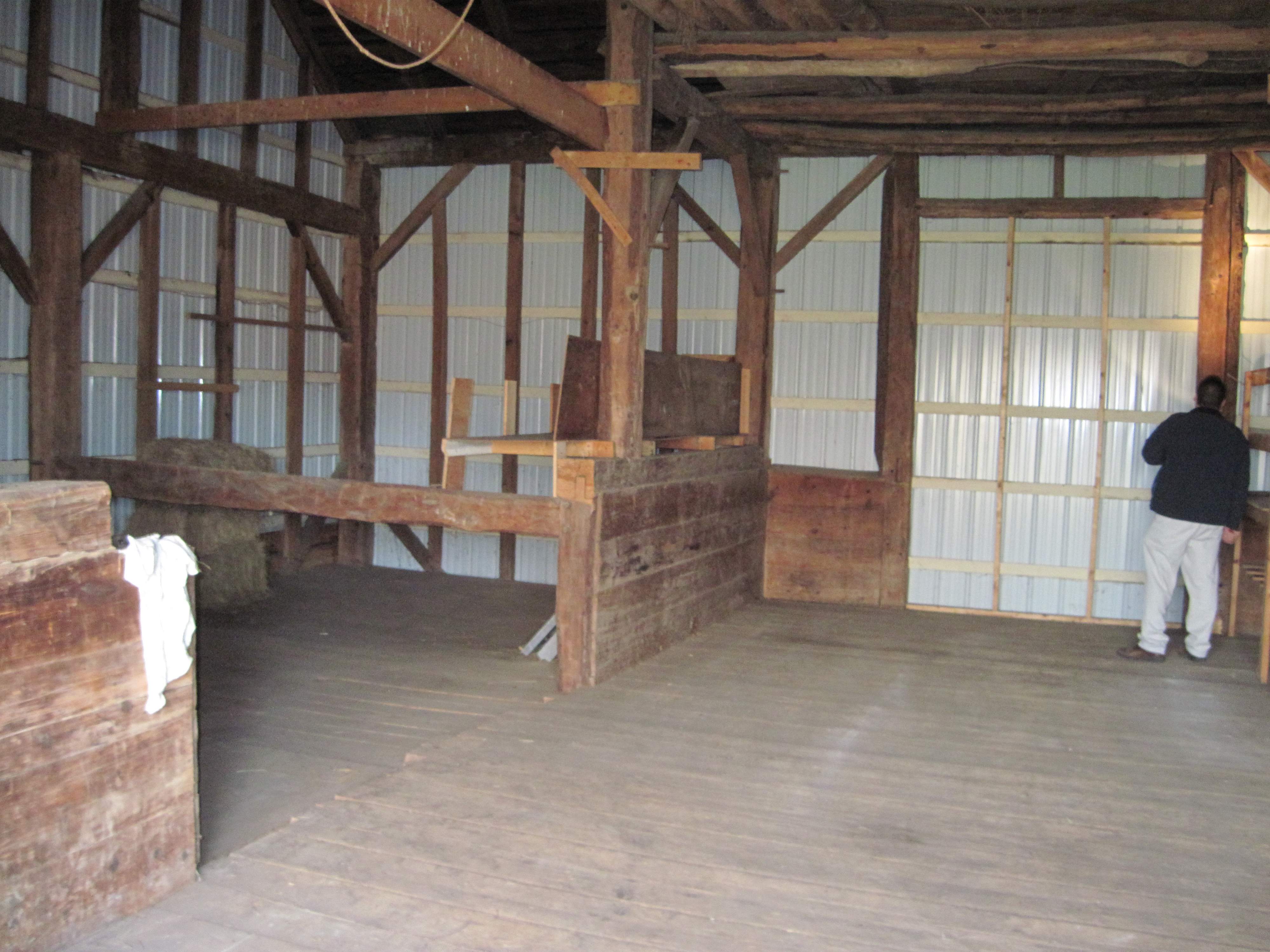

My Desire for "Seat Time" UPSTAIRS, Inside the Barn
Well, the cabbed tractor is too high to fit in, anywhere, downstairs, for one thing--LOL. Nor will it come more than partially into the 4 stall garage, even after we pay to have an old-fashioned, sliding barn door put one end of that garage, so I can at least bring stuff I want to work on, into the garage, part-way.
However, I still have hopes of driving this thing around UPSTAIRS, in the barn, to move parts and stuff around, despite the near-universal "thumbs down" I received here, on that idea. We would get a barn expert's (or structural engineer's) opinion (or two) first, of course, (as was suggested by other TBN'rs) and I like the suggestions I've been given for having a "driveway," of sorts, laid down at right angles to the original barn planking, out of "rough cut" lumber, on top of the planking. I guess I was anticipating possibly catching the mower on the edges of the rough cut lumber, and/or banging it into the edges of these "quadrants" that I hope to LIFT PARTS OVER, with the hoe, so I can use the "quadrants" as storage space, as I maneuvered around inside the barn.
That's another reason NOT to go to 72" on the mower--so thank you! See, I need to get as close as I can to these four storage areas, (I think I do, anyway) in order to fill them with items I can't lift, but need to store. So I thought I'd have to take the mower off as it would prevent me from getting as close as I otherwise could. Maybe not, though--maybe I won't have as much "inventory" as I think, :( and therefore less to store.
Oh! And also, the weight. From the rough math I was doing, I figured that the B3030HSDCC, with Woods 8' hoe and FEL, would be approx. 4,200lbs. I figured that MMM MUST add another 500lbs and, like I said, there was little enthusiasm, and much (appreciated!) caution, here on TBN, re: my plan to drive this around inside the upstairs of the barn.
However, if I do my "rough cut lumber driveway" inside, I suppose another 500lbs. wouldn't make a difference.
For those of you who sweated that marathon post about the inside of the barn (Martian, you, I know, read "every single word" so I appreciate that! :thumbsup: ), I did find two more explanatory pics of the weird, 4-quadrant division of the interior of the upstairs of the barn. See attached.
I will try to "re-find" those upstairs barn shots and attach here.
Thanks again, Teg, for your compassion, patience, and thoughtful suggestions.
Re: The Weird "Barn Quadrants":
If anyone has any idea why these were built, or what their purpose was, I'm d*** curious to know. The P.O. (a builder, who actually stripped and re-skinned this barn himself, except for the very highest regions, where I guess he had help, CUT OUT, with a chainsaw, horizontal members that actually connected these quadrants, making it impossible to even walk to the sides of the barn. (You can see the lighter wood where he chainsawed the 8" x 8" barn beams off--in fact, his cut exposes the "mortise and tenon" construction of this true "Post and Beam" construction barn, complete with the tapered, square "vampire stakes" (my term) that were pounded in to hold everything together. (I'm told this makes the barn at least 100-150 years old, but I haven't confirmed that yet.)
He put in "collar ties," above, made out of 2" x 8" or 2" x 10" planks, to replace their strength, but neither he nor I feel any more cutting of internal structural members is advisable. Especially if I want to bomb around in there, moving parts/light machines around. The P.O. parked his 3,000 lb AMC "Scrambler" JUST inside the overhead door, but he also "sistered in" two 4" x 6" beams, under the floor, and on top of the supporting beams, below, before he did so. (Ask Martian about this--he read it all. If linked you to that novella, I'd probably be excommunicated from TBN. :laughing:
