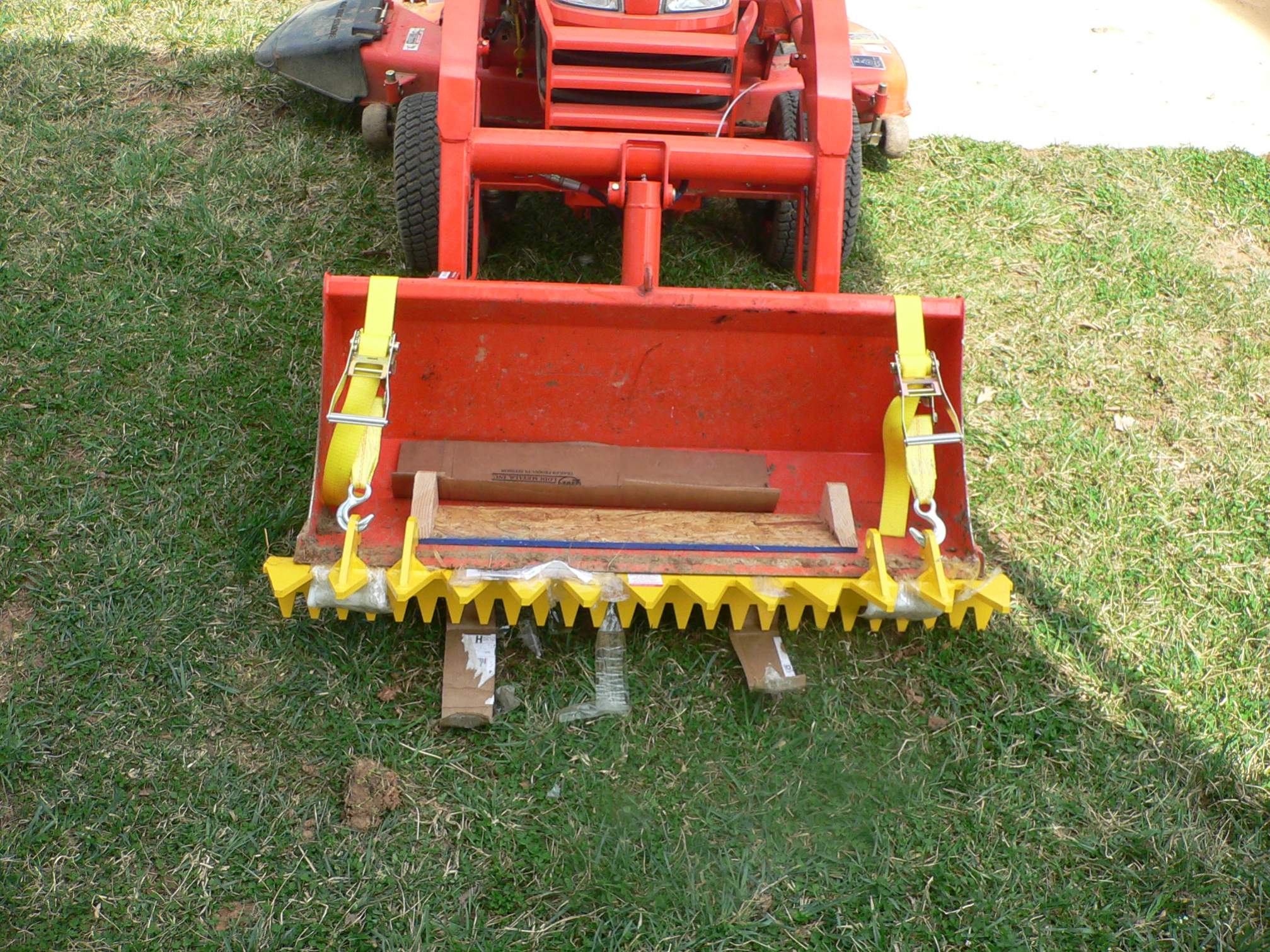

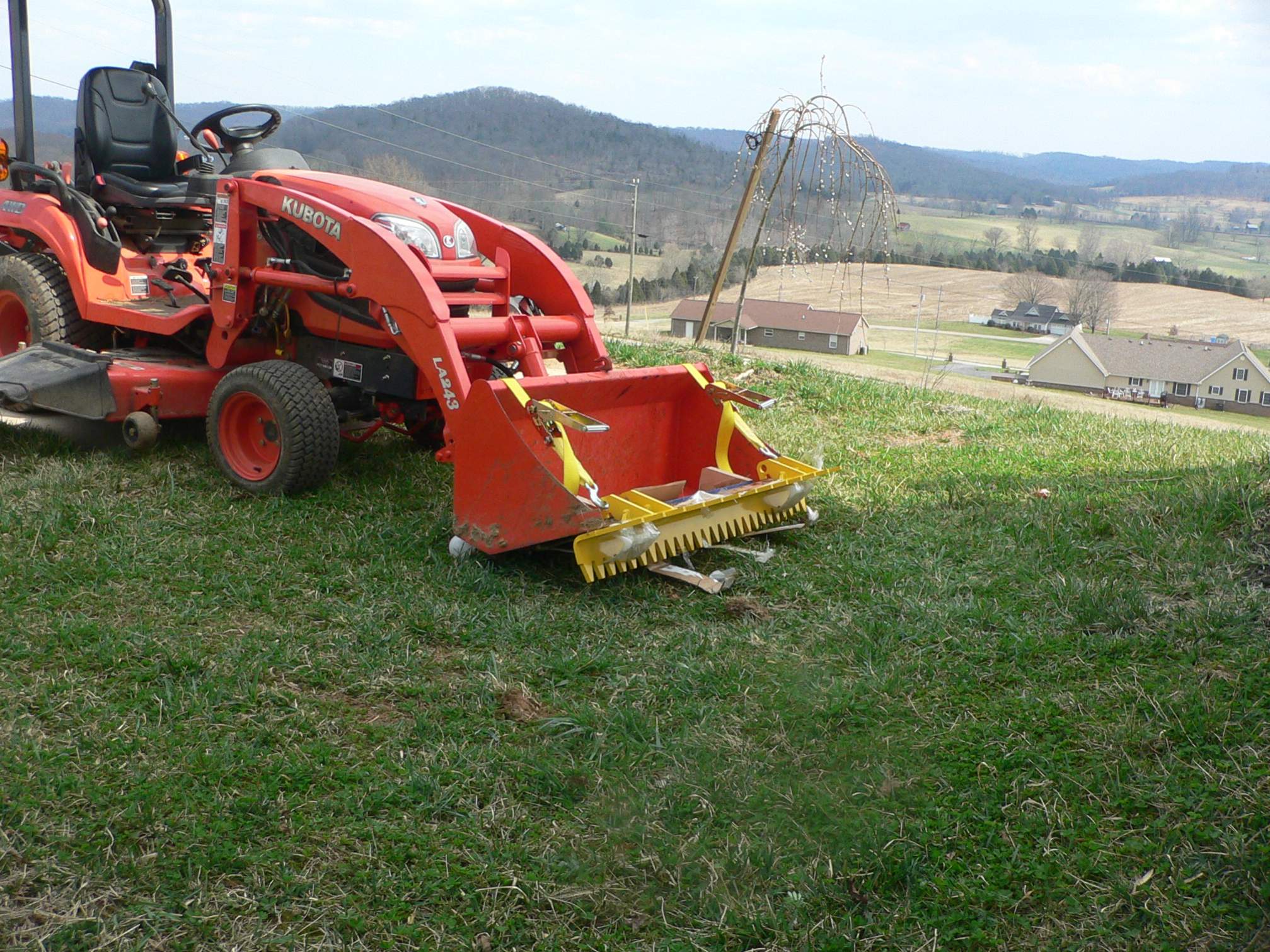

I have a tiller but if I were doing the task you mention here I would use my boxblade and then my RatchetRake. The BB will bust it up and keep it somewhat level and the RatchetRake will smooth it out to "throw the grass seed on it" point and then drive over it to press the seed in. Lot cheaper than a tiller.
