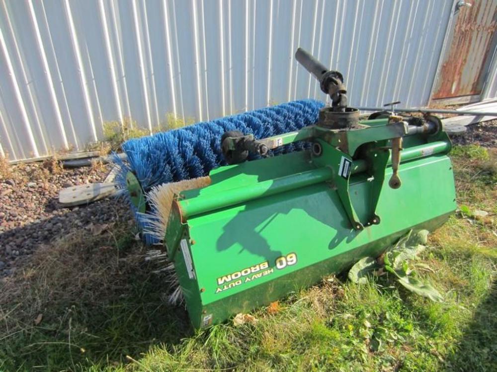

I have a 3320 with a 4000 series hitch (not A-frame style) for my SB59" Snowblower.
   / 60" broom to 4000 hitch on 3320? #2
be careful here, physically you might get it to fit up,
but if the broom came off a front mount mower the pto
runs backwards from CUTS..
do you know what that broom was mounted on before?

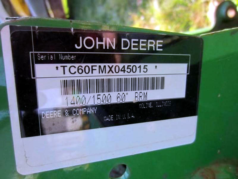

Good point! Does this pic tell you anything about whether or not it was on a cut or mower?
   / 60" broom to 4000 hitch on 3320? #4
yea, the TC tells me it's from front mount,,
plus it says right on the tag "1400-1500"
Thanks.
I won't bid on it then.
