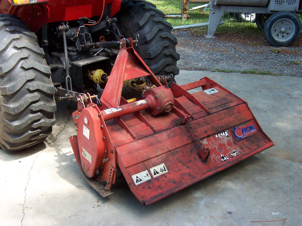

Is it a Caroni Brand? Agri-Supply sells new ones and parts. It might just need a new chain.
I bought a 4 Caroni last spring and it does a great job.

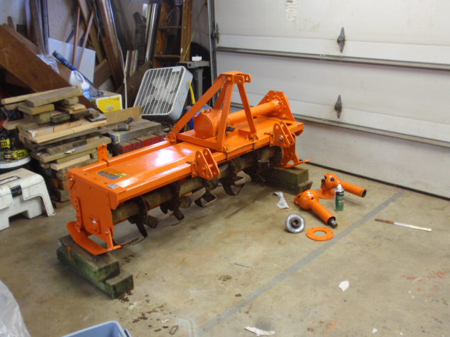

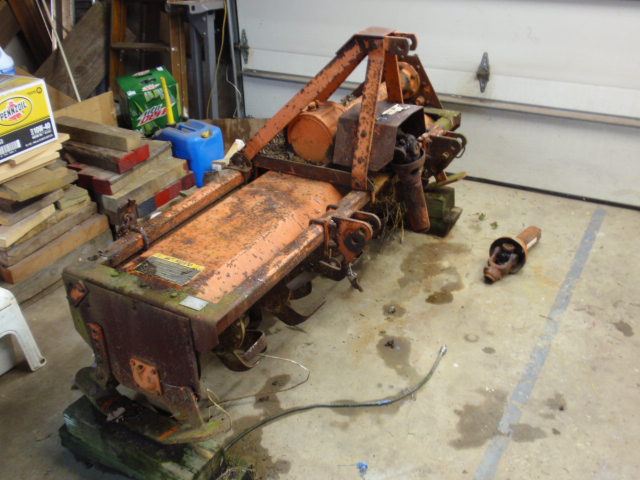

I have a Howard HX rototiller that is probably about 20 years old. The tines on it are completely worn out. It was used in sandy soil with some rocks. The sand really eats tines. It will cost me about 300+ dollars to replace all the tines. However the rototiller is in great shape here is my tiller. I repainted it and cleaned it up. Now I am saving up for blades. I would get it for as cheap as possible and then consider rebuilding it if it is cost effective if not then you have spare parts. PC230052.JPG
