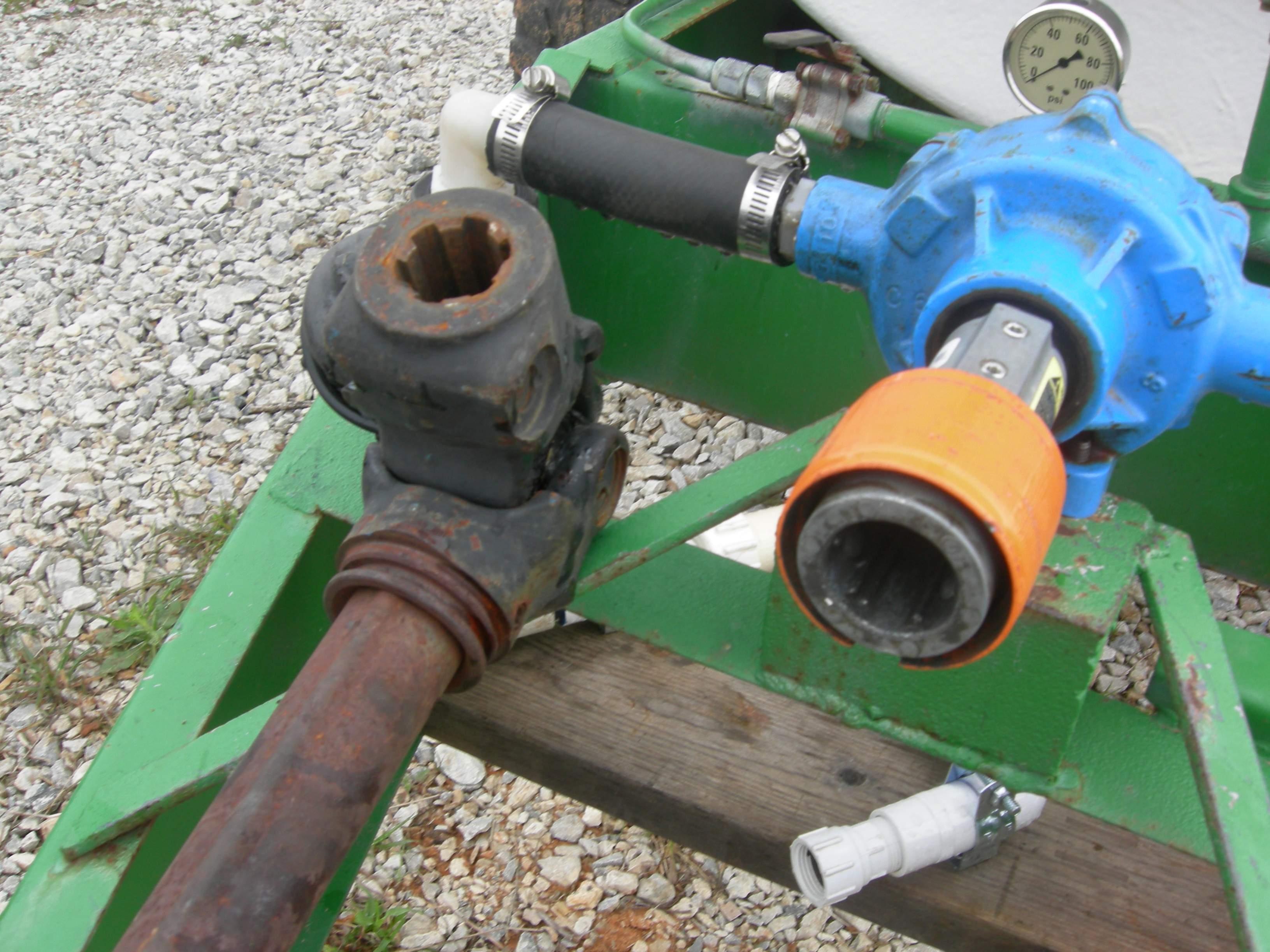

I have a Continental Belton 500 gallon spray rig I bought used. The pump was PTO [8N] mounted but the cheap stabilizer bracket bent the 2nd time I used it. I mounted the pump back onto the trailer where it was to begin with. Now the pump end of the driveline doesn't match the pump input shaft, both are splined female.
Short of buying a new driveline with a 15/16" keyed adapter [from C-B] to fit directly onto the pump, I'm looking for a 6"-8" long 6-spline shaft to use between the ends of the standard driveline and the pump splined adapter. Only thing close is 21" long and way too expensive too.
Any suggestions?

Check with the folks at www.agrisupply.com about an adapter or the cab cam dealer in michigan. they have all sorts of things ag related including propeller shaft adapters.
   / 6 spline male adapter #3
I am pretty sure surplus center sells what you are looking fore. I am not sure if you will have problems from the extra distance from the u-joint to the pump caused by the shaft and two couplers.
