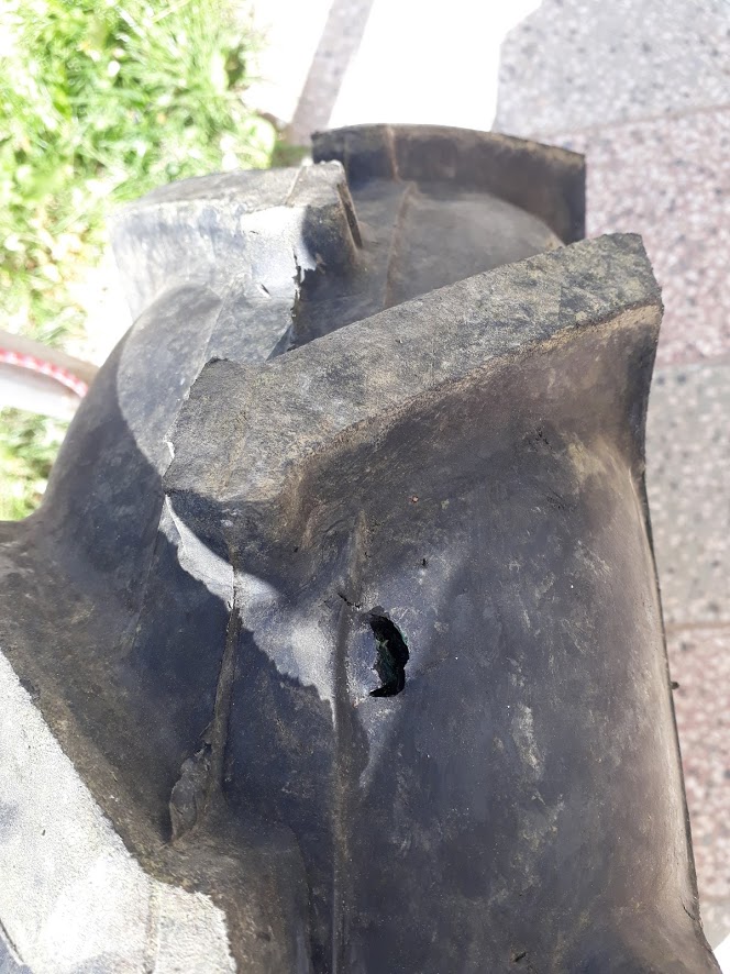

The front tire (Golden Rabbit brand from China) on my tractor got a flat as I drove it through a field where I'd just mowed some brush. At the time, I only saw some thorns stuck in the tire, which I thought was the cause. Yesterday, the tire shop repaired the tube, and now rolling the tire back to the tractor, I noticed a huge hole that I guess wasn't visible when it was deflated. I have a feeling that such a hole is going to lead to a defect sooner or later, and probably sooner, and probably can't be repaired.
So I wonder, are there 7.00-16 tires that are tubeless? The wheel is solid, so I think it could work with tubeless tires? And holes in tubeless tires can be plugged just like car tires, right? Or is it possible to also plug holes in tube-tires?
The tire says "6 ply rated" and "nylon". Maybe there is a thicker, tougher tire than these?

The tire in your photo appears to be an R1/agricultural tire. In the USA that would normally be a four-ply tire.
If money allows, I would replace tire so it does not catastrophically deflate at a critical instance.
If you must continue with it, a tire shop should be able to install a "boot" within, a tough piece of rubber/fabric cemented over the hole from the inside and bonded with heat so it stays in place. If the boot support area is decayed this is but a temporary repair. Boot is an expedient, not a cure.
I like good rubber on my vehicles, passenger vehicles, UTV and tractor. Tires are cheaper than the hospital. I replace tires "sooner" rather than "later". Equipment down time is a cost. I abhor equipment down time.
Tubeless tires are normally repaired with plugs.

If you keep mowing bush just put in a vucanized boot. It will get punctured again.
   / "6 ply rating" and big holes #4
Had a similar hole in the rear tire on my 5000. Put a boot in it. 15 years later, it's still good. Nuff said.

Yes, it is an ag tire. It is actually new. I could tell as well, having it in the car, from that "new tire smell", but there was almost no wear on it. e.g. the importer in Poland put it on. It has nylon reinforcement/belting. Is this pretty standard in ag tires? I think the boot should stick pretty well, I'll just have to ask around who does that.

The tire shop repaired the tire and never mentioned the hole? I can't answer your question about the tire ply but I do have some advice about the tire shop.

I have 6 ply R-1 front tires with inner tubes. This arrangement works for me. R-1's are probably not the ideal tire for FEL work, but they do provide great traction.

I sure would have a boot put on. It works well on the underside of the tread. They do not works so well on sidewalls (although I have limped some along for years on a sidewall). I would keep using those tires as long as you can as it sounds like you will be driving over stumps, stems and thorns for a while.
