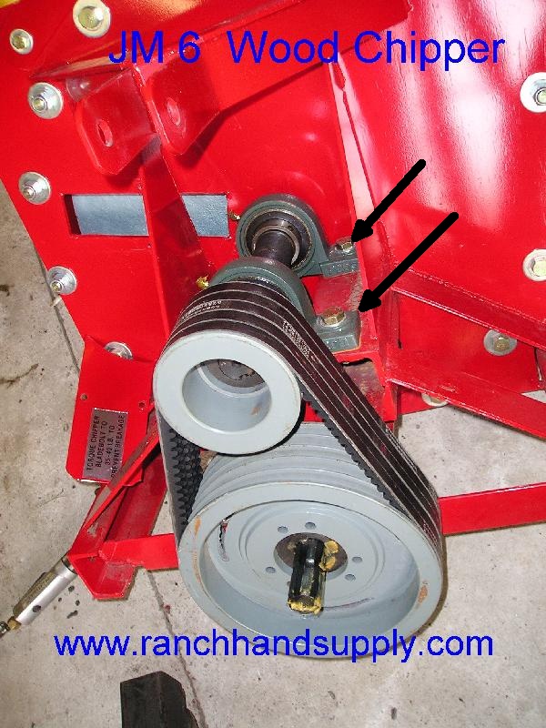

I've got a new jinma 6" pto chipper. After running about 10 hours, I noticed blades hitting cutting plate. So I adjusted cutting plate back, and after running another 10 minutes, same thing happened. Almost looks like the flywheel is moving fore and aft, although I can feel no movement. Blades still appear sharp and in good shape. I'm looking for some advice on any similar problems, and on where I can start to troubleshoot.

Mine started heading in that direction too. I think the flywheel shaft is supposed to be all the way into the bearings to a shoulder on the shaft. Set screws are then tightened, into detents on the shaft I think, [its been a long time] to keep the shaft from slipping back the other way and getting closer to the cutters like yours. Once I got mine back into position - I think I pryed against the bearing housing and pulley to move it - may have done some hammering on woodblocks placed strategicly-- I tightened the sets. I didnt trust that as being enuf, so I then worked on the pulley to get it loose on the shaft and then slid it back against the bearing and tightened it good. There is a taper collet inside the pulley that tightens on the shaft as the collet flange clamp bolts are tightened - loosen them. There are some threaded holes in the flange that you put the bolts in [use different bolts than the clamp bolts if you can find some in the leftover hardware] to press the collet out so it loosens on the shaft. Then move it, loosen the press bolts and tighten the clamp bolts forcing the collet back in, tightening evenly as it goes in. Be sure you dont run into the press bolts. When it starts to snug keep going round and round to keep them even as the collet seats tight. Ive had no further trouble.

Yep, I had that problem too. My problem was that the pillow blocks that holds the flywheel shaft were loose.
See attached photo. (thanks to Ranchhand supply for the photo.)
I tightened up the bolts and the problem went away! It's probably a good idea to check ALL the bolts in the unit.
