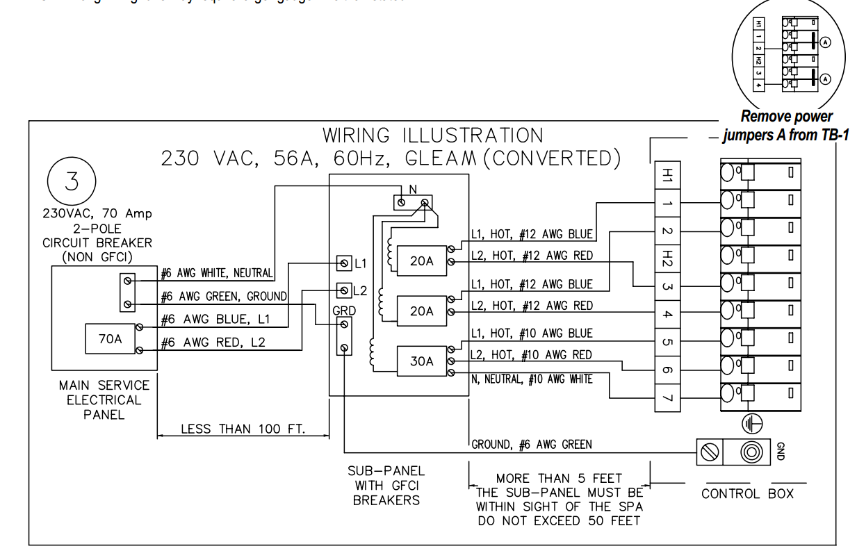

My house is pre-wired for a spa. Trouble is, that the wiring is 6/3 and behind sheetrock (of course it is). With 6/3 comes 6 gauge hot in red, 6 gauge hot in black, a 6 gauge neutral, and a bare 10 gauge ground. The installation directions (http://www.olympicho...manual_2013.pdf) for the spa indicate #6 wire for all four of these wires for wire distances of up to 100'.
I measured my wire length from my main electrical service panel to where the spa panel would be and came in at 34 feet. From http://www.calculato...es=50&x=64&y=13, it would seem that the electrical carrying ability of #10 wire is greater at this distance than #6 wire has at 100 feet since the voltage drop is half a point less with the 50 amp load I popped in there.
Am I stuck ripping open my wall or would this be a safe install as is?
Adding confusion is the following verbiage from p 14 of the install manual (when the diagram on the following page calls for #6): 'An electrical subpanel containing two GFcI breakers is included with each spa. We recommend that this subpanel be used to supply power and protect the spa. This subpanel requires a 70 amp, single phase, 230 volt, four wire service (two line, one neutral, one ground). The ground wire must never be less
than #10 AWG. use Nec 250-122 (table) and local codes for more information. A minimum #6 AWG solid copper bond wire is also required.'
The NEC table can be found at http://www.safecoelectric.com/images/resources_pdf/NEC2008 Table 250.122.pdf and indicates that #10 wire is good for up to 60 amp service (but again this is designed for 100' wire lengths).

The ground wire does not need to be full sized based on the load. Load current and voltage drop have little to do with it. The grounding conductor is there to create an effective ground-fault current path back to it's supply source to facilitate opening of the circuit breaker in a fault condition. Short circuit current and and load current are different.

Back up a bit...the instructions said the "bonding wire" needed to be #6, everything else minimum #10. We need a few "sparkies" to explain "grounding" vs. "bonding". It's confusing to me especially with that "single point grounding" change but I think it describes the wire from your main panel to its grounding source.
   / #6 Ground Wire? Spa wiring requirements
The wiring diagram on page 15 (attached in line here) contemplates the run from the main panel to the spa panel as needing to be #6 wire, but then discusses a #10 as a requirement elsewhere (where the 'converted' install isn't performed).
