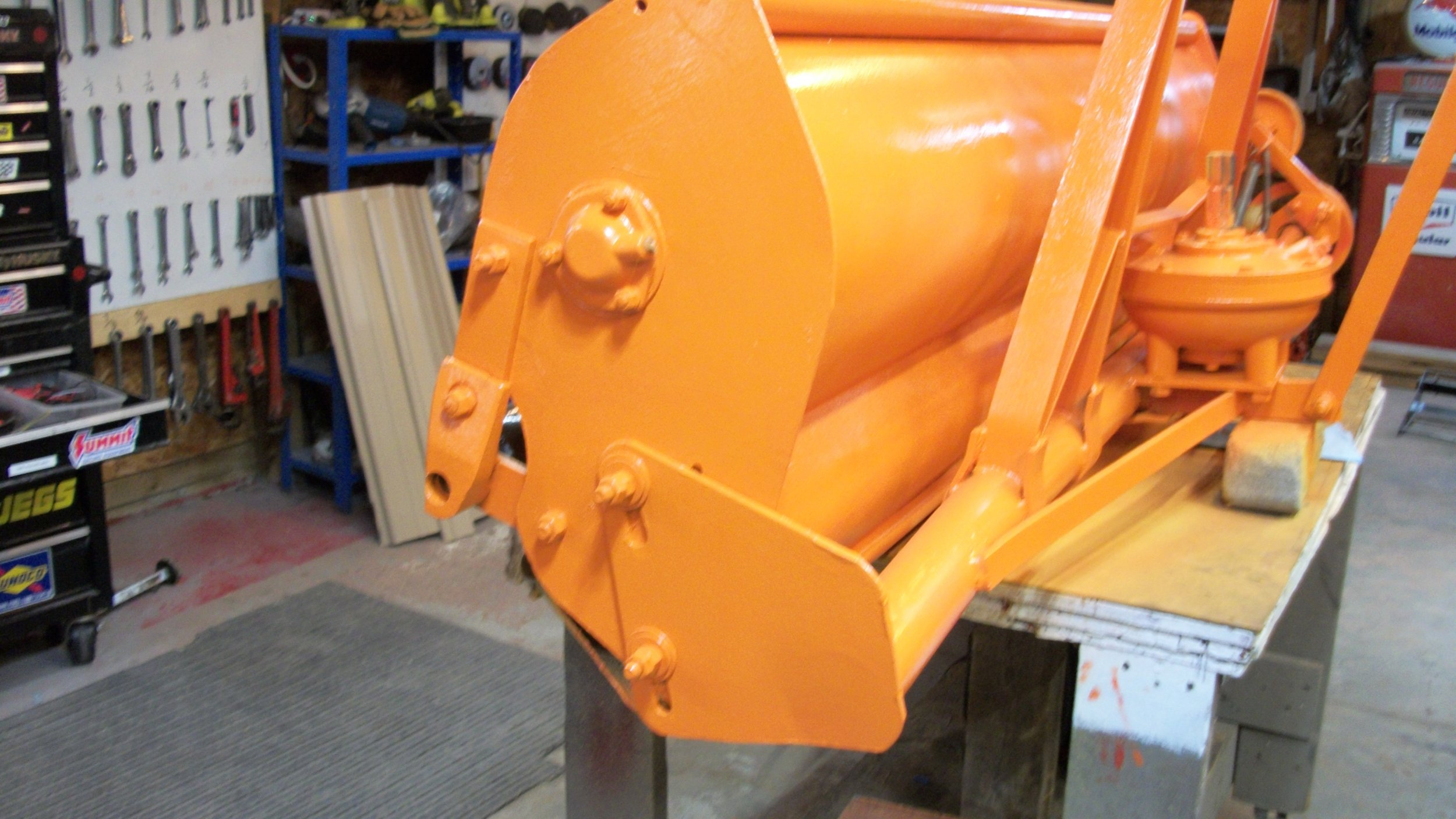

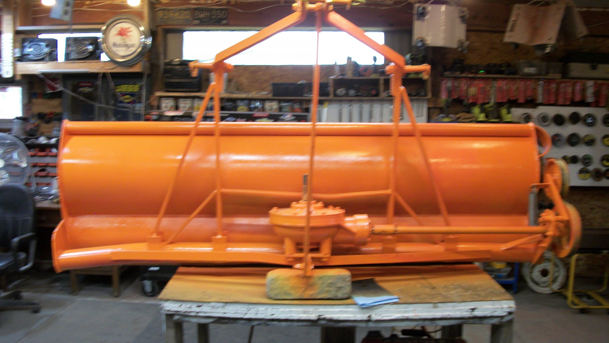

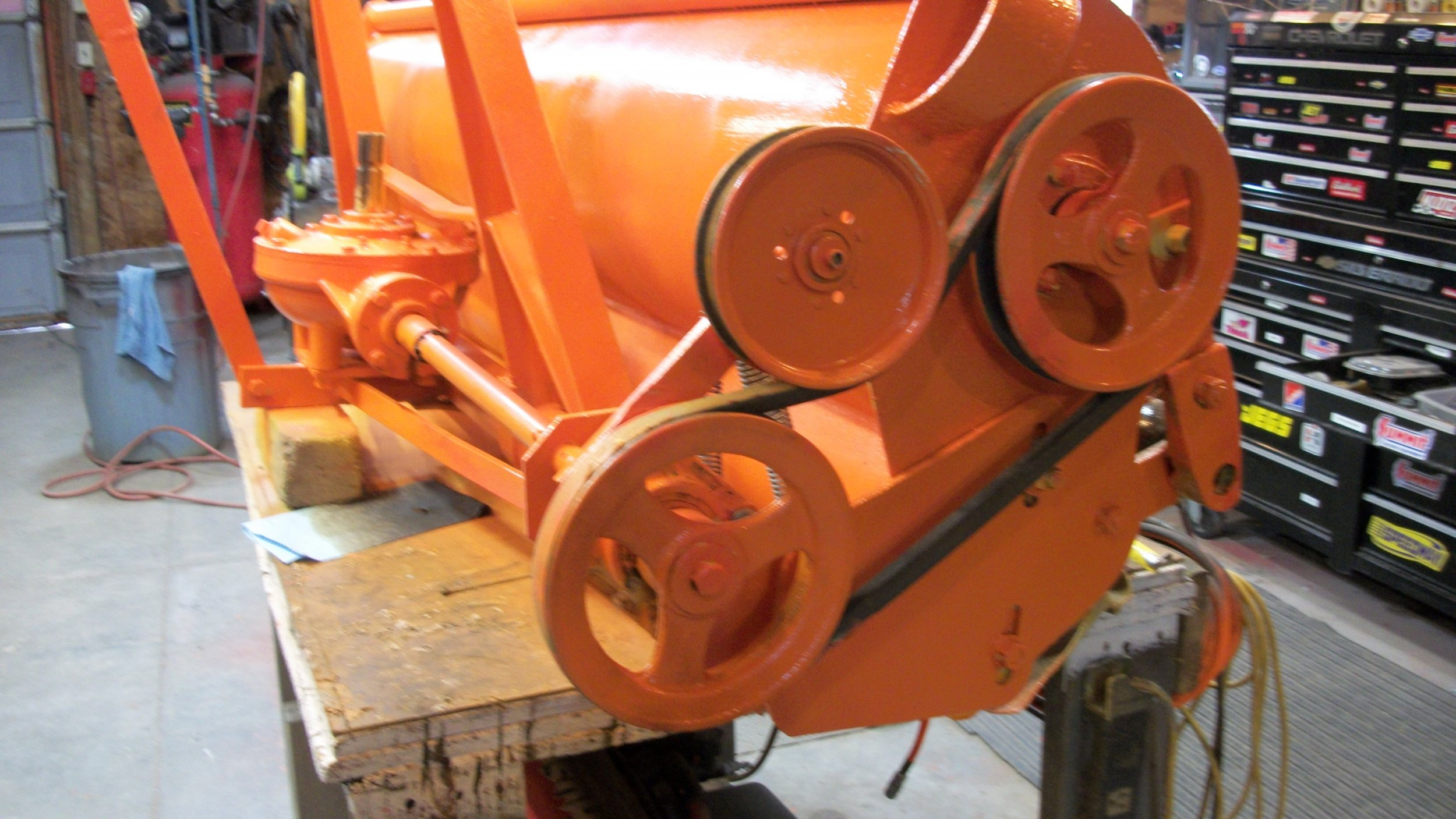

I bought a 6 foot flail mower and need to order a few parts for it ,Can not find what kind it is or a model number on it The guy I bought it from friend give it to him and he knew nothing about it, It was yellow when I got it and I power wash it and painted it . I hope someone can help me identify it by the pictures. Thank You.

I believe the flail mower you have is a Ford 917.
Where is the rear roller? You need the rear roller to adjust the cutting height.

Checked it out not a Ford 917 , But thought you was right.
   / 6 Foot Flail Mower. #4
Then it is a Mott interstater.
