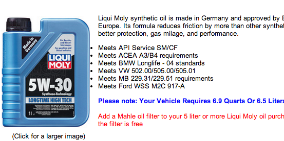

I just did my oil in the spring, so I'm good to go for a while, but having recently sold a car, I now realize I have a little stash of premium German synthetic oil (Liqui-Moly) that no longer has a purpose. It is rated for diesel (even the the car was not diesel). However it is 5W-30. I understand this is only at issue in cold weather. What would happen if I run it in the cold? Would it be under lubricated. I do not do any winter work with it, but I do mow in the cold fall days.
Advice? Should I just get rid of it, or should I save it and give it a run in the BX next year.

I would think you're fine with it at any temperature.
It would be cool if you could post a picture of the label showing the API and ACEA specifications.
The label may not have both ratings.
You will not be under lubricated at any temperature since Kubota"s factory fill is 10W30.

   / 5W-30 in a BX2200? is ok...? :)
The label may not have both ratings....

CF is an older spec.. but if your engine will take CF oil, i'd run it. Remember.. you can get syn diesel oils in 5w40 and 10w30.. that means 5 and 30 are both valid.. I'd run it myself if i had the oil. you hav ethe benefits of an energy efficient oil.. good cold pour point, reduced wear at startup.
sounds like a win win.
