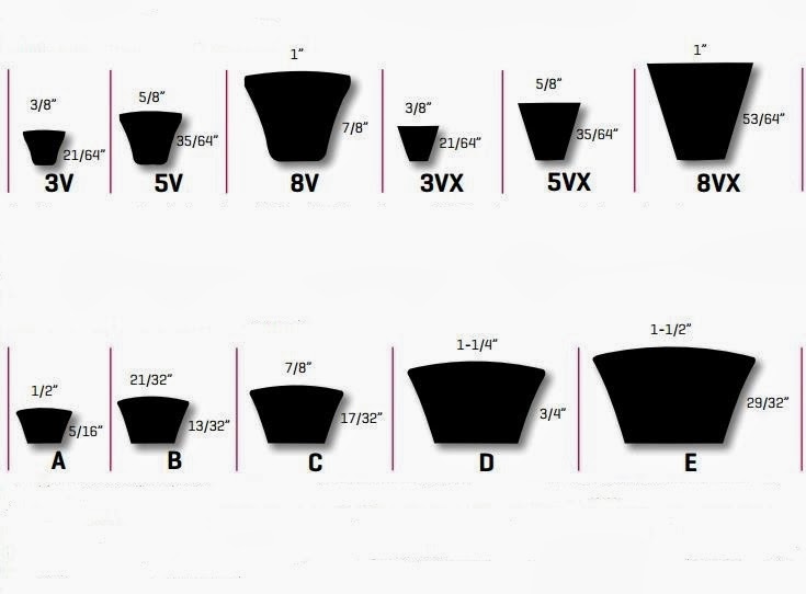

   / 5v vs B section belts. Toro mowers
as you can see here, they are not interchangeable.. View attachment 661655
Hence my question....
Why does toro use a B-section on one mower
And then turn around and use a 5v on another mower with the EXACT SAME spindle pulleys?
Take the belts off the mowers completely....and you have two identical mowers (as far as pulleys) sitting there. WHY stock two different belts? Just because someone at toro used a 5v on one and a B on the other?

all I can say is the B belt is larger, so better, but, one of the belts is the wrong size for the pulleys, and won't sit right in it!.:eek: the belt that sits perfectly in the pulleys is the correct one!..

It isn't so much as belt width as it is cut angle, and how it sits in the groove. too low and it will bottom out and not get any grip. But if the cut angle is the same between the two styles of belts they will sit at different heights in the pulley groove, but will still work.
Not sure I understand this one?
Yes, a B is technically wider @ .69" vs .62 for the 5v...
But all the power charts rate a 5v belt as able to carry more HP
   / 5v vs B section belts. Toro mowers #8
it's possible if the 5v belt is deeper, and has more contact area. I didn't see specs on the depth(height)..
#9
Depth was on the chart YOU posted.
