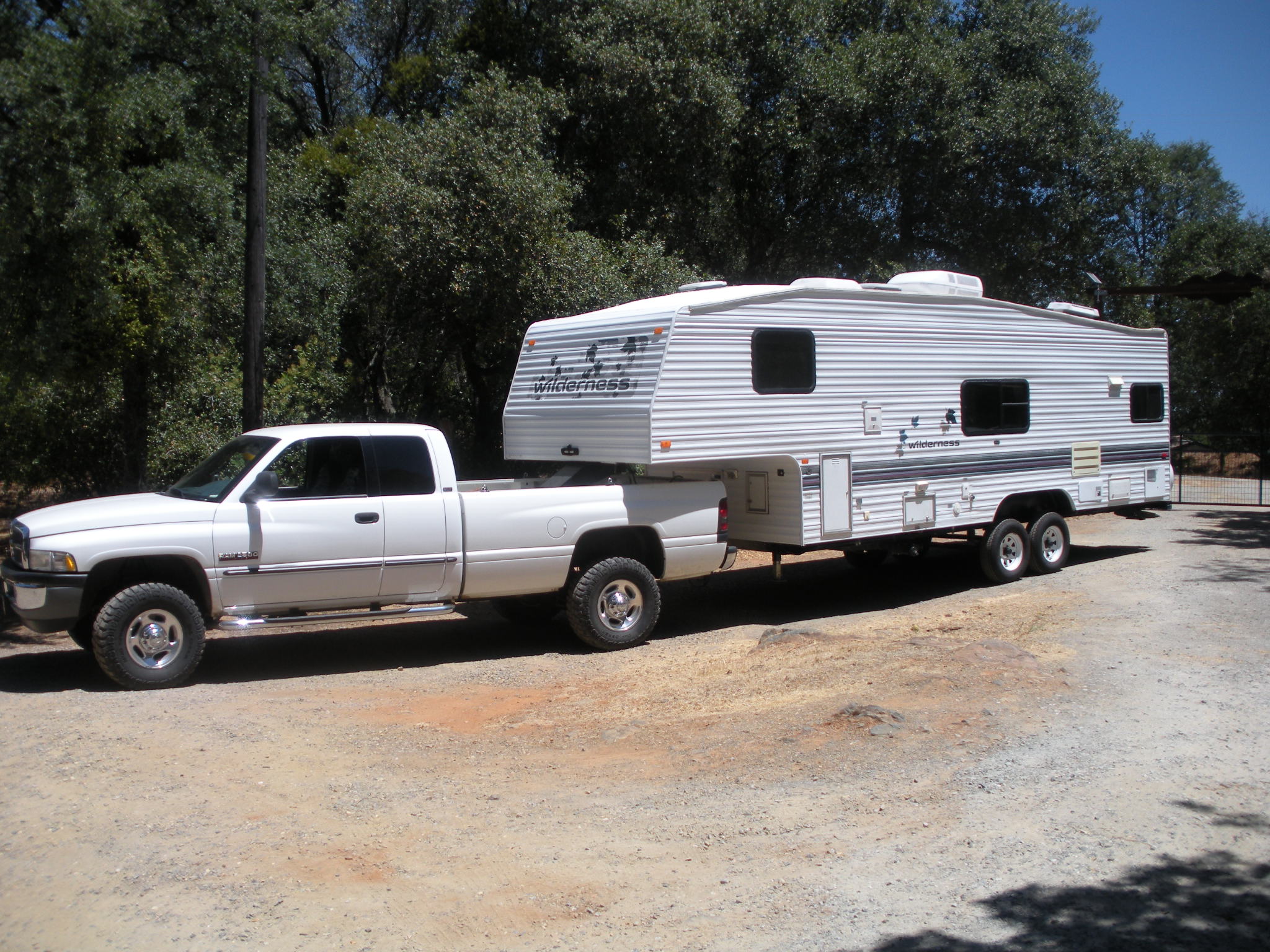

This is one of the only pictures I have... From when we first got it. I'll try to get more today of the AC unit, but it is raining...
